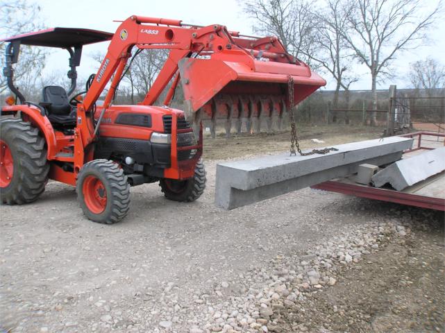

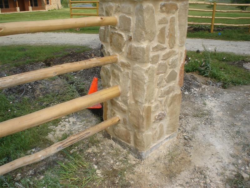

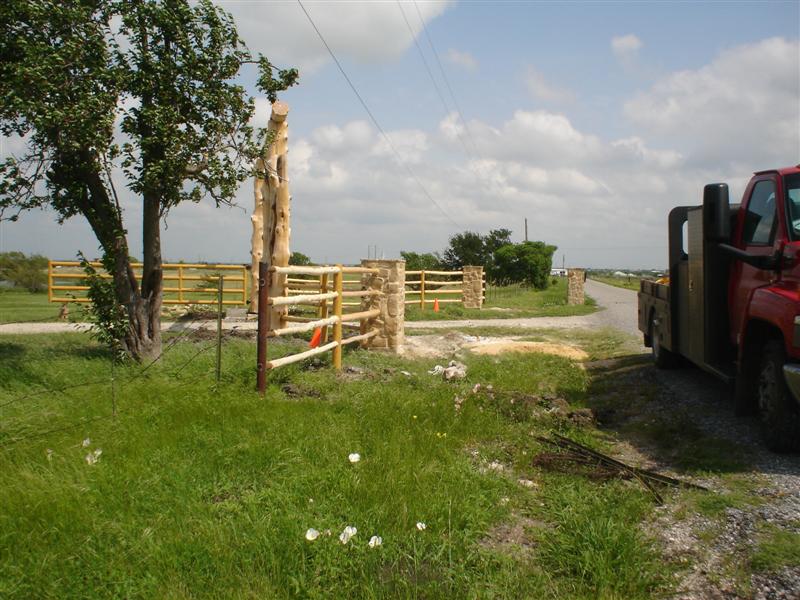

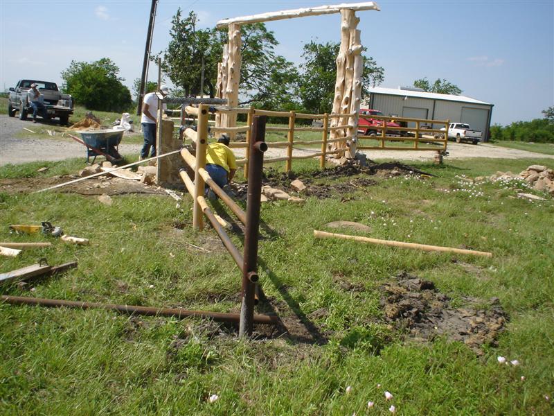

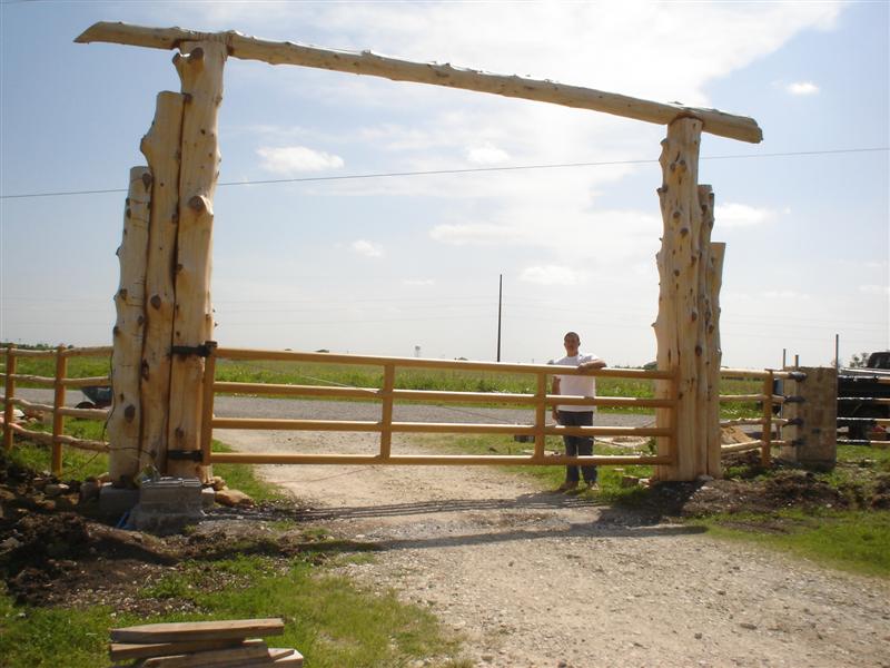

As of right now it looks like we'll hookemup and haul the toy hauler, dog, cat, and tools for Lee County Monday a.m. the twelfth of May. We'll be there a week and have a ton of fun. When we're done Karen will be able to hit a button and the gate will open and close on command. Did I mention we were going to have fun?

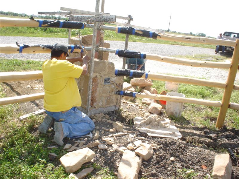

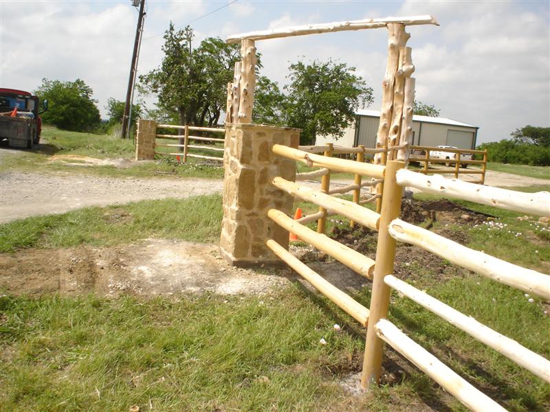

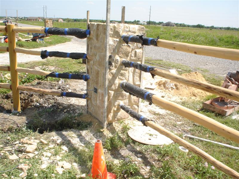

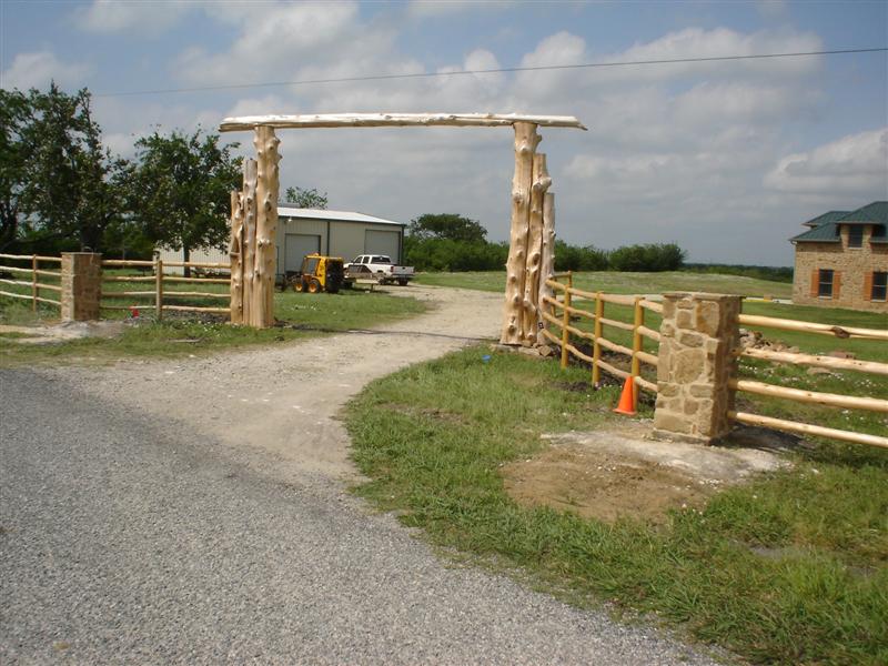

Today the masons showed up got most of the column work done.

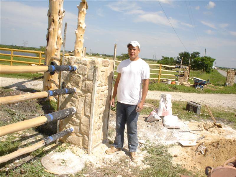

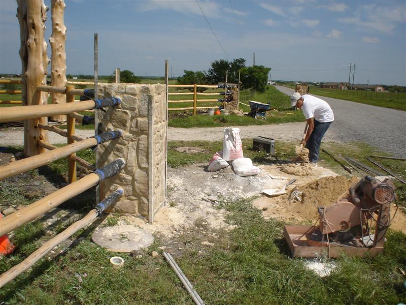

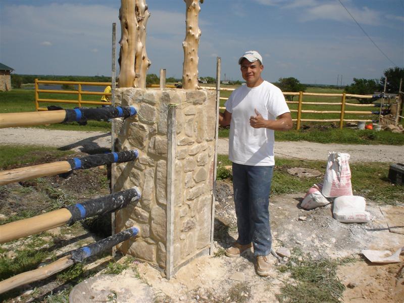

There's something special about a soldier. I don't know if it's the been one knows one or if it's the measured look you get when you meet one. Whatever, but the only thing that will make an old one happier than meeting another old one is an old one meeting a young one.
The mason's son is starting college after fulfilling his military committment. I knew something was up when the boom box was playing hip hop instead of marachi when it was turned on and then up.
He'll make a good mason, heck, he'll make a good anything he wants to be.

Harvey the columns really make the fence look substantial and ties in the weight of the large cedars.

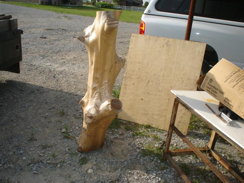

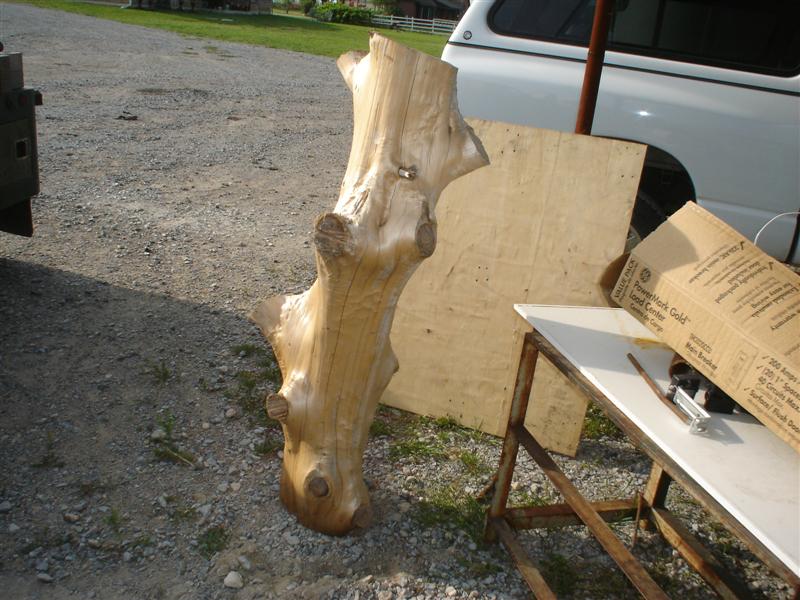

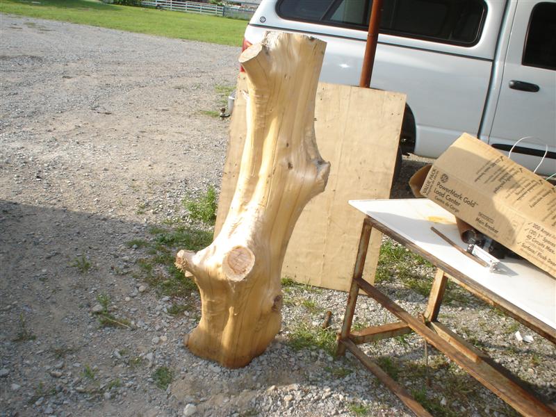

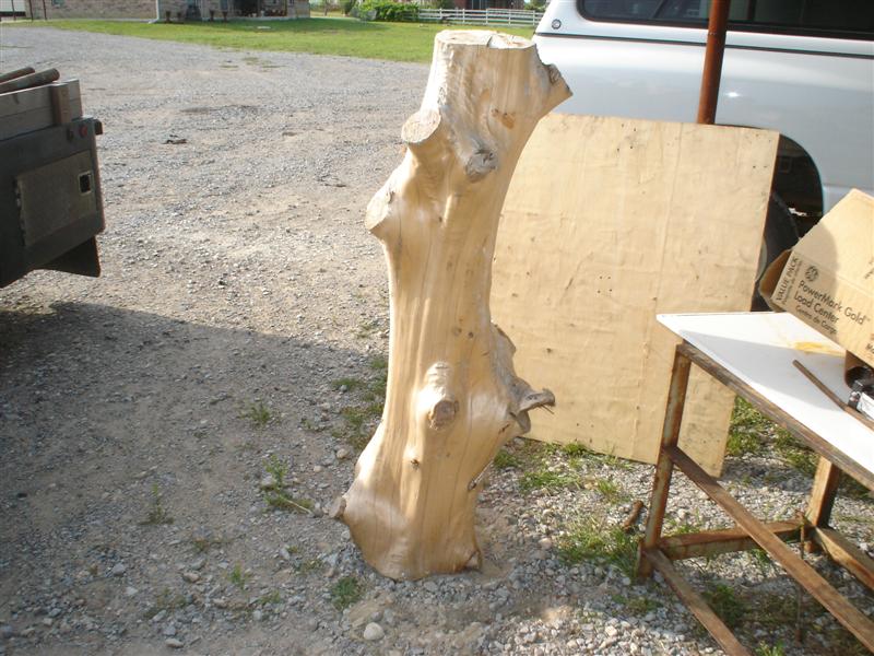

Sometimes you get hooked on an idea. This log got me. She just screamed she wanted to be the key pad holder for the big timber gate.

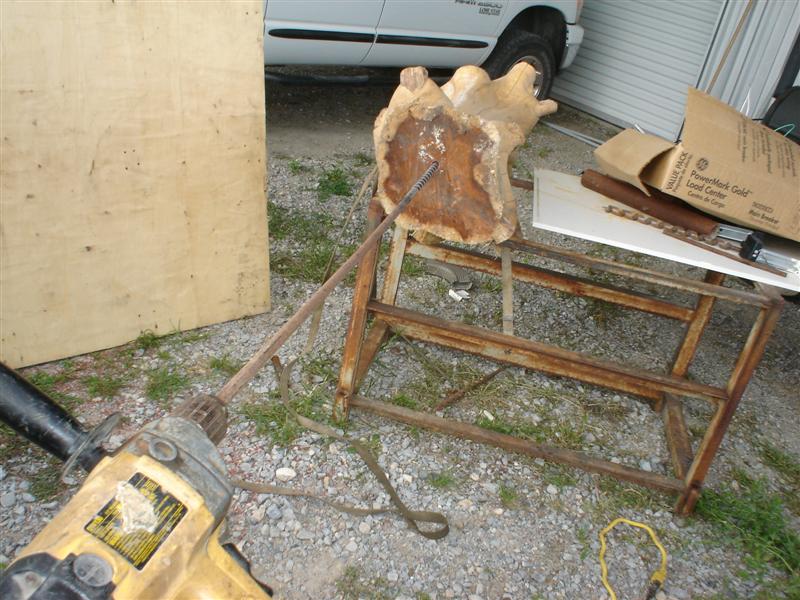

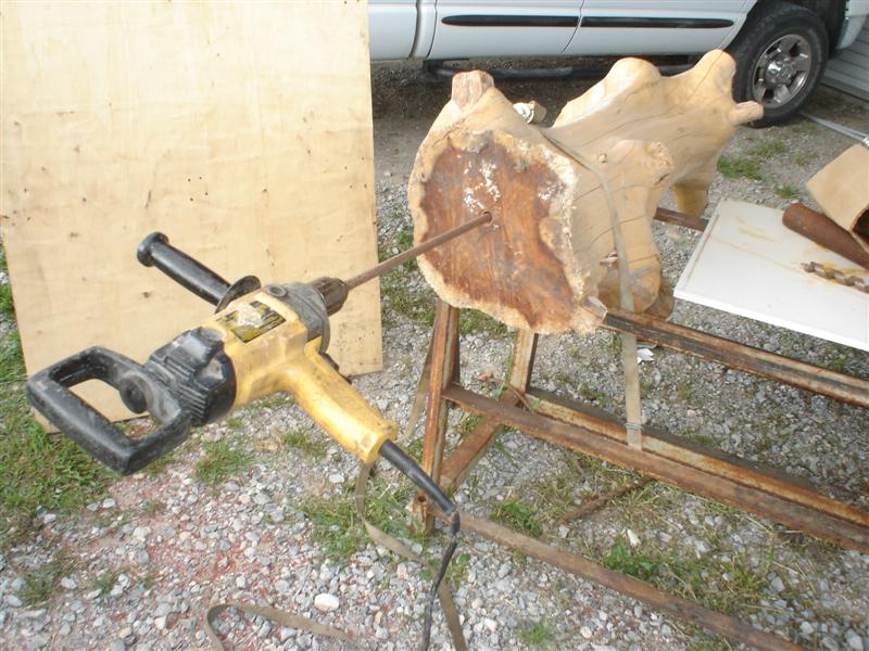

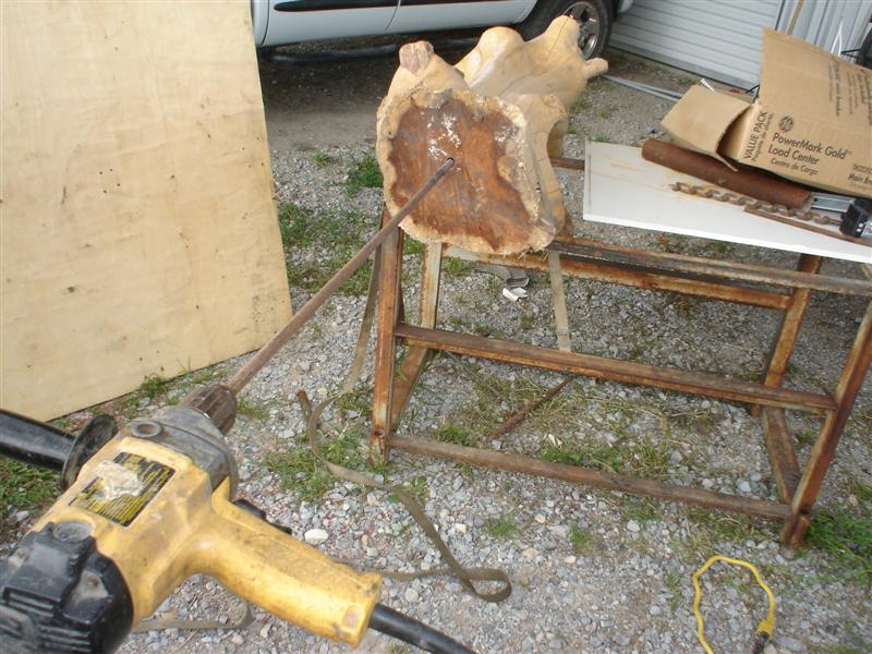

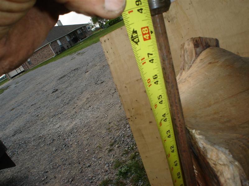

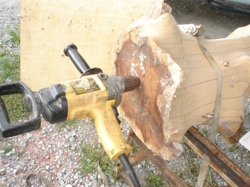

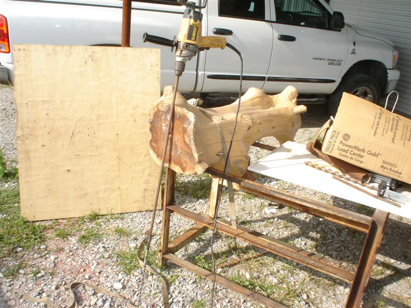

Of course the hiccup in the getup is she needed plumbing. You know, plumbing, electrical plumbing.
I needed a three quarter on an inch hole from what she sits on to about forty five inches above grade. That's where the key pad will sit and I need an eight conductor wire to the key pad. I don't want the wiring to show. So all I had to do was drill a three quarter inch hole about four feet long bottomside up.
Nothing but a thing.

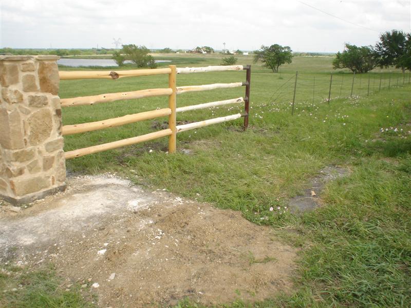

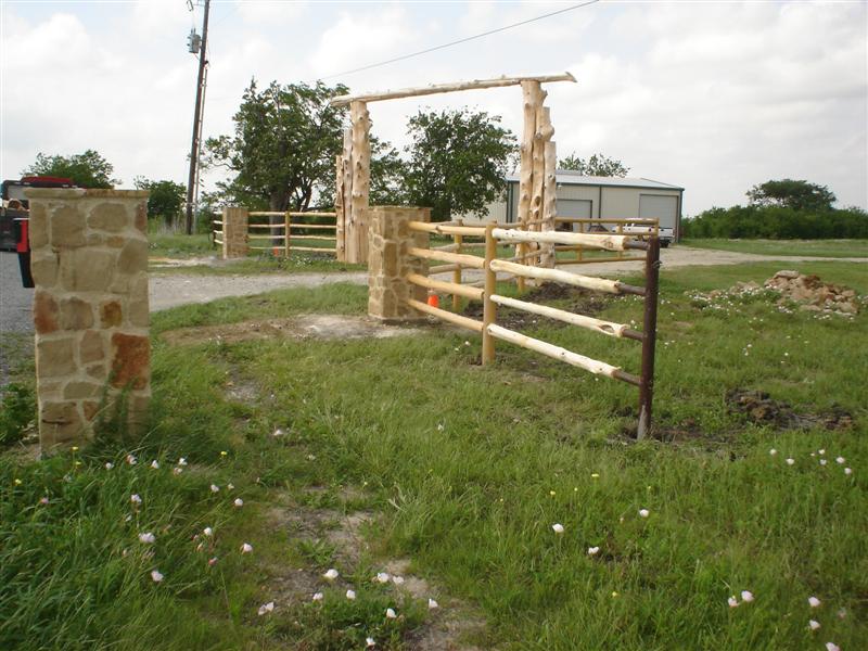

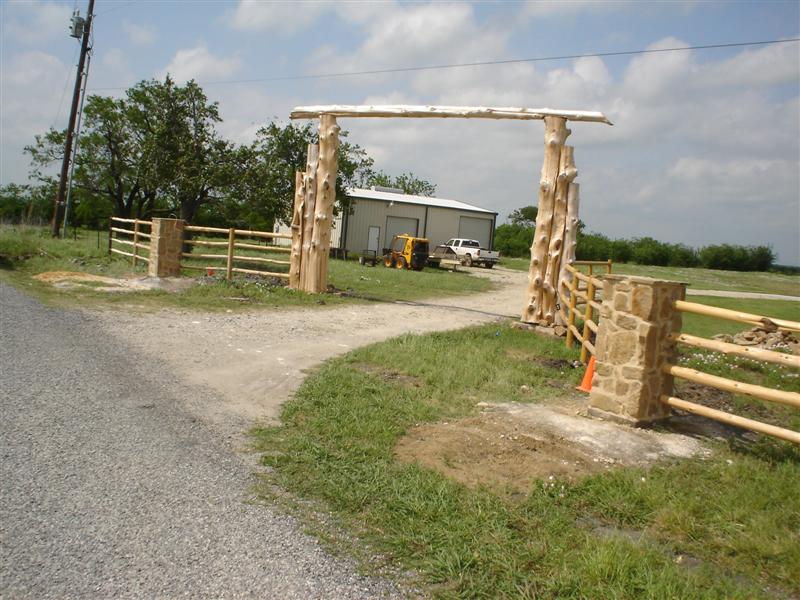

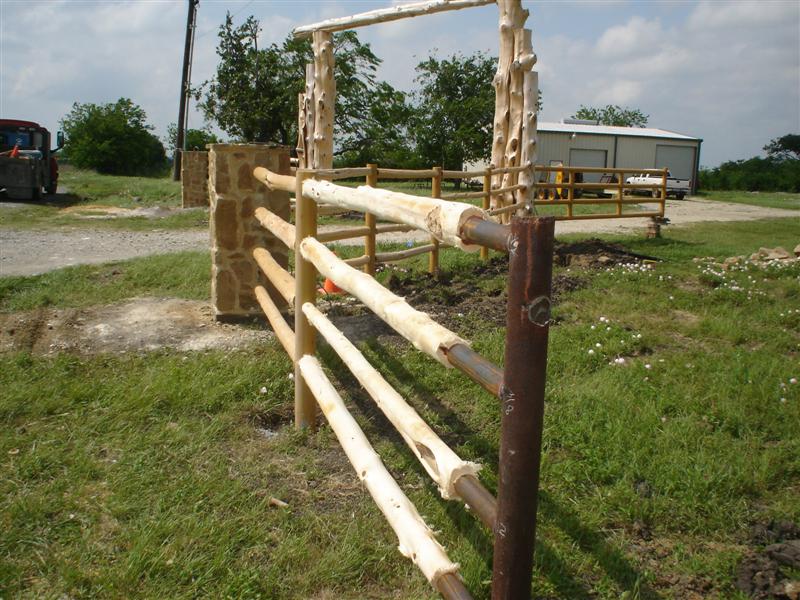

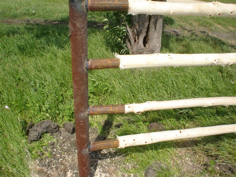

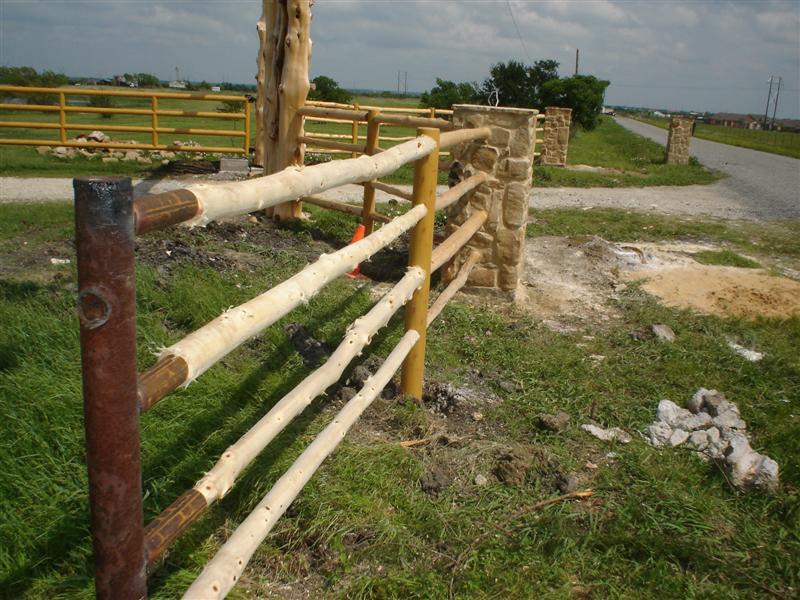

It's coming together a little more each day. The masons are done with the columns and I finished the transition panels from the new fence to the old barbwire and t post fenc.

Harvey: That entranceway is rapidly changing from a project to a statement. The statement is, "Hey, let's see you top this!" That is one beautiful piece of work.
