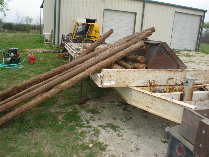

I've been working on this, that and the other. Yesterday I power washed the cedar logs Glenda and me pulled from the woods last Sunday. They're going to be the rails between the metal posts I custom made for the job and then had powder coated to match the gate.

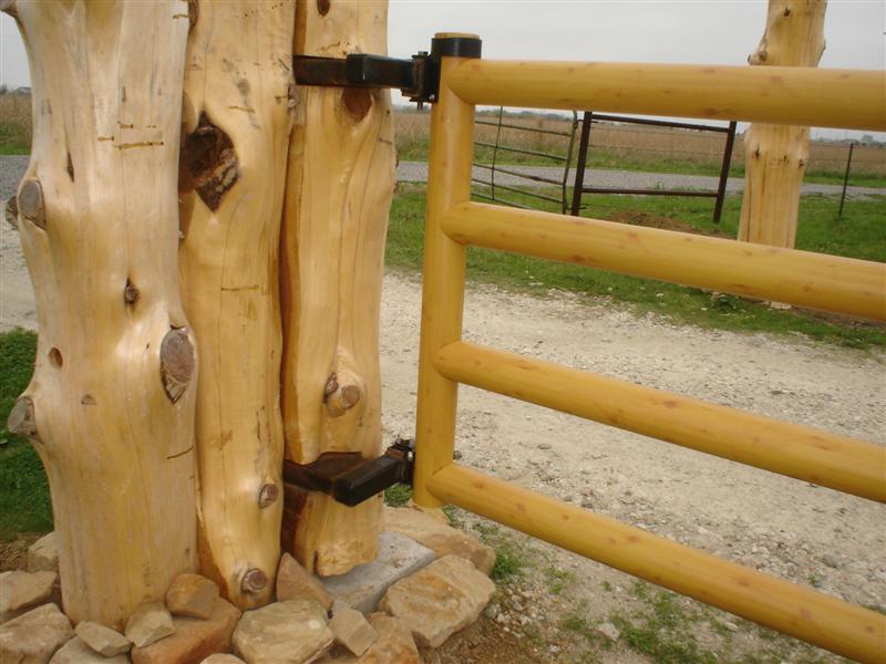

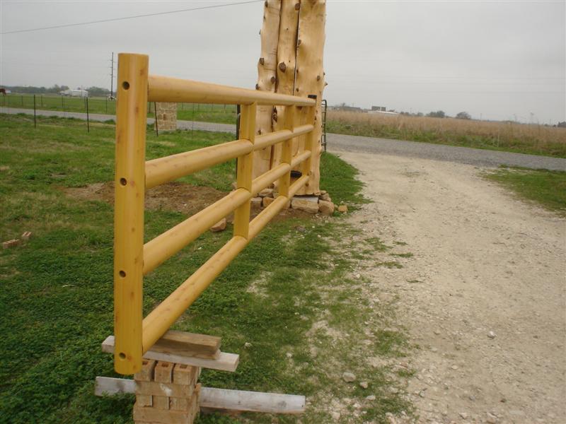

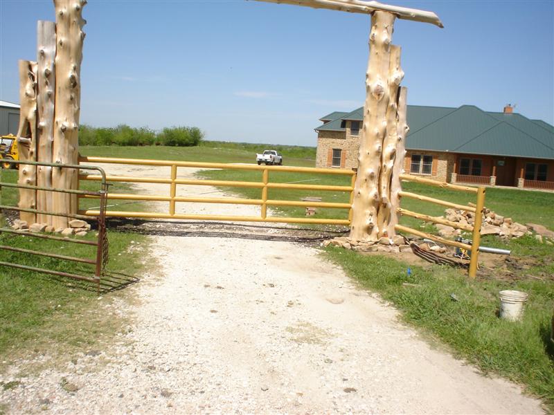

I gotta ask..... in your second pic, end view of your gate, is that a socket head bolt I see in there??? Just wondering why you didnt use stainless ?
BTW very nice lookin gate !!!
/ This, that, and the other
#303
scott_vt said:
Mornin Harv,
Those bolts will be covered with wood plugs.
There are ten bolts holding that gate together. Two come in from the bottom rail through the middle supports into the top rail. Then there are eight socket head bolts coming in from the ends.
I'm worried about over time the natural flex of the gate causing a weld failure. The last thing I want to have to do is have a piece taken back down to bare metal after a welding repair to be repowder coated. So I'm building a truss that will remove that worry.

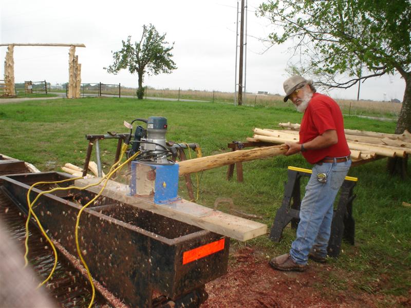

The road trip didn't happen. Glenda had some minor surgery Thursday morning and she's still in recovery. She's doing great. It was a painful procedure though and she's still sore.

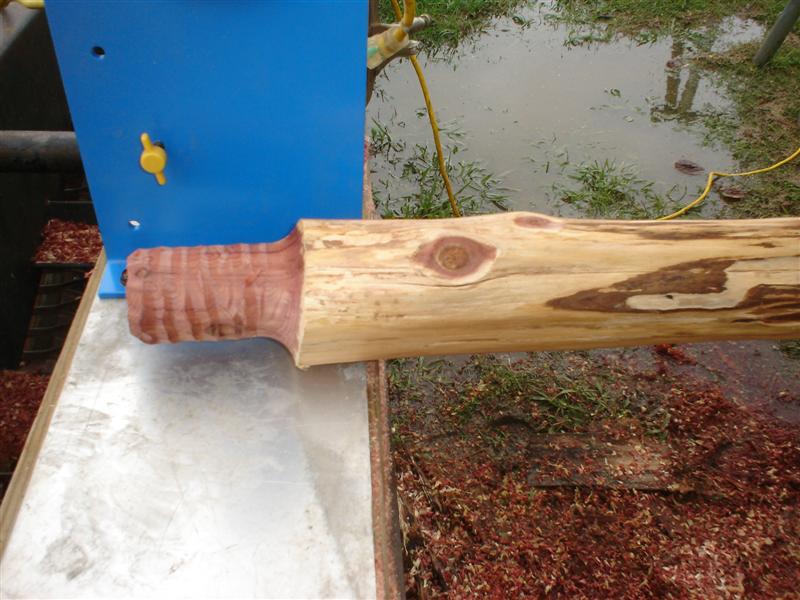

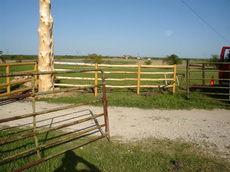

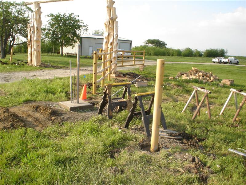

I've been working on the big cedar entryway between other jobs etc.

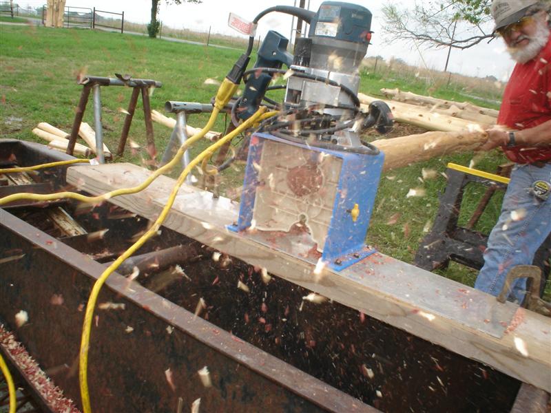

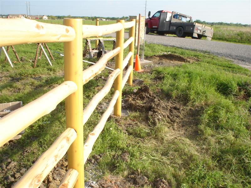

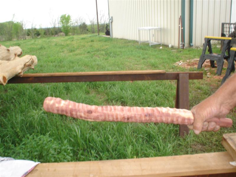

We had to tenon the fence rails.

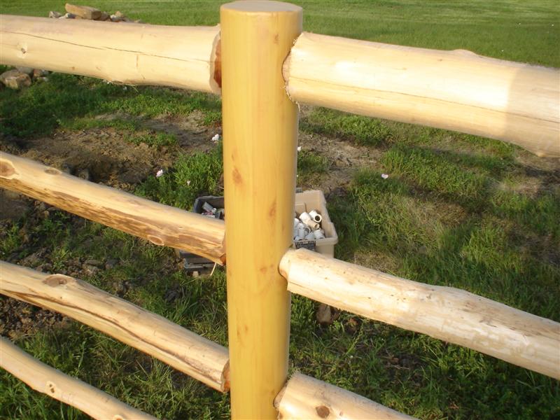

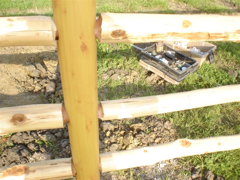

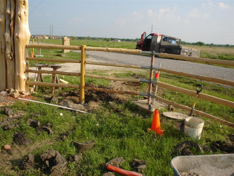

That's because we want this kind of fit up with the metal posts.

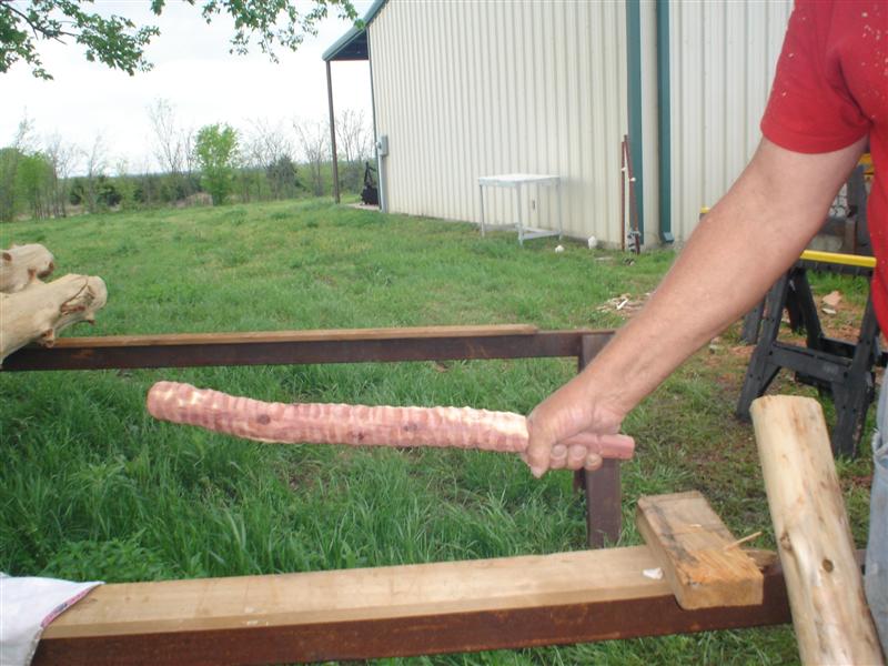

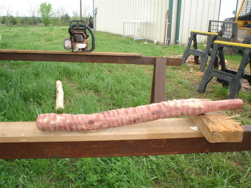

The first day doing the tenons I practiced on a teacher's aid. I call it the "learning curve".

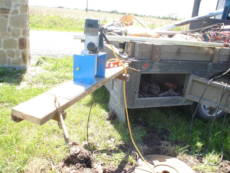

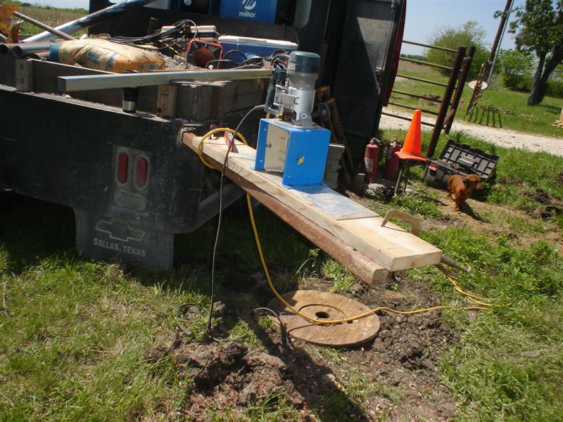

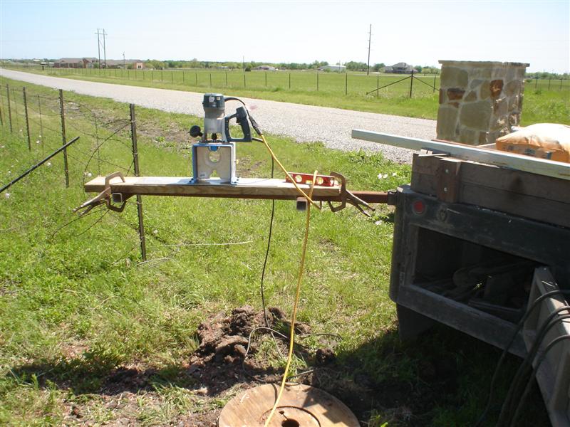

The other day I set up the work at the entryway. I had power we'd brought in for the operator handy so I used it for power and I made a work bench for the tenoning tool on the truck.

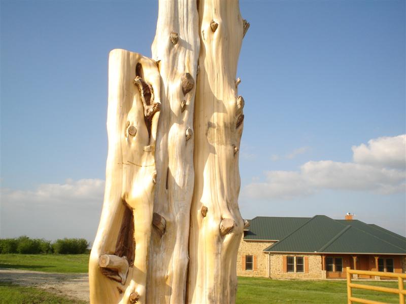

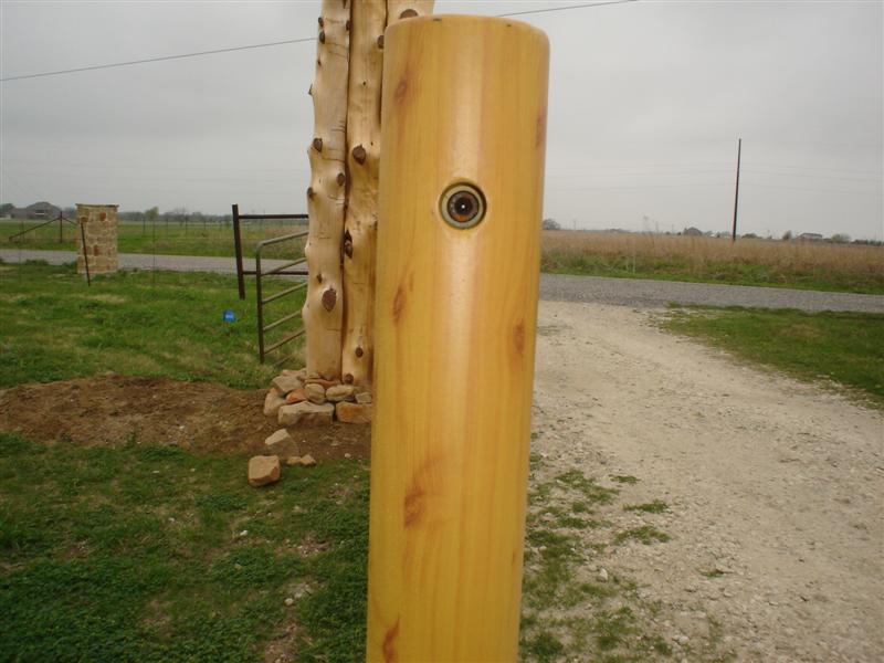

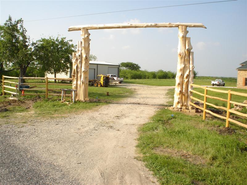

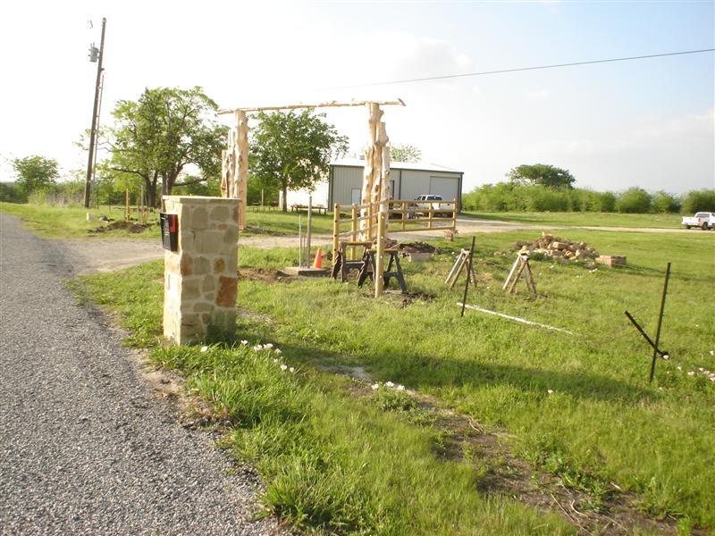

In the first picture I want you to see two things. One of course is the column at the corner will match the mailbox.
The other thing in the first picture is the last post of the overhead. If you look close you can see a cave.
Second picture will be a close up of the cave. I think we need a ceramic raccoon or owl for the cave, right?

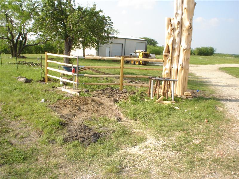

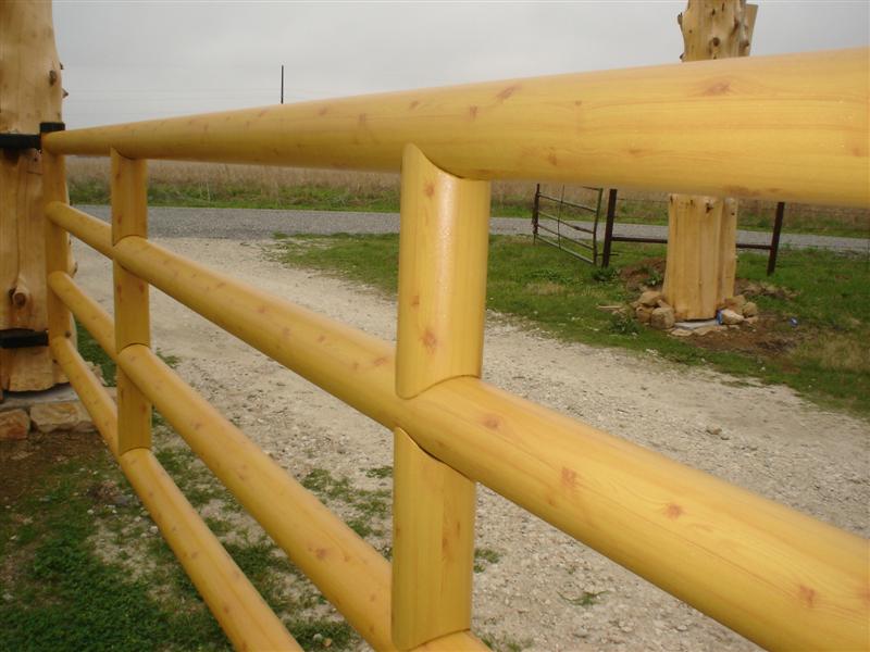

One of the interesting things about this project is the rock columns. Originally it was just going to be rock columns where the entryway meets the existing fence line. Then it was lit rock columns. And now it is lit rock columns with outlets for, well, whatever.
I don't do rock columns. And I don't want those who do rock columns in control of my fence rails.
So this is how I handled that.

I don't understand Harvey. Ron Hall and I installed a gate this last weekend and I posted pictures of it, but nobody seems to be as interested in our gate as they are yours. Don't you think ours is a work of art? :p :rolleyes:
I would love to run that tenon making gig. Did it only take one sharp router blade to complete all the fence rails? Did you make that rig or find it somewhere?
