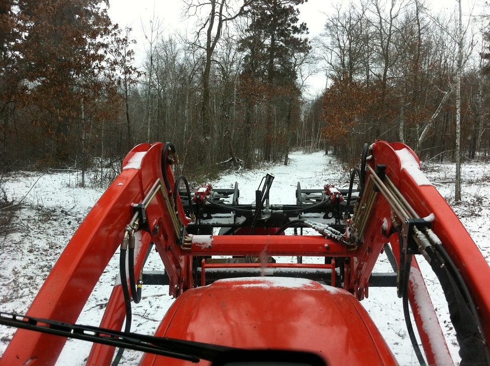

When on the ground, I cannot see any of the standard SSQA plate without obnoxious leaning and head bobbing.
   / The WICKED Root & Debris GRAPPLE!!!!!!! #2,144
This is pretty much the view I have of my SSQA from my seat.

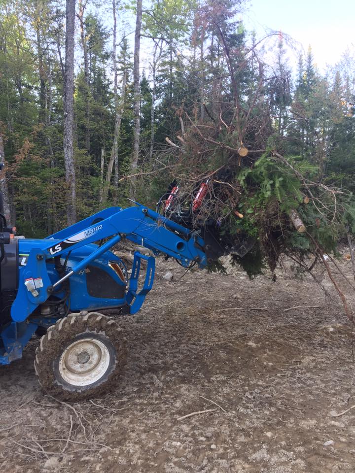

Since we're talking about grapples, I have a minor design change on the lids that comes from my experience of ripping smaller poplar stumps out of the ground. Consider the pinching action between the lower tangs and the upper lids. Currently the upper lids are radiused for larger material. That radius allows handling larger material like in the photo below.

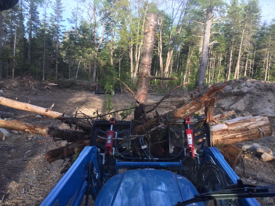

But the larger radius is unnecessary for nabbing even larger stumps out of the ground like in the following photo:
The improvement I can see from my own use is that if the grapple lids had a shallower radius, then better grip could be had on smaller material such as ripping 3-5" poplar stumps straight up out of the ground and this without sacrificing material handling capabilities on larger material.

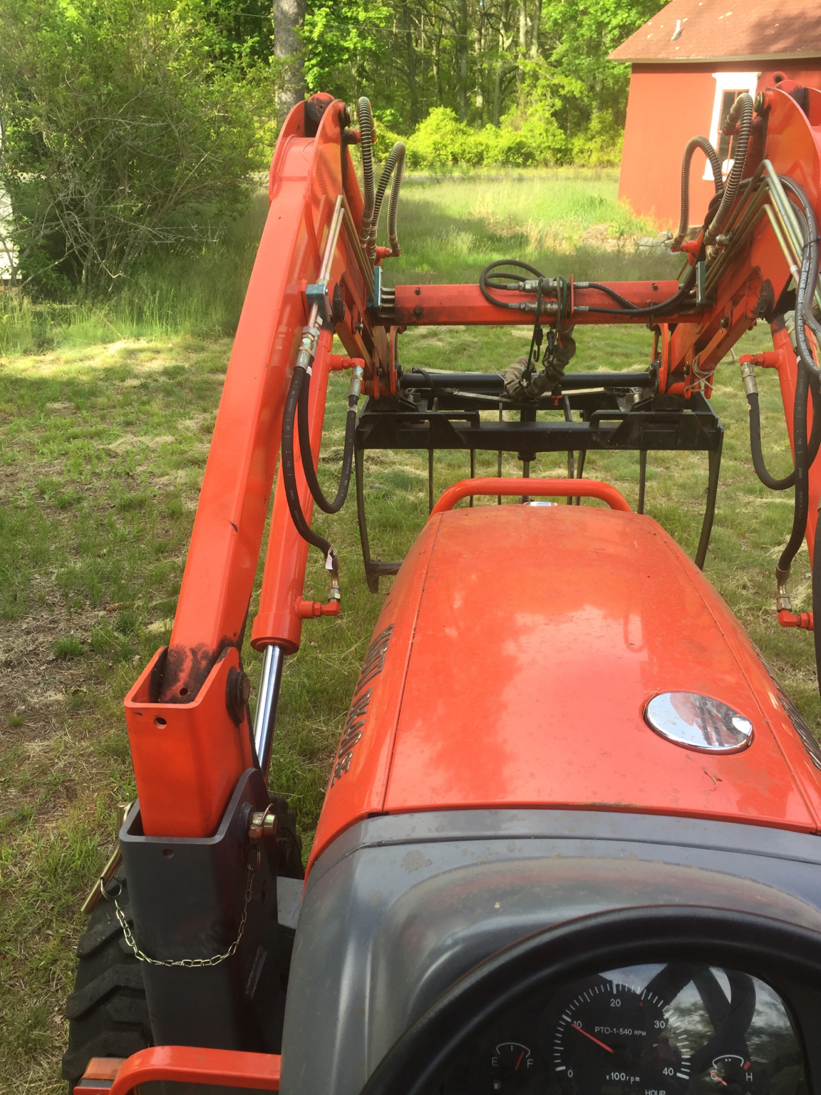

I can see the edge and tip of my 48" grapple by looking down between the hood and the FEL arm. That's with tips pointed down as if to dig. IMG_0376.JPG
Cannot see tip of middle unless grapple is straight forward and flat on ground.
Operator height might have something to do with forward view but side view is easy.
