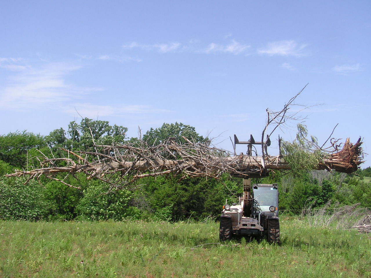

I use my 44" wide (smaller than IslandTractor's grapple), for long heavy stuff:
For reference, the V417 is 6' wide.

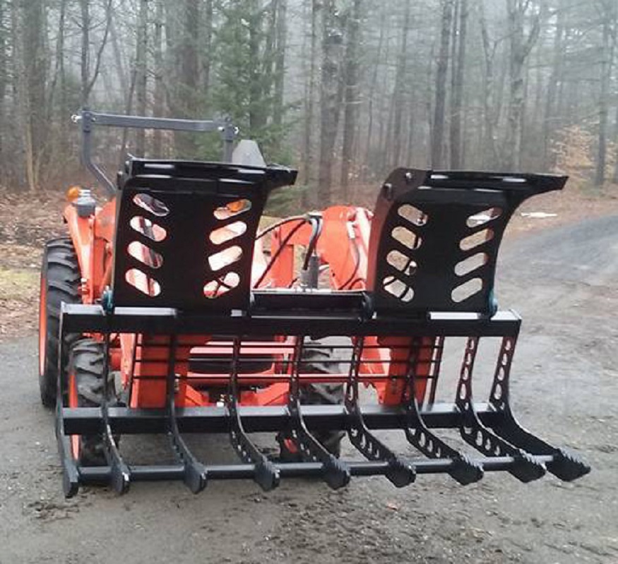

It is more than that: I literally cannot see the center of my grapple and so a wider grapple gives me visibility.
A skid steer, track steer tele handler, or wheel loader the operator can see the center of the grapple when it is on the ground, but i cannot. I can only see the edges of the grapple. This matters when I'm grabbling stumps and need a reference point so I know/guess/pretty much know what my unseen middle part of grapple is up to.
   / The WICKED Root & Debris GRAPPLE!!!!!!! #2,137
I'll have a look this weekend. I do lots of stump grappling and have never had an issue seeing where the tip of the grapple is. I can certainly see the tip when in "neutral" position on the ground. Maybe we have different techniques. I don't "dump" the grapple before clamping on to a stump. I line up the grapple flat on the ground with the stump ahead, then tip the grapple down (I can easily see this) and then drive forward to ram the grapple under the stump and wedge it up. I probably cannot see the tips when fully "dumped" but I'm not sure. I'm curious now so I'll see if I can get some photos this weekend.
One other thought: Do you have a full SSQA plate on your grapple? If you look at the photo in my avatar you'll see that I have two partial plates. That allows me to see right through the center of the SSQA plate area to visualize where the grapple tips are. Never occurred to me that some grapples might have that critical view blocked.
#2,138
Wicked Grapples are pretty transparent!
Travis
