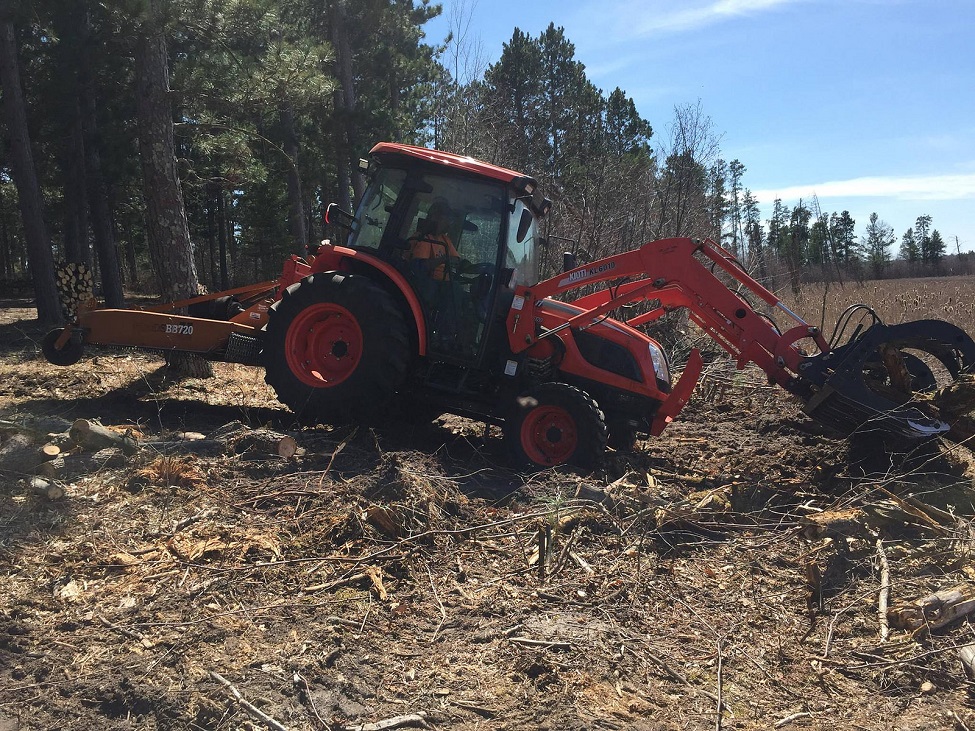

(Sound of hand slapping forehead.) I just had an epiphany why less is more.
One of the main things we like to do with the Wicked Root Grapple is uproot Youpon. To do that we normally use the corner of the grapple. With a wide grapple, that puts a lot of twisting strain on the FEL and the whole tractor, sometimes lifting the opposite rear wheel off the ground. If the grapple was only as wide as the FEL, that would deliver the power to the root ball with less stress on the rig.
Insert visual courtesy of Eric & his famous NX6010 with the 72" Wicked Grapple.
IslandTractor is right.
Think about the extremely powerful excavators used in construction demolition. You'll never see even a 4 foot wide grapple on them. Most are 3ft wide. Why? Three basic reasons. 1) That's all they need to work efficiently, 2) A wider grapple would be less selective and make picking up specific items like a stump more challenging, and 3) A wider grapple increases risks of tipping over the excavator. #3 is a real concern when you have an excavator with a lift capacity of more than 30,000 lbs and you consider what happens when you apply that lift while the outboard edge of the grapple is unknowingly snagged on an object that won't move. It would get exciting real fast. The power of the excavator would tip the machine over. By using narrow grapples, that won't happen as easily as the load is centered.
CUTs aren't likely to tip over but the sort of twisting forces demonstrated in Eric's photo are not great for the tractor or FEL. Narrow grapples make that type of scenario less likely to occur.

Look at Eric's photo. The issue is certainly relevant to tractors. Not for tipping over catastrophically but for putting strain and twisting forces on the loader. All loads should be centered. A wide grapple makes that more difficult to control especially when digging roots or other activities where one edge of the grapple might snag an immovable object.
And, tractors with grapples don't typically do bulldozing type work. Tractor FELs are designed and manufactured to LIFT not push. If you want to push you use short stubby arms that don't flex. Tractor FELs are loaders. Grapples are used to root out brush, lift logs and rocks and debris. They shouldn't be used to simply plow forward like a dozer. They simply aren't built to do that. And, if you are going to do that it is all the more reason NOT to use a wide grapple that might snag a stump on one side and suddenly stop the tractor cold. Do you really think it would be a good idea to ram your standard 72inch bucket edge into a tree stump at 3-4mph???
