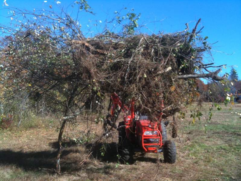

You and I have the same loader. I have a 48" grapple and can see very well where the edges of the grapple are. Directly in front of the SSQA plate and unobscured by the FEL arms. The grapple is easily seen in front of the tractor, I don't need to look around any obstacles or lean out. In fact, the edges of my grapple are directly in front of my eyes and directly in front of the FEL arm. I can see the edge from inside the FEL arms, I don't need to lean over to see outside. A six foot grapple will have the edge a foot outboard and obscured often by the FEL arm. Do the geometry and tell me who can see the tips of the outboard grapple tine more easily.
Wider grapple really doesn't add much to the capacity for brush. Look at the photos below of brush and trees in a puny 48" grapple. I can get in more brush and trees into a 48" with 42" jaw opening than someone with a wider grapple but only 37" jaw. Brush is sticky. It's all about how big your bite is not how wide. (And, notice that one of those photos is a puny little CK20 with the same grapple).
