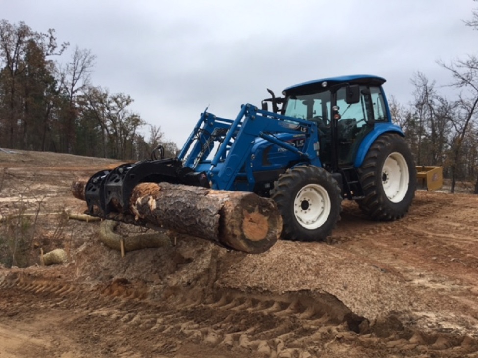

I got some flat face couplers that supposedly allow connection under some pressure. We'll see if they actually work- I've yet to detach the grapple.
Another option some people have used is to make a tee with a coupler on either side and a valve on the middle. You connect the grapple's connectors to the tee and open the valve to let some oil out if there's pressure build up.
I wanted flat face because they lose less oil when uncoupling but what I didn't expect is that compared to standard ag couplers of the same size they're huge. Larger diameter and longer as well. I didn't need 1/2" for flow but that size is cheaper than 3/8.
/ The WICKED Root & Debris GRAPPLE!!!!!!! #3,002
If you remove your grapple, for instance, and it’s cool but, you store it in the sun, internal pressure goes up. No matter how you do it, the pressure has to be relieved before you can make a hookup.
I’ve had good results storing my grapple, post/ tree puller, etc. under roof. When removing my grapple I close the grapple lid(s), shut off engine, turn ignition to run, cycle the 3rd function switch a couple of times to relieve any residual pressure, then disconnect hoses.

Not quite. Ted said if it is detached correctly (assume as he described) there will never be a problem. What he did not account for is thermal expansion. If you decouple in cold weather and try to recouple in hot weather, the pressure will have built up. An earlier post mentioned storing under cover which prevents heating in the sunshine. This will lessen the pressure at least.

Nope Bill, thermal expansion is thermal expansion. Has nothing to do with the QD’s. You have to either let the hydraulic circuit cool or .....burp the QD. Not a big issue. My 100 hp 3rd function is flat face QD’s.
/ The WICKED Root & Debris GRAPPLE!!!!!!! #3,010

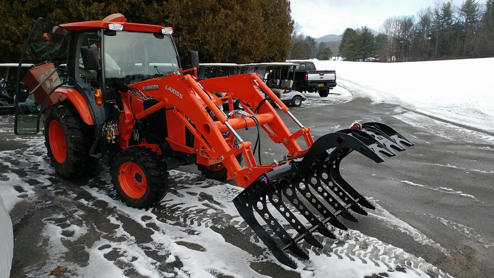

Kill two birds with one stone. Get one of these handy coupling clamps available at Tractor Supply.
Switch the male from the tractor to the female on the Wicked. Mark the hoses so the same ones always connect. Attach the clamp to the FEL.
It makes coupling and uncoupling so easy. You feel like you have three hands and never need worry about thermal expansion. You can effortlessly burp both sides of the cylinder if need be.
Use rubber plugs when the Wicked is not attached. We cut the strings off ours and when not in use plug them together and keep them in the tool box on the side of the tractor. Keeps the plugs clean that way.
Here is ours held onto the tractor with zip ties and the hoses are identified with zip ties.
flDDgfHWKbpxIIZ1762fAmeEzct8K_PzauBkZRkCVxvgWYtZBU4f-6VeYcdbBYzXtiRAlqaivhGi9tHgVw5oL5bEb4gwJ2v7e-HlEajuBhfr28zTDm3x9NMoOdSLVfasVjT3_FiPSL7EioUmLdxihhM_C1vTmjvErQIiA5fv-k6Vkrionezu4XYXn_BQ0RnJiL1TIIVkEtI1oORiTmHRDM4ZbGWZSgJ2YUbyKoIekv9MtjwMSB2xc0c-Pb4LiazYIWXnKoYxhDNqGJ9wDimUMu8fWBbFZSXCz78nNu-q2v3XiWz7myrl-L8p09-1j0T_ire9CVlx_A3M2ylzog_uDC1EAC1BEoZ_uoaXwGY2GGLX35w1q2UyetvwWEJ2yHAgYEpdph2Lf19tXteIXrcUlMbs45bsti1cO7-P6GsbJk2GbZD7OshfifhGbnQeNgAeDgMl_Vwx4_XurELReuqE-hqVPs7Ik9Vq_sENJfEMQ3oAR1gZq4ppcVFgNoL9koYArzz83MI5UzhAu6XDQnhzNo4Q-10uP7C-taEqgHvXzSuVJDe9ZinlDBD03Naa0SOko4EOUg8wWGVOVSzVwT0yWnobfRy0Kan5_SEiXjNmtrY=w877-h655-no
What is this tool that Tractor Supply sells? The link just take me to the home page, or am I missing something ?
I was thinking of changing rotatingthe positon of my Couplings 90 degrees to match yours and I would think it would be better for the hoses to the grapple. Easier to route and less slop.
