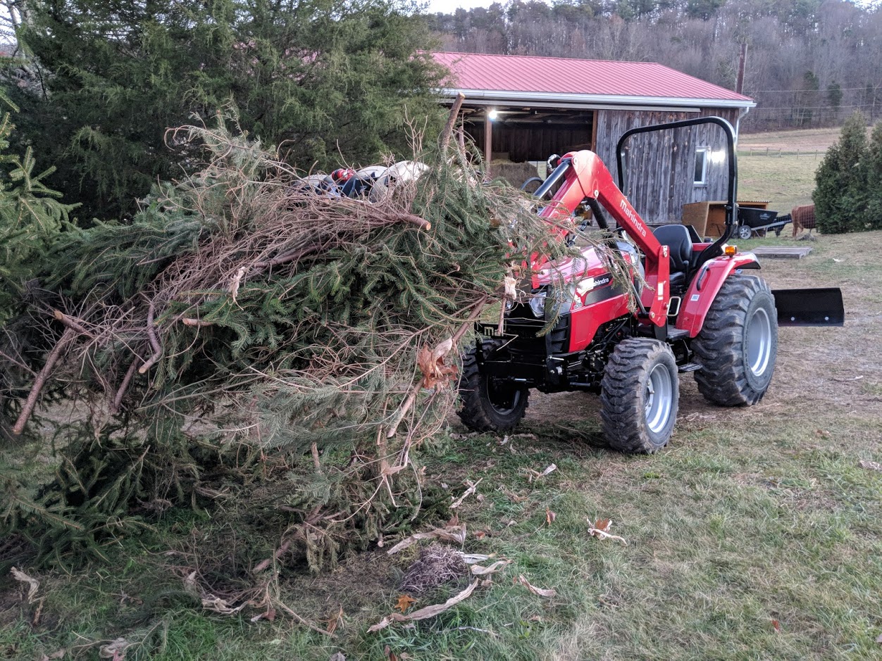

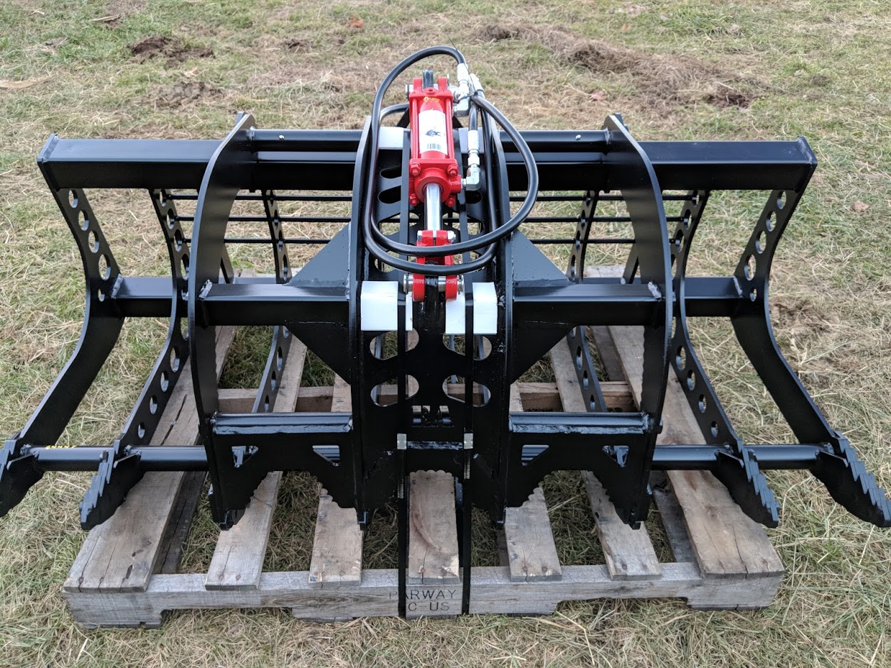

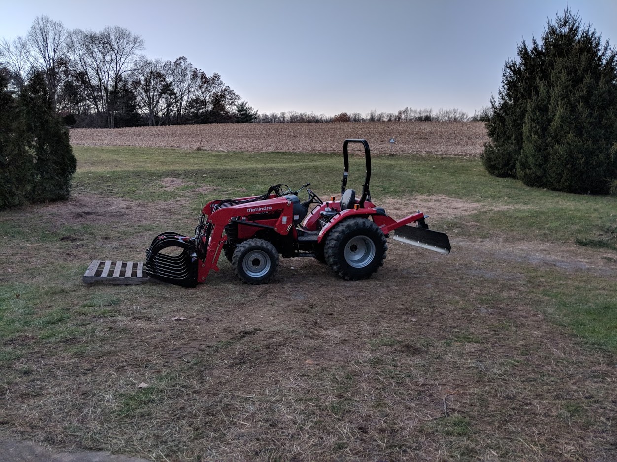

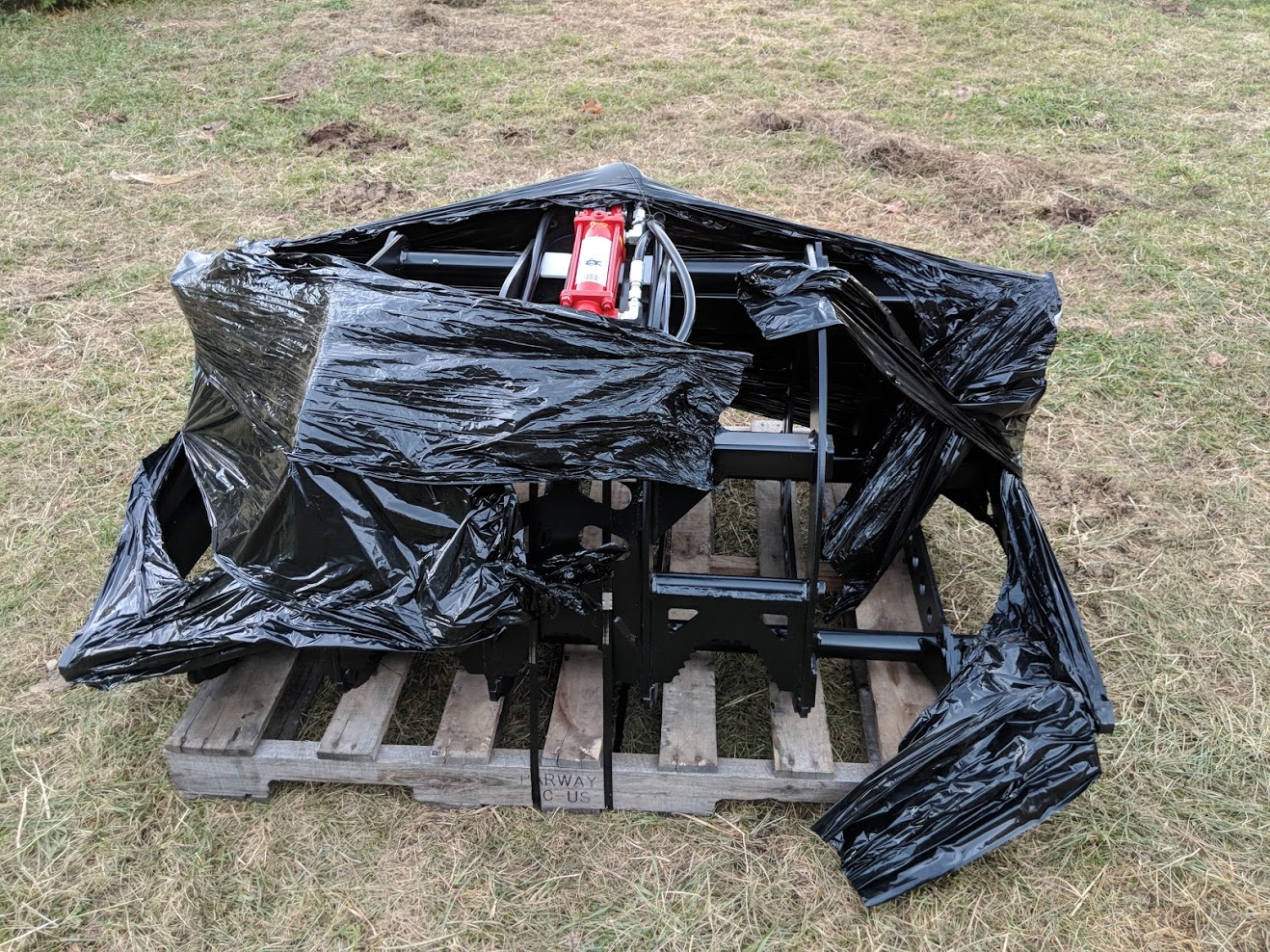

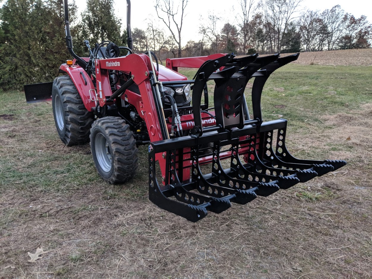

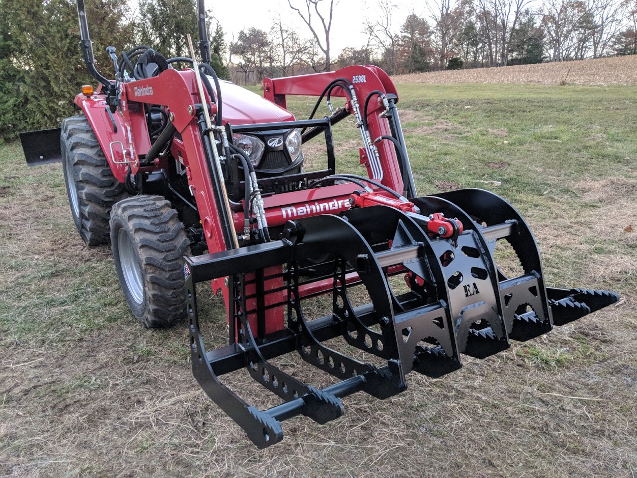

Got my 60" single lid today. Haven't had a chance to really use it yet, but looks good. Thanks to Snowback for feedback on sizes and single vs. double lid, and thanks to EA for getting it out quickly.
