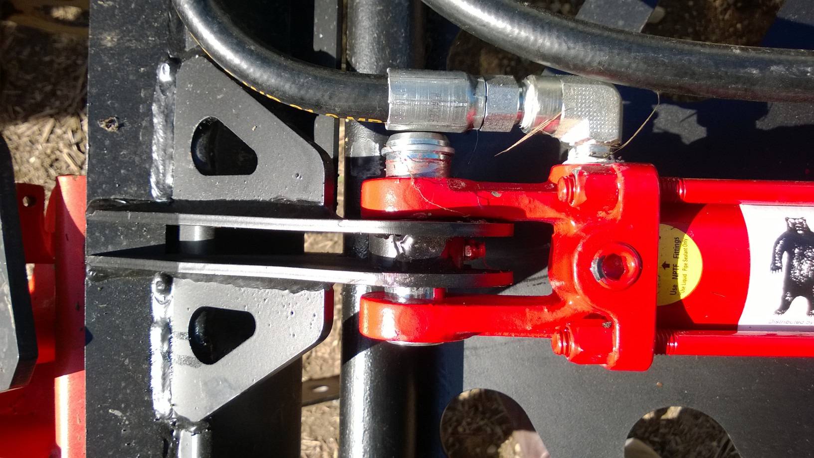

When I noticed the other two pins missing last night, I was on the way back home and did not really look close at it. But I did notice on at least one of the round pins that hold the cylinder that the whole thing was loose enough to turn. So I think however I push in the haripin clips, the position will change as the round pin turns over time. I'll be back out there in a few days maybe (weather permitting) and will look at the situation closer. Still like the elegant idea of a clip, though. If anyone gets a chance to measure the bottom of the groove where the hairpin clip goes through, please let me know and I'll look for some source of the clips online.
I think Harbor Freight sells a box of ?25 or 50 e clips of different sizes. Cheap money.

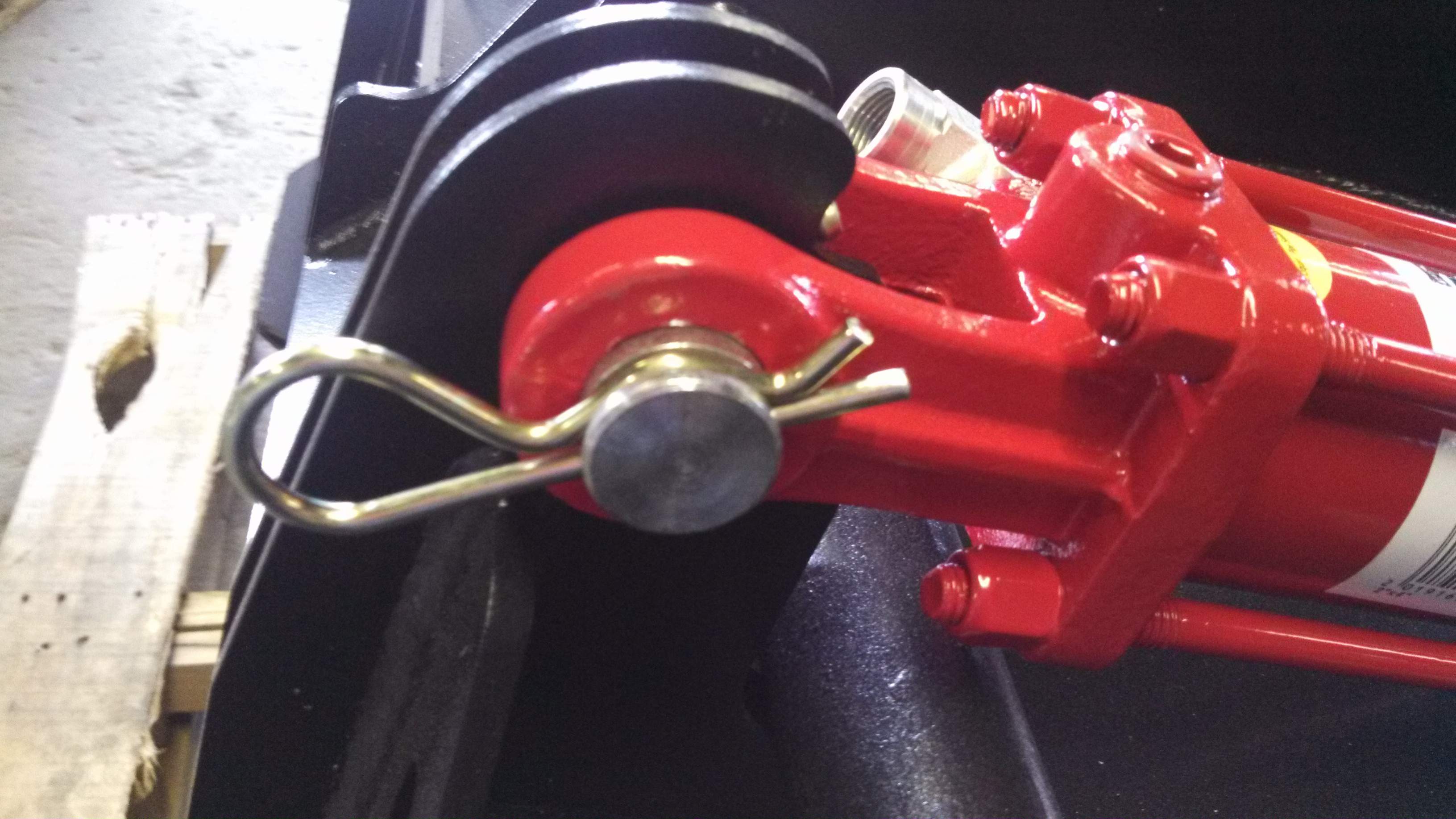

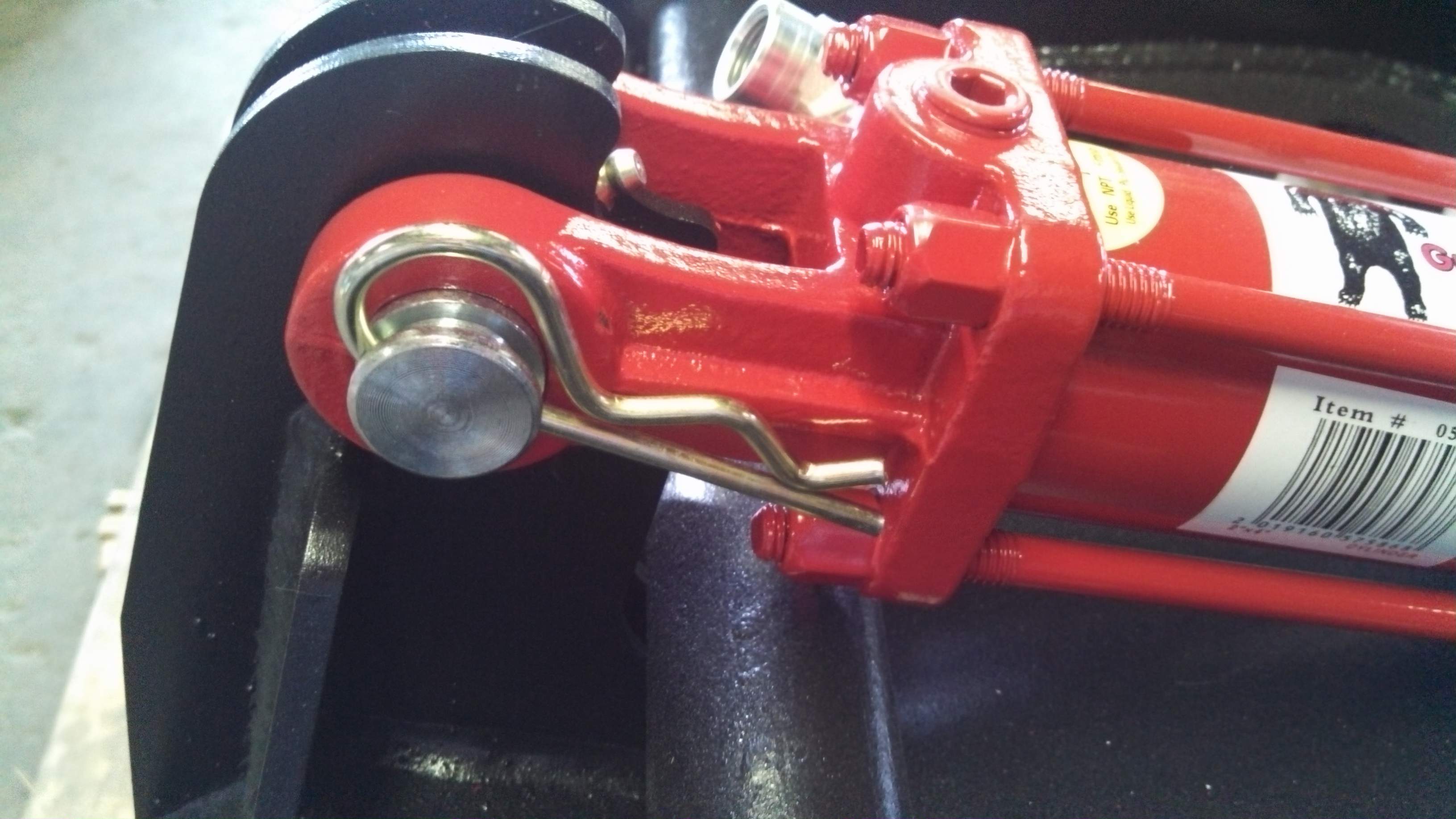

We're gonna ship 4 R-Pins and 4 cotter pins out today. The cotter pins will definitely stay put.
This is how they've been:
The guys will start pushing the R-pins all the way through. This way is much harder to remove and shouldn't go anywhere.
For added security, you could even wrap the end of the R-pin with tape or wire it shut.

Again, consider E clips. There is nothing for brush to snag. No meat hooks as with cotter pins. Come off and put on with either screwdriver tip or pliers. Easy peazy.

Seems a properly sized bolt and locknut application to me. Like has been mentioned, anything with a loop or something sticking out is just something for brush to catch on.
/ The WICKED Root & Debris GRAPPLE!!!!!!! #208
clip at .015 inches pretty much fills hole. i.e. hole is too small for bolt.
/ The WICKED Root & Debris GRAPPLE!!!!!!! #209
Understand, I was talking about the factory setup. I think they should have configured it different. I'd just do a simple cotter key given what you have, bend it around real good so it doesn't catch and be on my way. Happy grappling.

I was loosing R-pins that secured the scarifying shanks on a Befco grading scraper and did the same thing. I.E. Pushed them all the way through. Haven't lost any since.
/ The WICKED Root & Debris GRAPPLE!!!!!!! #213
It still seems odd to me that pins made for easy removal are used at connecting points where the pivots are never (or seldom) going to be taken apart. I tie my shoes with a shoestring knot. I don't tie shoestring knots on something I will likely never take apart or don't want coming apart. Too much chance the ends will get caught and untie the knot. I know this is more of a subject for the manufacturer, I just have not seen hairpins on any semi-permanent pivots on any of my equipment.

I'll have to look at it again when I am back out there, but my first thought is that if I ever have to remove the cylinder I might wish the cylinder pin was the other way around here. I really hate breaking loose doped threads loose if I don't have to.
I could be wrong, just going by the pic I took when I first noticed the pin backing out. Or maybe that is an e clip that can be removed with e pliers.

They must have installed that pin backwards by mistake. I checked the ones on hand and they're the opposite direction.
/ The WICKED Root & Debris GRAPPLE!!!!!!! #216
That was my guess actually. And by coincidence that was the cylinder plug that was leaking (trivial fix, though).
I shouldn't have to take off that cylinder ever, but I'd like to know exactly what pipe dope you use on those pipe fittings so I can have some on hand for emergencies (property is a bit remote)?
