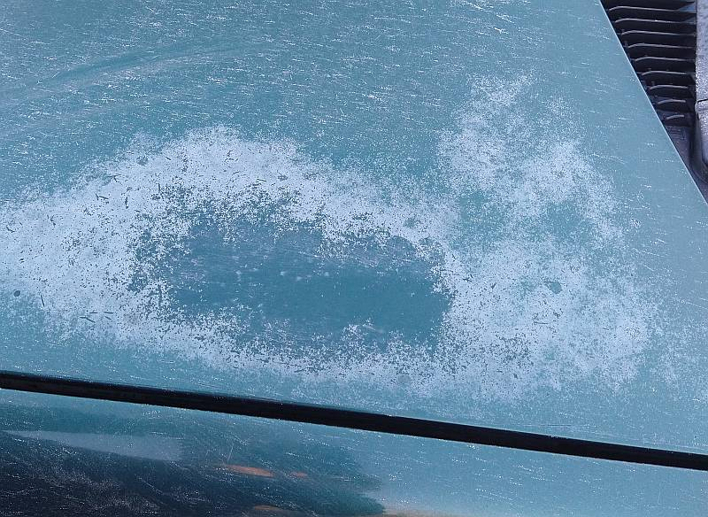

Some paint sunburn, but it looks like just the clear coat. Hoping I can buff that out some.

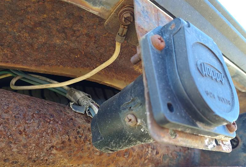

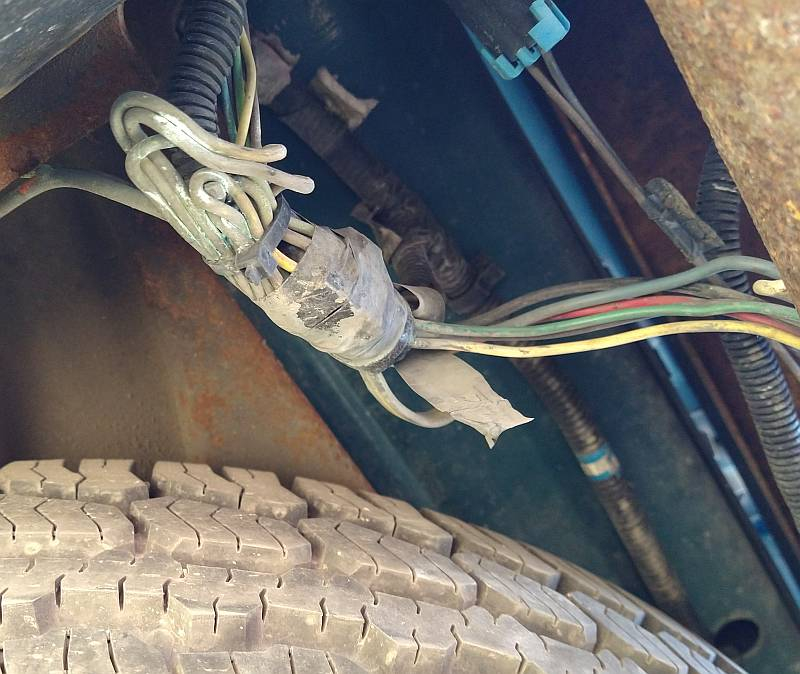

Trailer wire is kind of hacked in and I'll probably try to redo it eventually.
The rusted piece behind that is the trailer hitch cross tube. Powder coat is all gone. Will brush it with Rustoleum black.

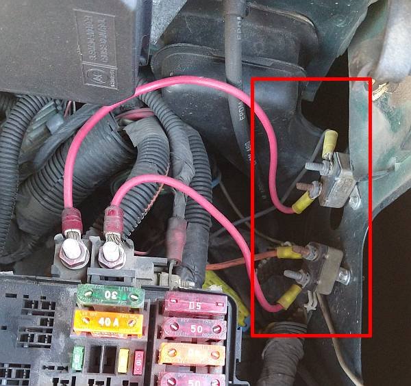

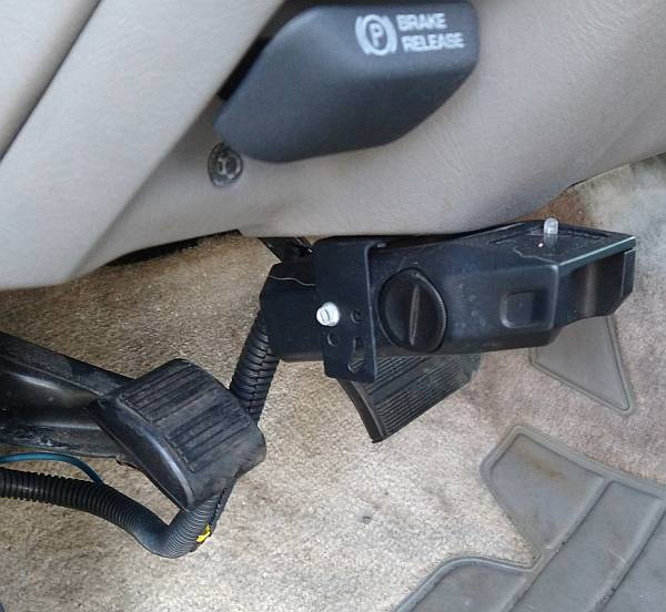

Curious thing is this black box and the add-on circuit breakers that appear to be wired to each other. No idea what it's for, except maybe related to trailer brakes? I don't ever plan on hauling anything heavy, so maybe that can come out?
View attachment 789529View attachment 789530
Might be a Tekonsha Voyager trailer brake controller.

I would think carefully about replacing that 25 year old receiver hitch, if you plan to be pulling a trailer. They don't cost much and are made of chinzy steel. They also rust from the inside out. I've seen them let go on the road, when somebody was just pulling a light trailer.

We had a '93 suburban with a factory hitch. I sold it to a mechanic for $500 about a year and a half ago. The trailer hitch supports had rust holes big enough to put your fist through. He bought a new hitch. They are pretty easy to put on once you get the old one off. He torched the bolts on the old one rather than messing with the rusted bolts.
For example, U-Haul sells a 9000# hitch ( which is more than your truck can legally tow ), for $200.

The black box is a trailer brake controller and not a very good one. It’s hard to say what the circuit breakers are for without running down the wires.

As far as I can tell, the breakers are wired to the black box. Hopefully, U-Haul will be able to tell me more.
If this is what you mean, the wiring diagram would explain the two breakers: https://www.etrailer.com/question-6890.html

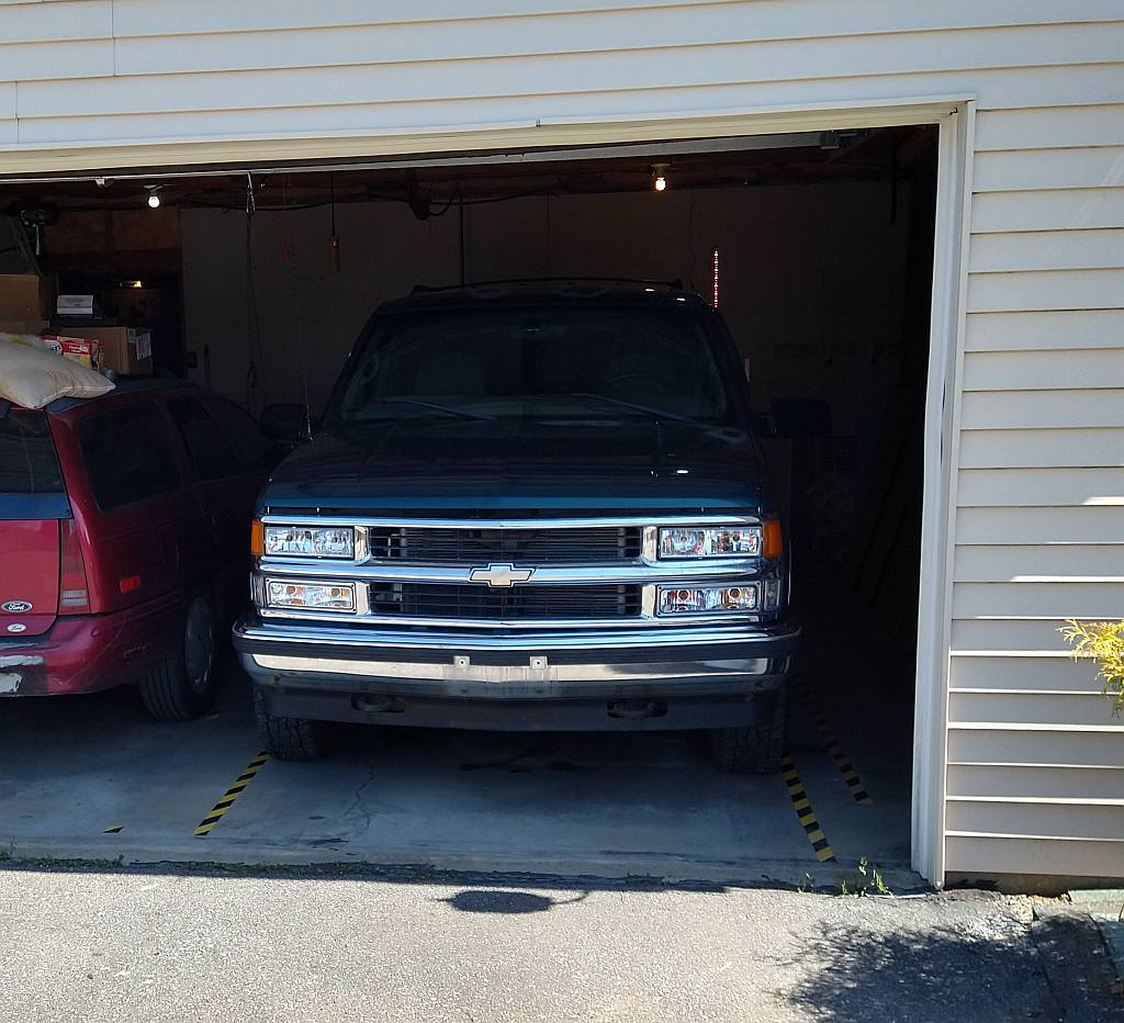

It Fits!! Sorta. Close quarters and will have to be very careful.
Tape lines on the floor and LED markers on the back wall will help. I hope.
Only about 12-18 inches less than the space between the wall and the door, so no walking between either in front or behind.
