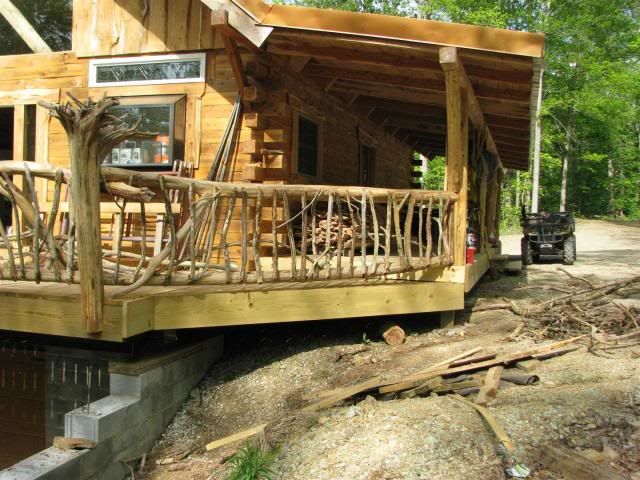

Ok, more news, I am relieved, but sorry to lose them. The two red oaks I built the porch & deck roof around....we took them down since they were hitting the roof in storms. I feel like I put it off as long as I could, but with winter on the way I was worried about the damage they could do so I asked a friend/neighbor/logger to come cut them. I still have way too much to learn to risk cutting two 18" oak trees that are 5" away from the house....he made it look easy and dropped them exactly where he wanted....no ropes.
If I had only scooted the house back about a foot, they could have stayed and were still quite healthy even though the lower 3' of trunk was covered with backfill. They won't go to waste, I bought a 12K winch at HF the other day just so I can recover them from down the hill and make them into firewood. Also, the porch view/feeling is opened up a bit....which will take some getting used to.
