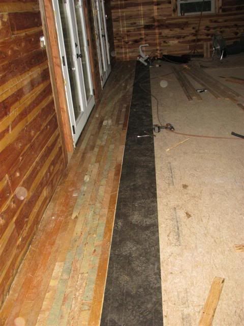

M7 when you say "runout" I assume you mean things will not be completely parallel when you reach the far wall. That is pretty normal in my world. There are very few truly perfect square houses. You will just need to adjust by tapering your finish courses and let the trim hide the cut.
It is common to come across boards without a tongue or groove end when installing used flooring. Actually a lot of reclaimed flooring like heart pine milled from old beams is shipped without end T&G. It is best to use as many good ends as you can but don't reject boards without end milling. If you make a butt joint without the T&G put a staple about 1 1/2 inchs on either side of the joint and you will be fine.
It looks like the flooring is going down well. That can be a challenge with used flooring sometimes. Often there is a build up of dirt or varnish at the tongue or groove that can prevent a tight fit. It helps to have a scraper around if you run into that type of thing.
MarkV
MarkV
Whoaaa, wait a min....we are talking about MY house...and it is perfect:laughing:......well..at least it started square:cool:
Yes that is what I meant by runout. On a deck it's easy to fix as long as you keep checking it for square as you add boards. I didn't figure that there is any way to fix a hardwoood floor that gets out of square, but I thought you pro's might have had some secret Zen like method.
This pretty much has T&G on all the ends. I just managed to grab one that had been cut...didn't check it and proceeded to drive 4 staples into it. I gotta say the staples do hold well. So far the fit is good unless the T&G was damaged when removed and I've been using a sharp razor knife to cut out the bad tongue and clear the grooves.
Oh, and I didn't worry about getting the floor tight to the door jams. The way the floor and logs laid out I ended up with the equivalent of putting the doors on top of the subfloor. This means even with the oak I still have a "step up" at the door of about 3/4 to 1". So, I will have to make custom beveled transition thresholds on the inside at each of the 3 french doors. It would not have been my first choice, but it is what it is and it will only take a couple of hrs to make them up and fit them.

Dang FB, the Power jack costs an arm, leg and several fingers. But, thanks for the idea as I think I can weld some brackets onto a cheap hyd jack and make one. I don't like that strap, it will have a tendency to pull the boards up not together.
   / The Log house Project begins........ #1,096
What we did was take a car scissor jack and put a block of wood behind it that was screwed into the subfloor and then jacked it back into position, I would have rather had the straps. We were not off that much and we already had over 1/2 the floor done and once we got it back in position we finished up in no time.
10-4...that's more :thumbsup:like it
