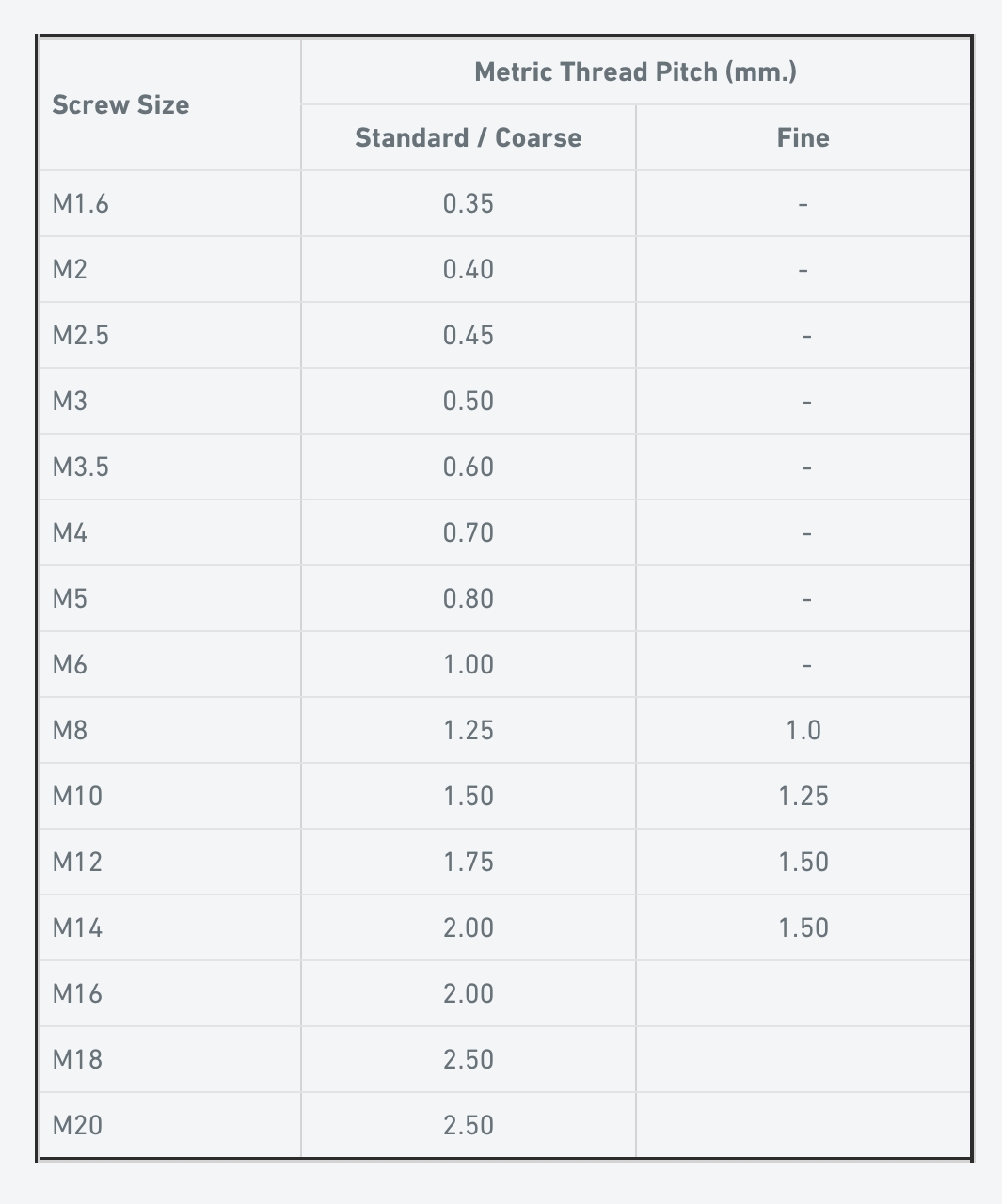

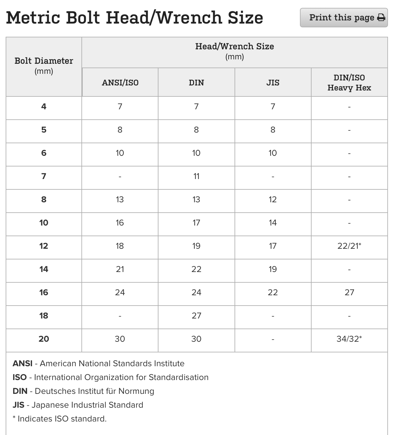

Does anyone know what the threads are?
Its a 19mm socket.
Thanks!
Its a 19mm socket.
Thanks!

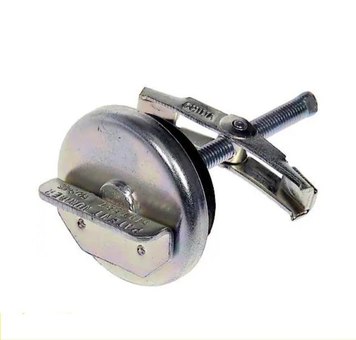

I see Dorman makes this...that's when things REALLY get boogered!!!

Boy I hate these metric thread sizes.
And I forgot Bobcat part #'s, are hard to track down.
Thanks for the responses!
