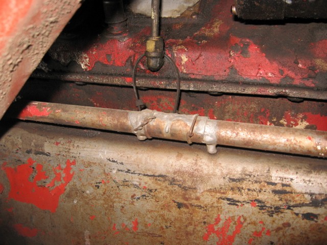

This probably isnt the "best" way but it worked in a pinch! :)
I repaired a hydraulic line that had a .22 hole in it with tin and silver solder and a propane torch 15 years ago on my old Massey in order to get it on a trailer where I bought it at and its still 100% leak free.
All I did was clean and sand all surfaces and pre-tinned the tin on the back side and also the line and wrapped the tin around the line and wrapped that tight with mechanics wire and soldered it up with silver solder worked way better than I would have dreamed of and is still holding today.
