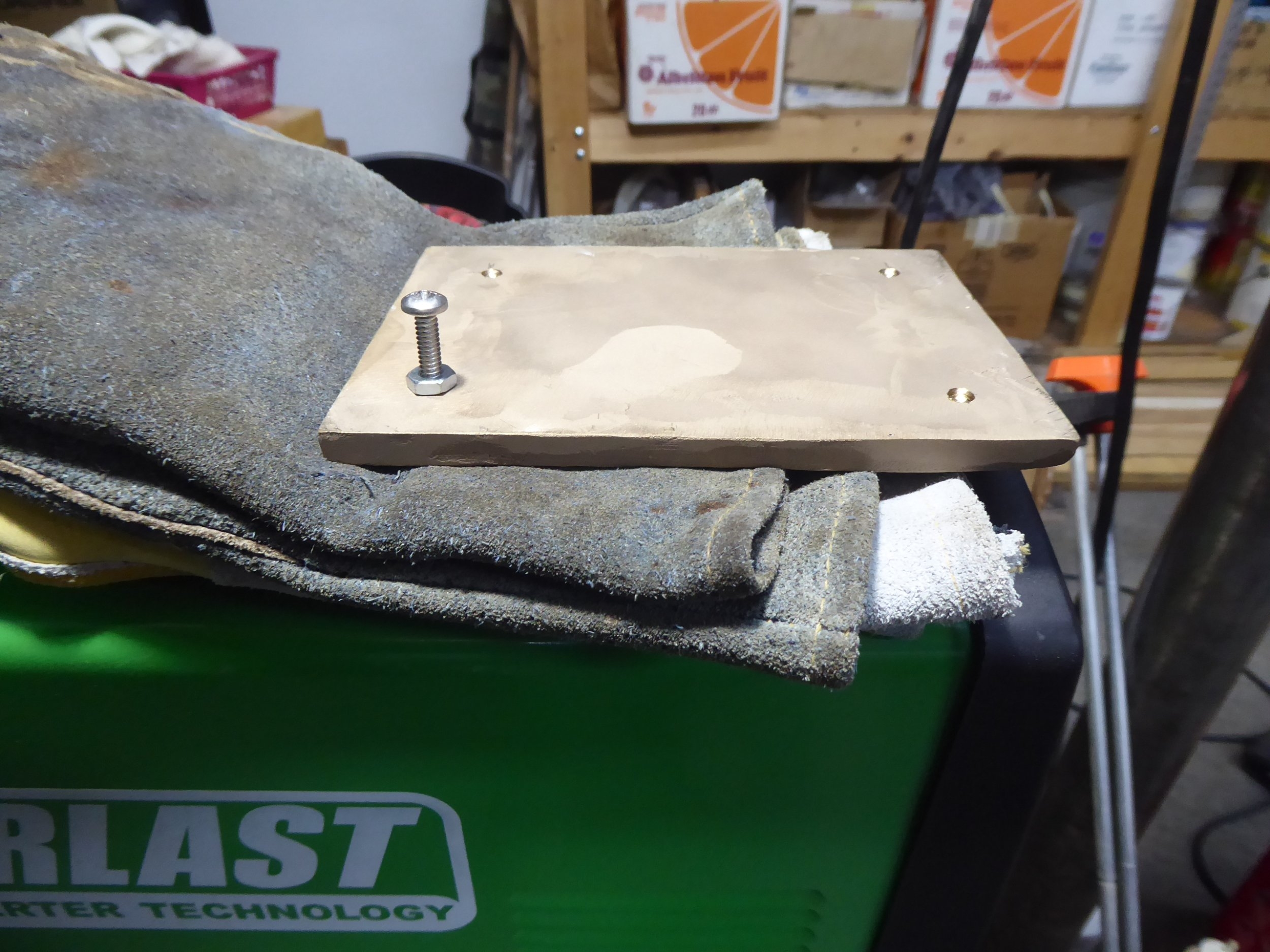

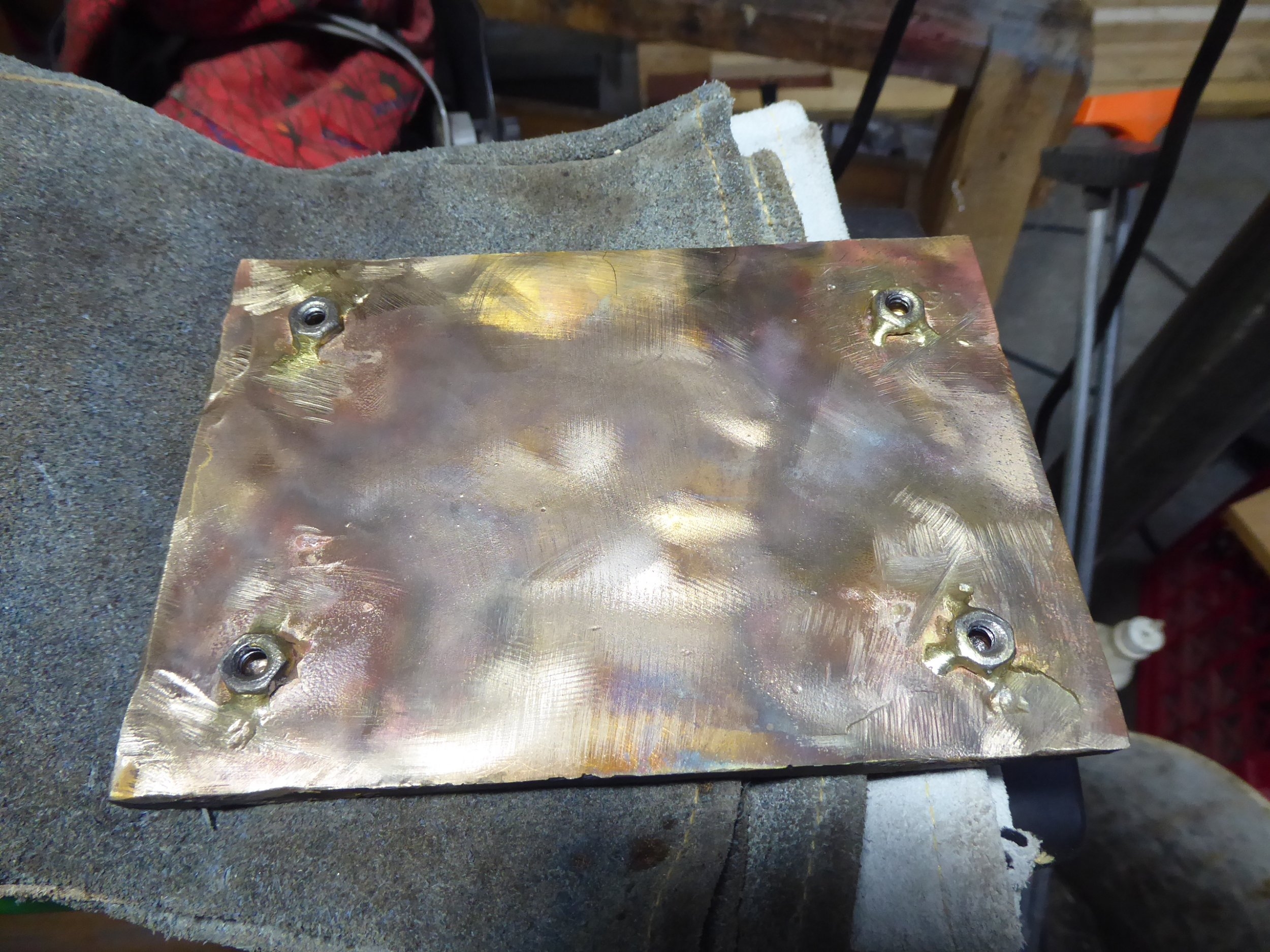

I have a neighbor friend who is an artist that works in bronze. Every once in a while he will bring over a bronze plaque and ask me to weld 10-24 nuts on the back so he can mount them in a wood frame he makes by routing out a recess. So far I have done about 10 of these, a couple at a time. I have a stick welder and an O/A set and I am just a door yard welder. I don't have much chance to experiment on a method and am nervous about screwing up his piece. So far the best method I have found is the O/A set and 1/16 bronze flux coated rod and catch the nut on 3 sides. I put a stainless screw in the nut an set it in the marker hole he drills after I grind the area off a little (Pic not ground off).
As soon as I catch one side I remove the screw. If I don't the screw gets stuck with flux or bronze wicks to it and I have to grind the nut off when I twist off the screw. When I braze the other sides with the threads open they tend to get crudded up. Most times I can fix it with a bottom tap I made by cutting off a standard tap. The job doesn't come out beautiful but it's best I can do and he is happy.
I keep thinking there must be an easier way and am looking for suggestions. Thanks !

If you have to use nuts you can use a carbon stick instead of the bolt. Low fuming bronze won't stick to it. Silver solder would work as well or Phos Bronze if you want to use Mig.

Was thinking this a good solution myself.... IF threads get a little flux in there, it can easily be cleaned with a "bottom" tap....

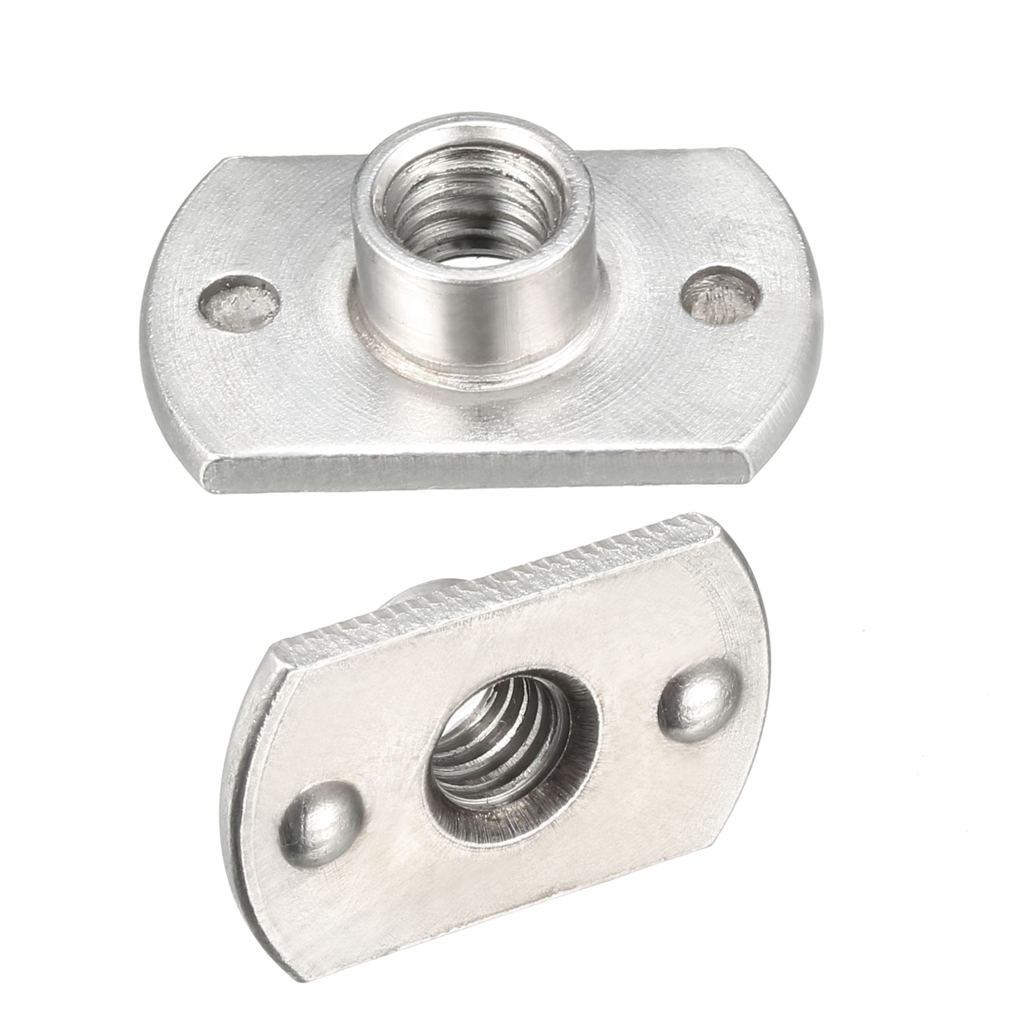

You could use weld nuts and keep the heat away from the threads

I had to braze on 1/2” captive nuts to 2 1/2” square steel tubing to make a tractor tool bar. I put anti-seize on a steel bolt and (like I understand what you’re doing), left it proud of the nut to locate it in the hole. As soon as I had it tacked in place, I backed it out till it was about 2 threads in. Kept flux out of the threads but was easy to break loose. Bottoming tap started easily and cleaned any bronze & flux out of the threads. I did mine with bare rod and paste flux but you can get the same effect by sanding some of the flux off a coated rod. Really don’t need a lot of flux on clean metal
