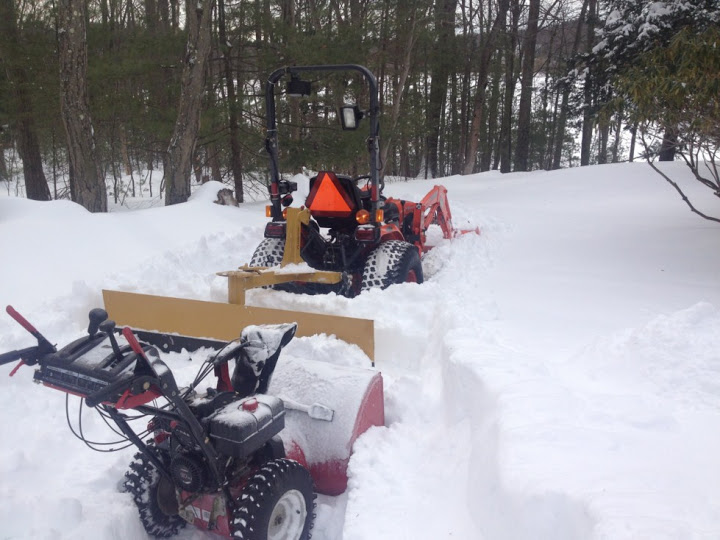

Cool blade, have any pics of it and how it is hooked up? Looks useful, i always seem to be levelling with the fel and a front blade would be much easier.
Here are a few
First one of the b2920 with SIMS cab and quick attach/front PTO hook up
Second of the rear of the bx2760 blade where the male end of the tractor's quick hitch fits in.
Locked in place with 1 lever and spring pin

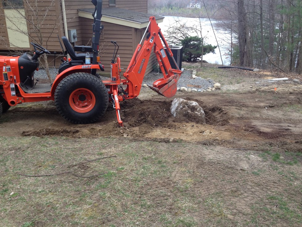

I unleashed the B2920 on my foe!
Before - This mess of 10 vine maples, multiple trees, blackberries, and about a foot of dead limbs and brush was my back yard.
After - I got to work with the BH65 and only the three largest stumps survived the battle. I was able to rip out all their roots and wiggle the stumps about 1/4 inch but that's all the B2920 had. I'm leaving them for the stump grinder. I gave the battle field a taste of a 50 inch reverse tine Landpride tiller yesterday just before the rain started. Some smoothing and I'm going to hit it with grass seed and fert. Oh the blackberries they went AHHHHH AHHHHH, yeah die you mothers!
The next section of my property is cleared but clay infested with 1-7 inch river rock packed down hard from the house construction. It was too much for the tiller, beat up a couple of tines so I'm going to rip it with the box blade first after things dry out from this rain. See if I can clear the big rocks then till and plant grass.

#45
No action shots sorry. I nearly stopped to take a pic of the big stump when I had it all dug out that was about a 12 foot diameter hole with roots as big as some stumps I dug. I should have taken a pic of my biggest pit, that was about 6 foot wide by 18 feet long and 5-6 foot deep. I crammed a huge pile of stumps, roots, and limbs into that thing. Whacked the roots off the stumps with my chain saw and placed the stumps in the bottom then dozed the rest in and worked it hard for about an hour with the BH crushing with the thumb and curling the pile under and down until it was tight packed and crammed down as low as it would go. I probably have about close to 2 feet of compacted clay over the top of it. Its entombed. By brother thinks it will rot and I'll have a big depression but there's no life down there in that clay, no bugs, worms, plant life, nada. My guess is that won't decay in my lifetime.
