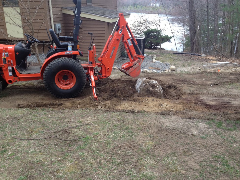

Rebuilt a stone wall with the BH and thumb (big rocks). Replaced part of the septic system with the BH and multiple drainage projects. The BH is off most of the time, but when I need it I really love it!

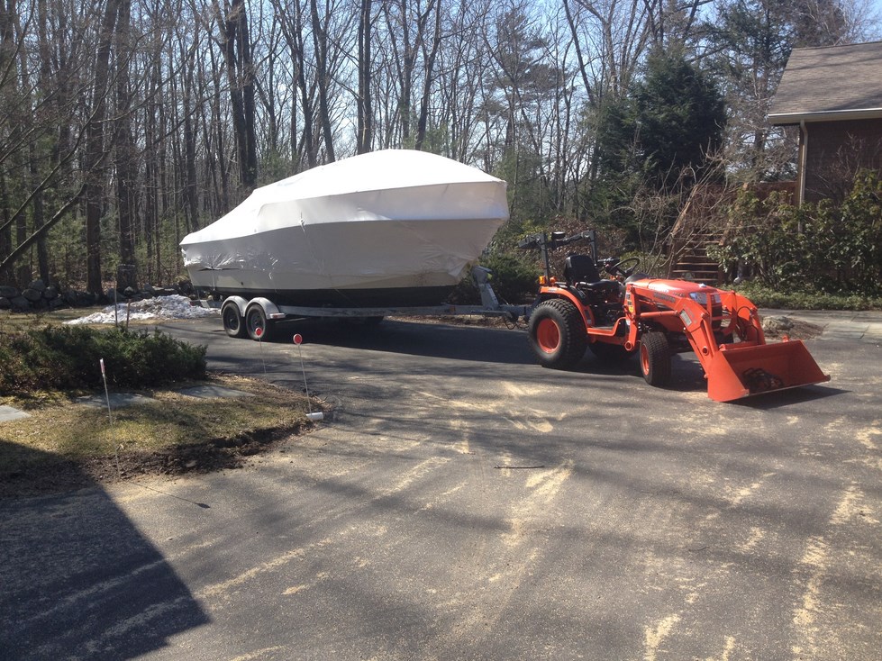

Pulling a 6,000 lb + boat

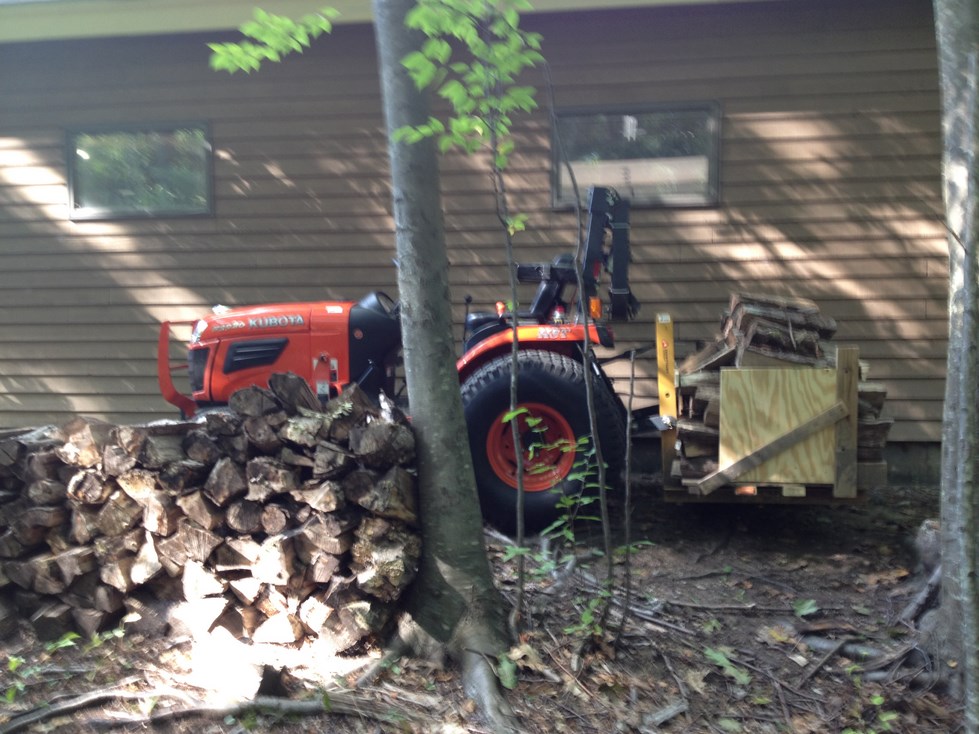

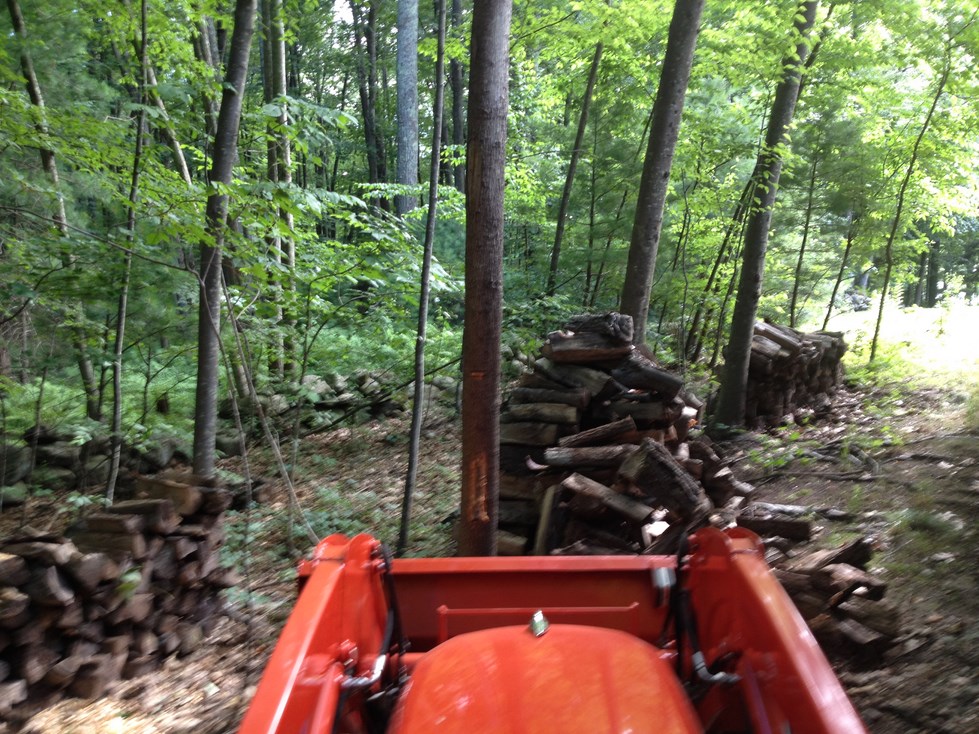

Moving a stack of firewood, it goes under the deck hence no FEL and folded ROPS

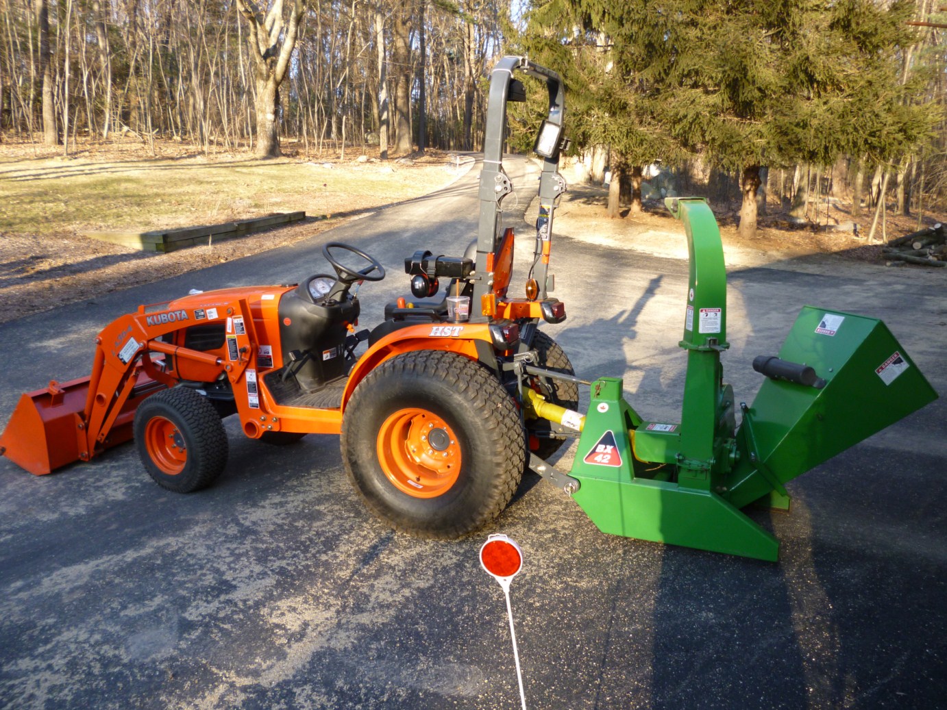

Chipper

I got the chipper lightly used, so there was no chain with it. I use a bungy to hold the PTO shaft up and on the chipper when it's off the tractor and on the dolly. I use the same bungy when the PTO's on the tractor and hook it to the top link or hole in the tractor PTO shield and onto the plastic shaft shield. It doesn't spin a lot without a chain, but its one of those things that I'd rather just have stay in place because someone might be tempted to grab it to stop the spinning or something.
