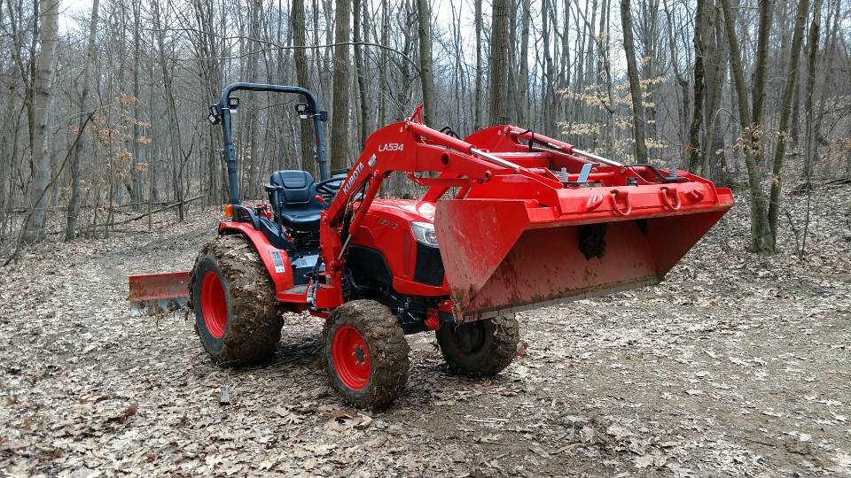

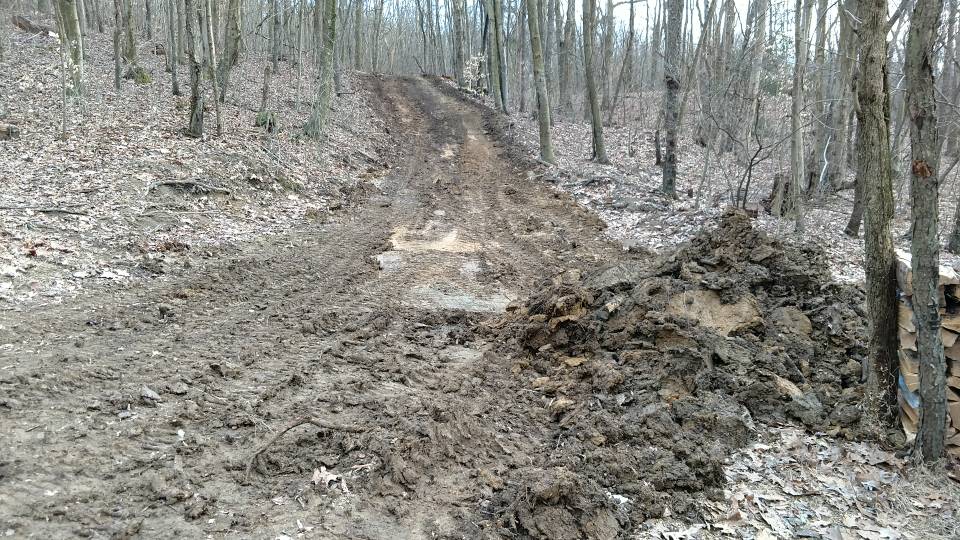

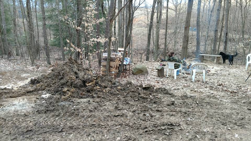

Finally, we got a few dry days and I got the B2650 down into my property to start fixing trails with the rear blade. The R4 tires (at least this big of them) isn't nearly as bad in mud as I've read. I was able to pull the blade into the ground and tear the high edges into the center rain ruts and drag some material down for later use.
My wife sat by a fire and drank beer as I (played) worked on a section of logging road. IMG_20180228_154755741.jpgIMG_20180228_173036852.jpgIMG_20180228_173059838.jpg
My wife sat by a fire and drank beer as I (played) worked on a section of logging road.View attachment 541980View attachment 541981View attachment 541982

She just shakes her head in confusion as I play with the tractor... To her, it's a waste of money and a toy. To me it's an essential part of our world being that we have 15 acres on a pretty serious slope, and that we use 8 months if the year for social gatherings.

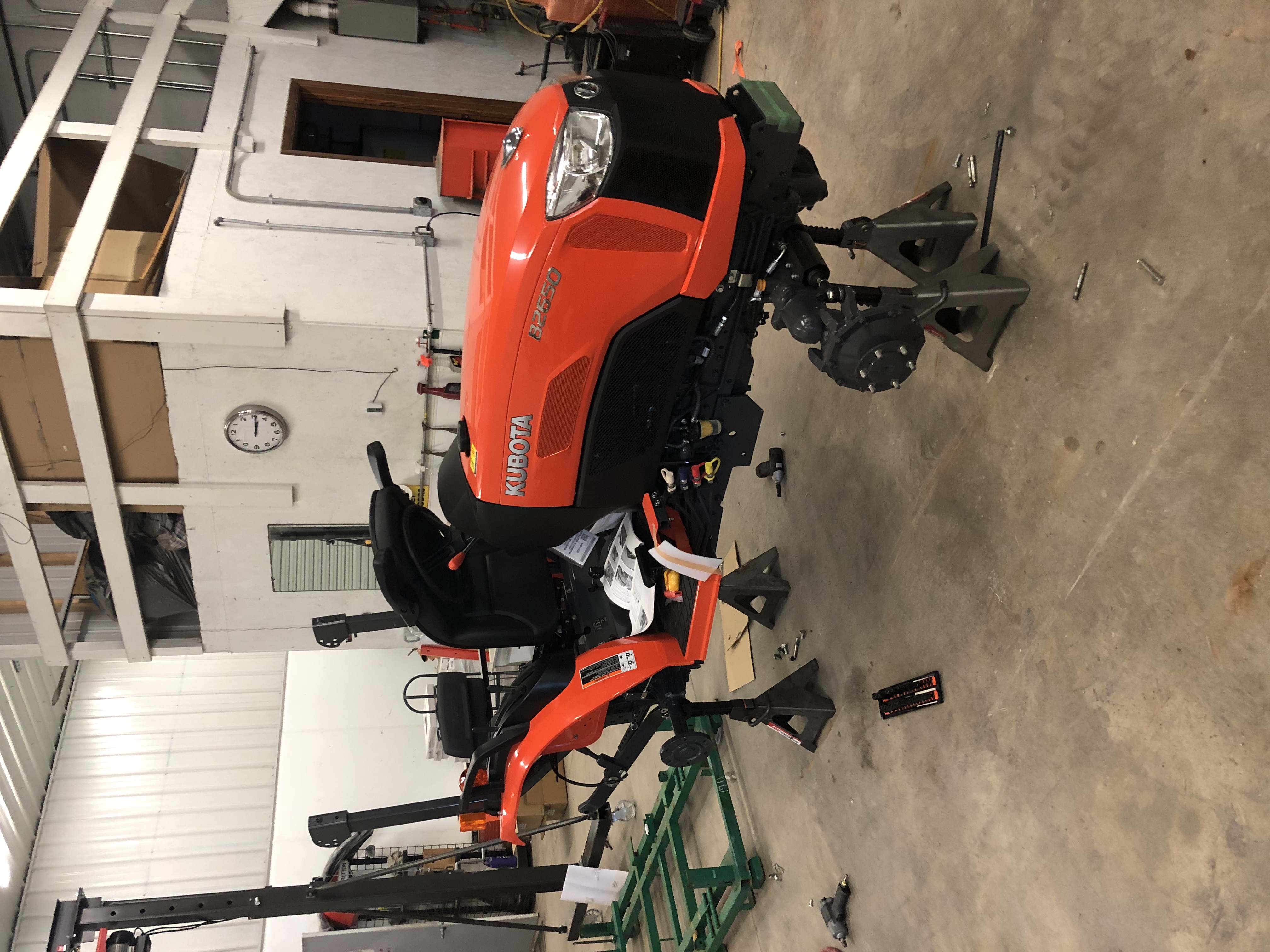

Got the 2nd hose made up last night. Going to stop at Home Depot after work to get the barbed tee. Maybe get the valve install finished tonight. Then I can work on the levers.

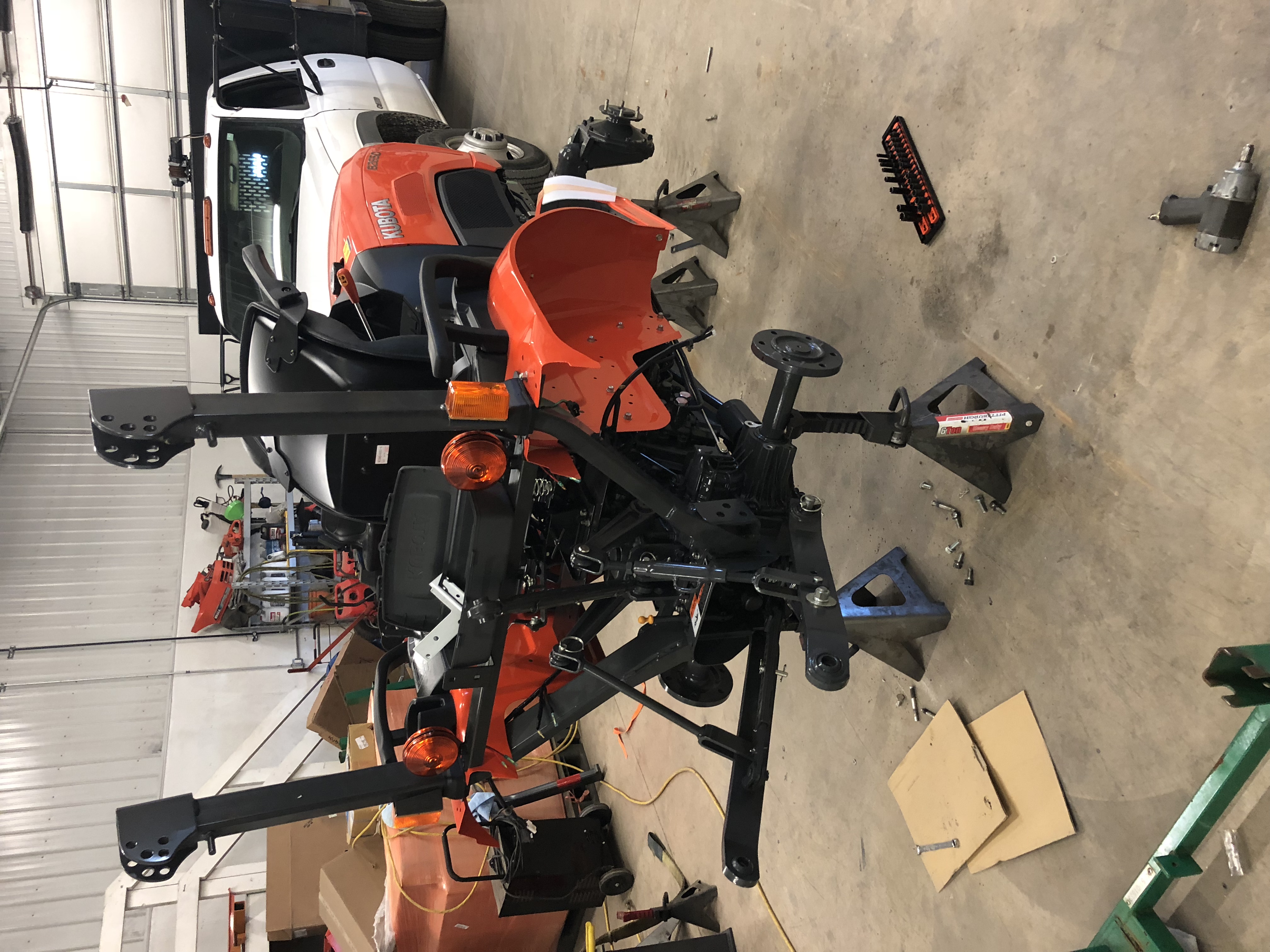

Valve is installed. No leaks. Lines don稚 look out of place and tie inline from the 3rd function valve.
Thanks Ron for the tip on the PEX 1/2 tee for the return line.
Just need to make up the levers. But it痴 beer thirty and that can wait for another day.

Man that looks super legit, I would say that that looks every bit as Factory as anything I've ever seen. You did a really fantastic job!

Way better than the 1200$ kubota option. I told my
Dealer when I seen one installed on a b3350 that I would be embarrassed to sell that.
I have 340$ wrapped up in this. And that includes 6 male ends up the couplers with dust plugs for when I find some implements.
Your are welcome Dan. Your install looks really good. Nicely done.
