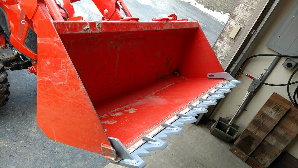

Got the piranha bar installed today. Man, what a thick, knife edged beast of a chunk of steel!IMG_20180324_134816339.jpg

Yes, it's bolted on, set tightly back. I have an actually tooth bar as well (from my buddies skid steer) that I'm going to shorten to for my little bucket and then I'll make brackets that fit the same bolt holes from the Piranha.
