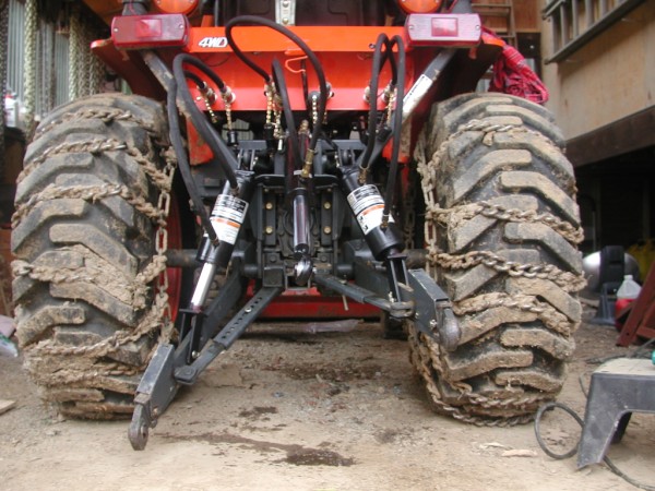

I’m happy to report that except for some final hose length adjustments, I am pretty much done with the T&T project. Working backward again, here is the end result. I am not sure when this much tilt would ever be needed, but I guess having the capability can’t hurt.
This is 4” of tilt on one side. Each side can tilt equally since I used two identical cylinders. When I bring both cylinders to the top position, I know without thinking that the implement is level.
The Prince control valves with the built in pilot-operated check valves click pretty loudly when activated and seem to work well.
Float on a tilt cylinder looks promising. I think adding it was a plus. Have only done limited testing so far. I should know more after we get some snow.

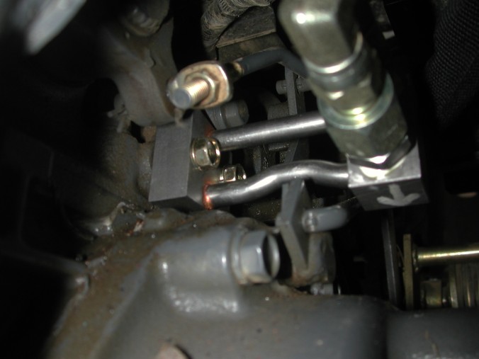

But first, for B2910 and B2710 owners that may be out there, here is a picture of the adapter block that is used for the rear remotes. I though it was going to be a pain to install, but it ended up being a piece of cake installation. It went on so easy, it is not worth talking about…

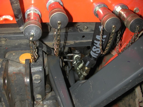

A shot of the hoses leaving the adapter block and heading to the control valve. Again, probably of no interest to those with different tractors.

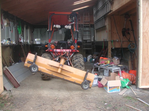

4” stroke on one lift arm makes a huge difference in elevation at the ends. I bet 2” would be enough tilt, but I was glad I ended up with 4” only because of the heat travelling down the cylinder rod when I welded on the ends.
If one was able to weld and cool the rod enough not to worry about the cylinder seals, my guess is that a 2” cylinder on each side would be enough. Still, no regrets so far as far as I go.
