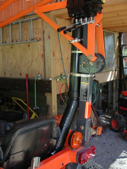

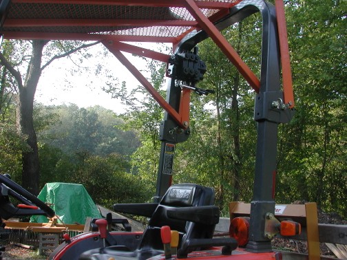

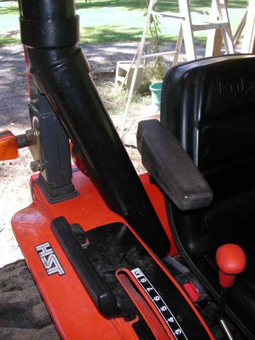

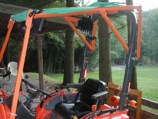

Pineridge,
The placement of the control valve has to please my body and my arm. All I know at the moment is that it pleases my body and my head, as it is totally out of the way when using both the tractor with the backhoe off, and the backhoe with the tractor attached... /forums/images/graemlins/grin.gif Time will tell...and hopefull I will be able to give an unbiased opinion after I get the T&T working...

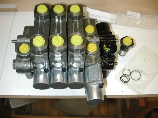

The Prince control valve I purchased uses ORB fittings. The Prince cylinders use JIC37 fittings...
Waste of money[buying an adapter] if you can get that [something] end put right on the hose to begin with, at least from my perspective...again, depending on the individual costs of the parts...
