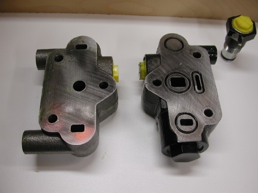

Final configuration for assembly. The O-rings come with each valve section in a little bag like you see in this picture.
