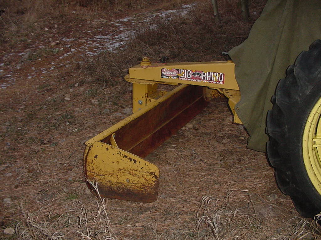

Box blades for the rear are inexpensive, most people have one laying around. You can't hurt a box blade....at least I've never heard of anyone doing so. They are the most rugged implement going and you can pile weight on them to offset a full loader or just to do more work. All of which means that everyone has a box blade or two - and every box blade ever built still works just fine. They are basic, inexpensive, and tend to come with used tractors. Most every dealer will offer to throw one in.... A used box blade is about a $250 bonus around here. I think we've got three of them laying out in the implement row behind the barn. And they are universal; you can always borrow one.

rScotty
