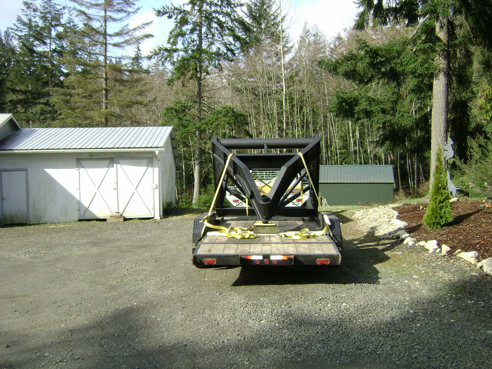

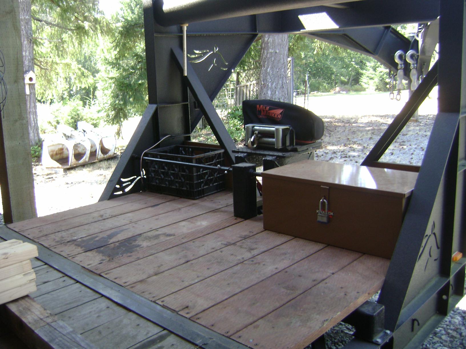

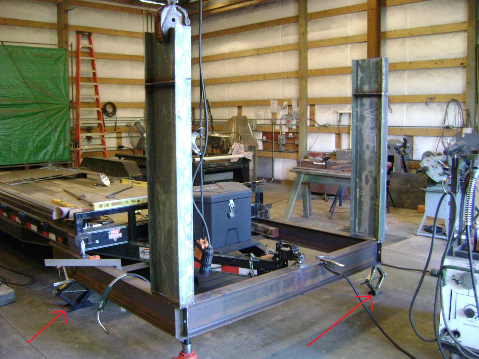

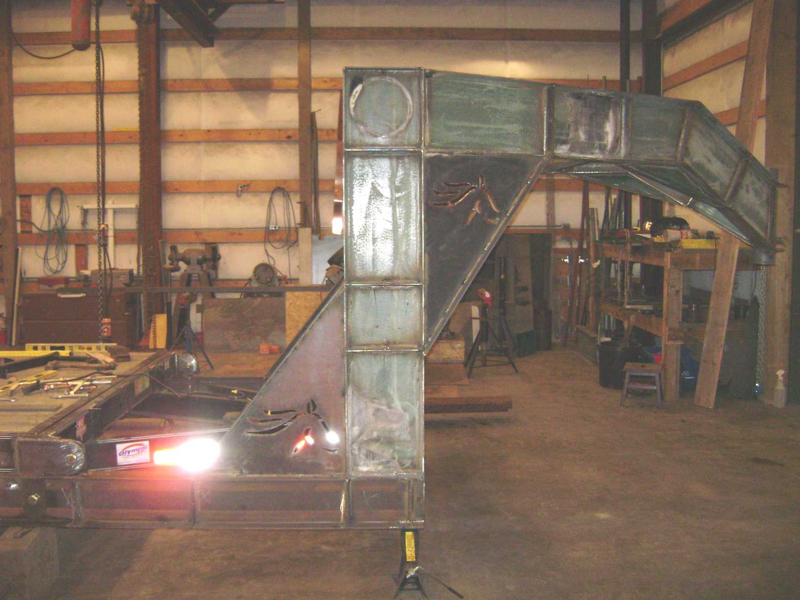

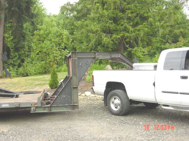

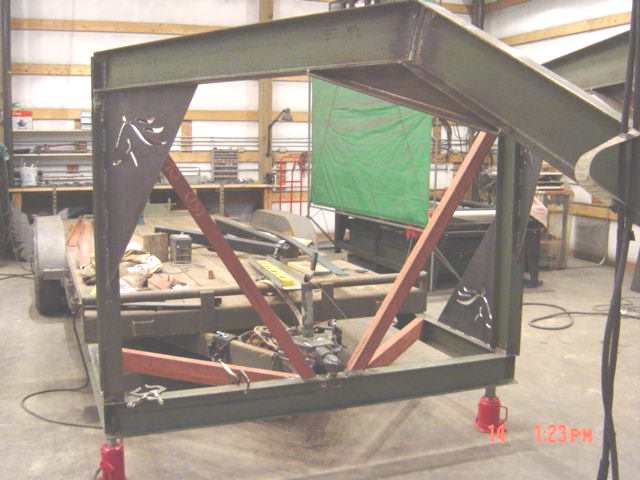

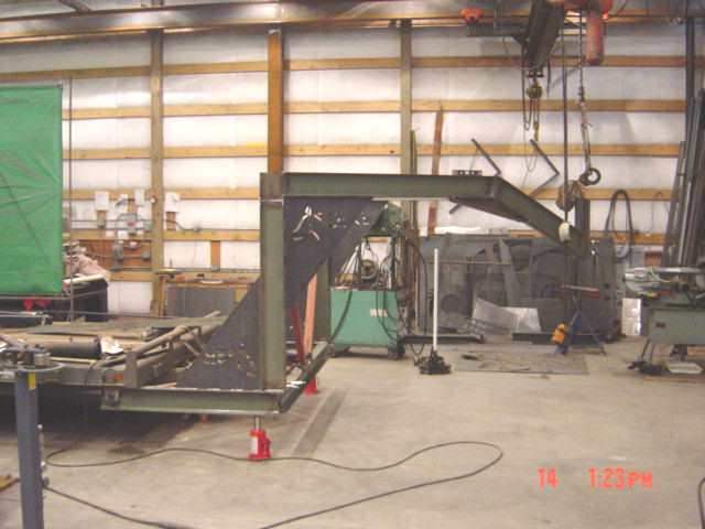

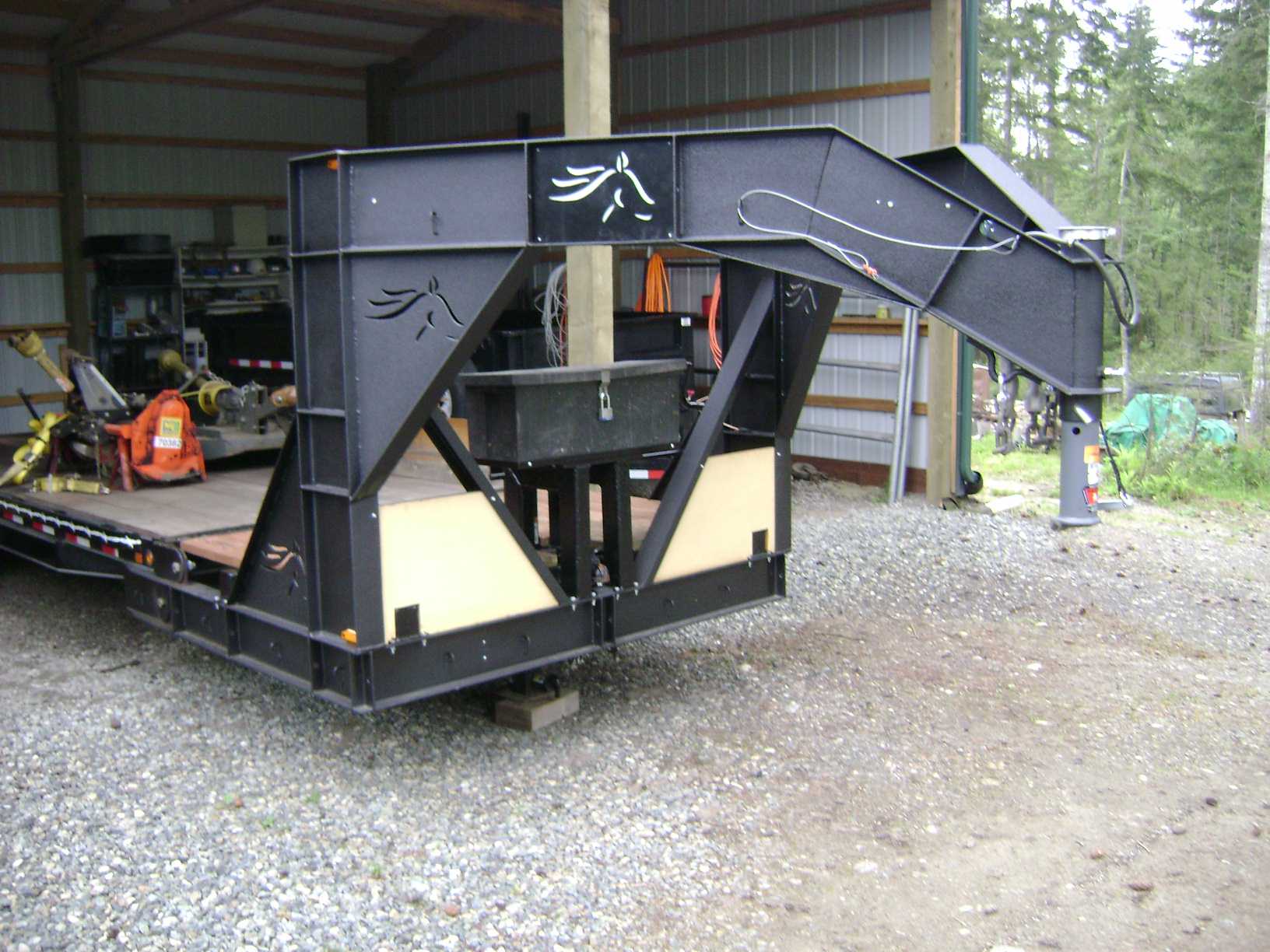

I've done this a couple times. They are really easy to build.;)
Very nice work, but that is a heck of a lot of steel.... Our 12t goose was nowhere near that heavily built.
/ tag to goose neck conversion #11
First one I did was for a friend. Used smaller steel. :D
