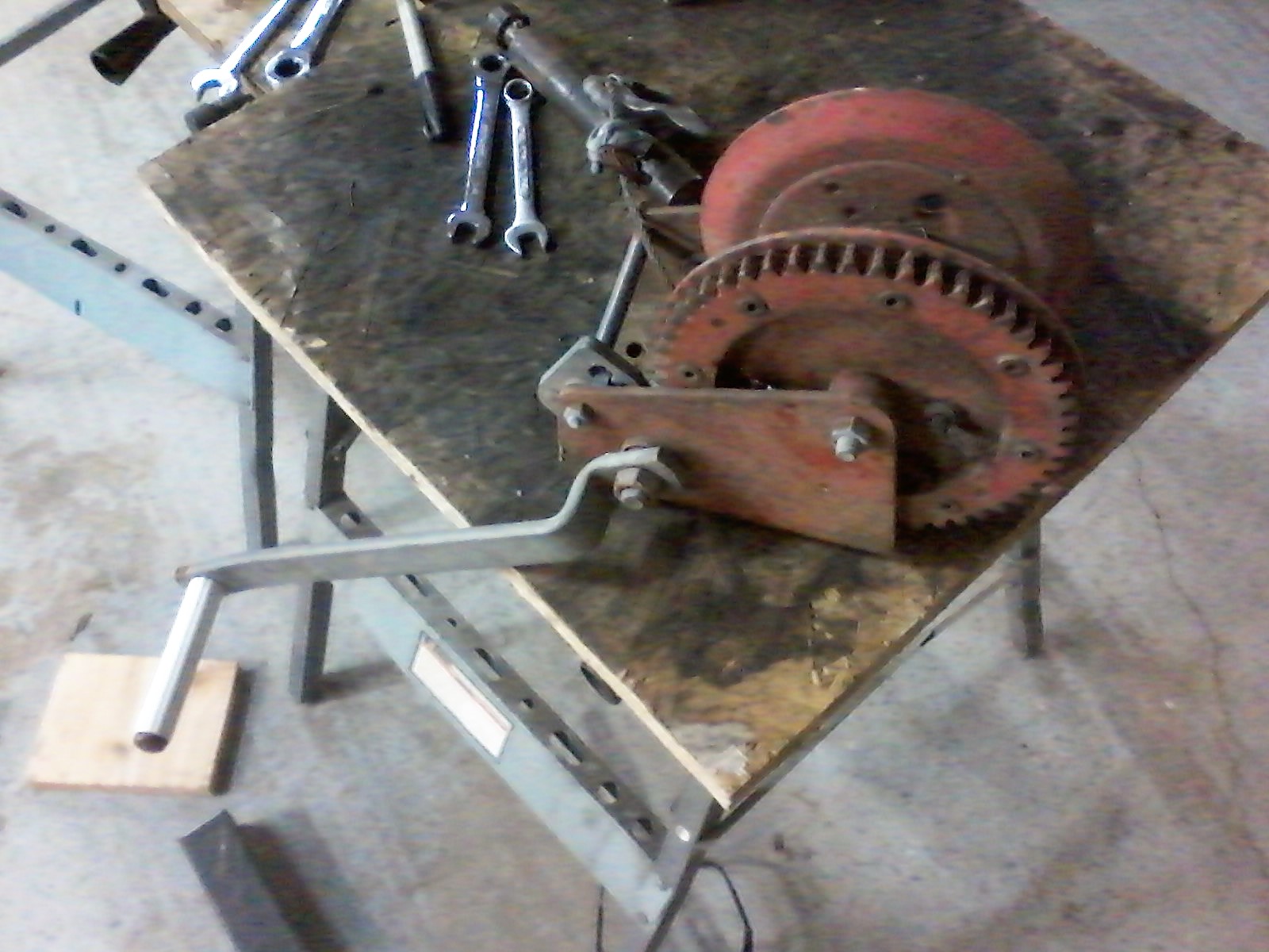

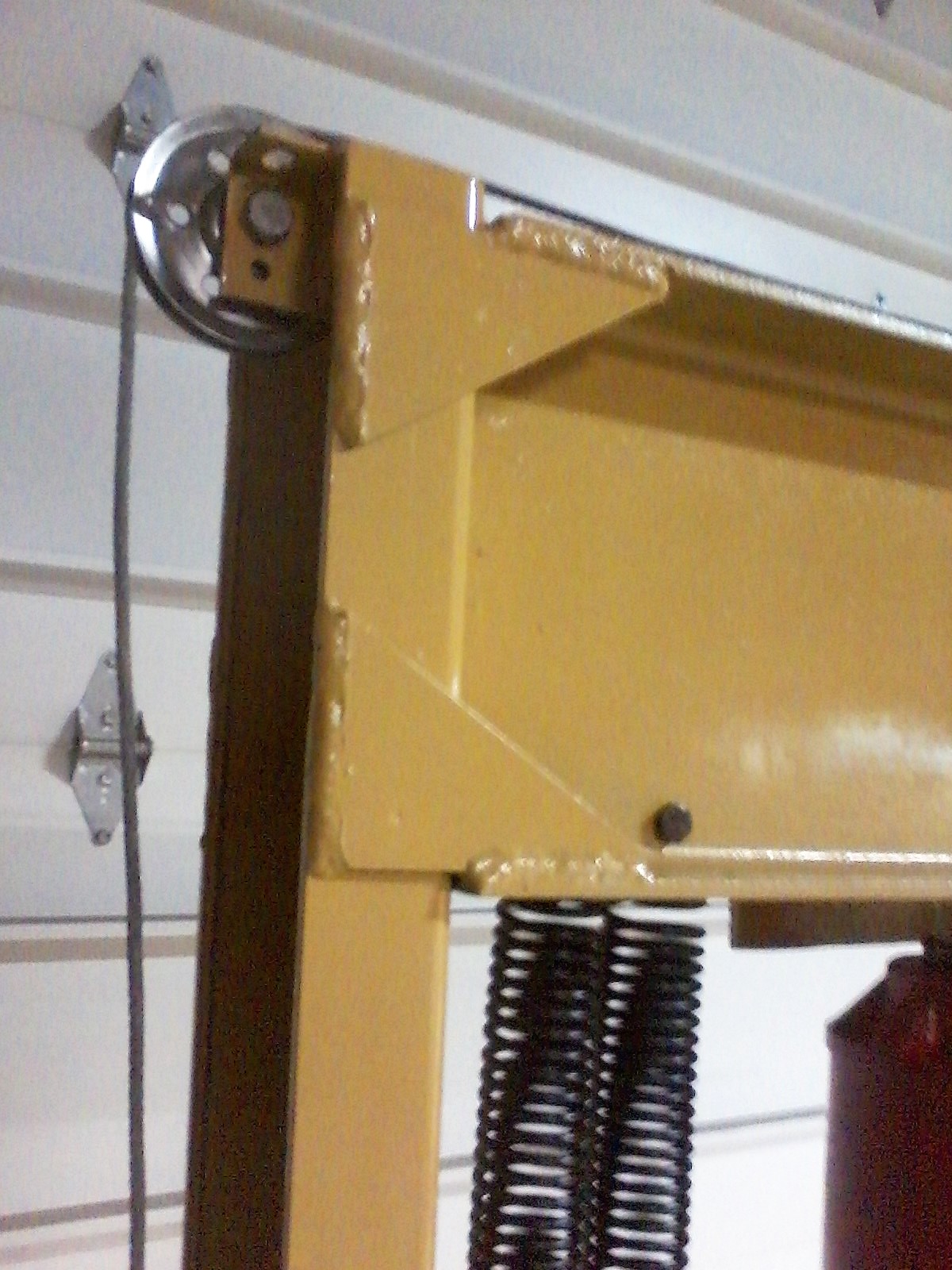

You mentioned boat winch and drums.
Here is a trick I used on my HF-
Mount the boat winch on one of the uprights so the cable can go straight down to the table.
Put a pulley (I used an old one from a comalong) on the other upright so the cable can go straight down.
Then clamp the cable to the winch spool with one side down and the other side to pulley then down.
When you wind, both cables wrap or unwrap and go up or down keeping table level.
HOPE THIS MADE SOME KIND OF SENSE???? But it works great.
Also swapped out for air jack and much better.
Plus I put extensions on the uprights so I didn't have to stand on my knees to use it.
Thanks for the idea Tim
Yes- that is kind of what i had in mind, but since the uprights are 78" tall thought it would be nice to mount the winch possibly a bit lower, so believe I may need to mount 2 guide wheels (1 on each end of the top piece) for the far side apron cable.
But otherwise just as you described- Really need to look at the winch and check out how it (feels) at different locations first.
Have a lot of work on the jack support 1st. but will get there.

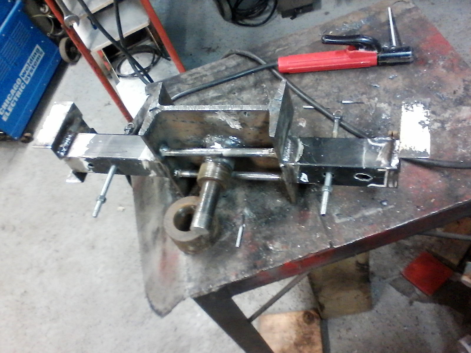

More progress - although had some setbacks...

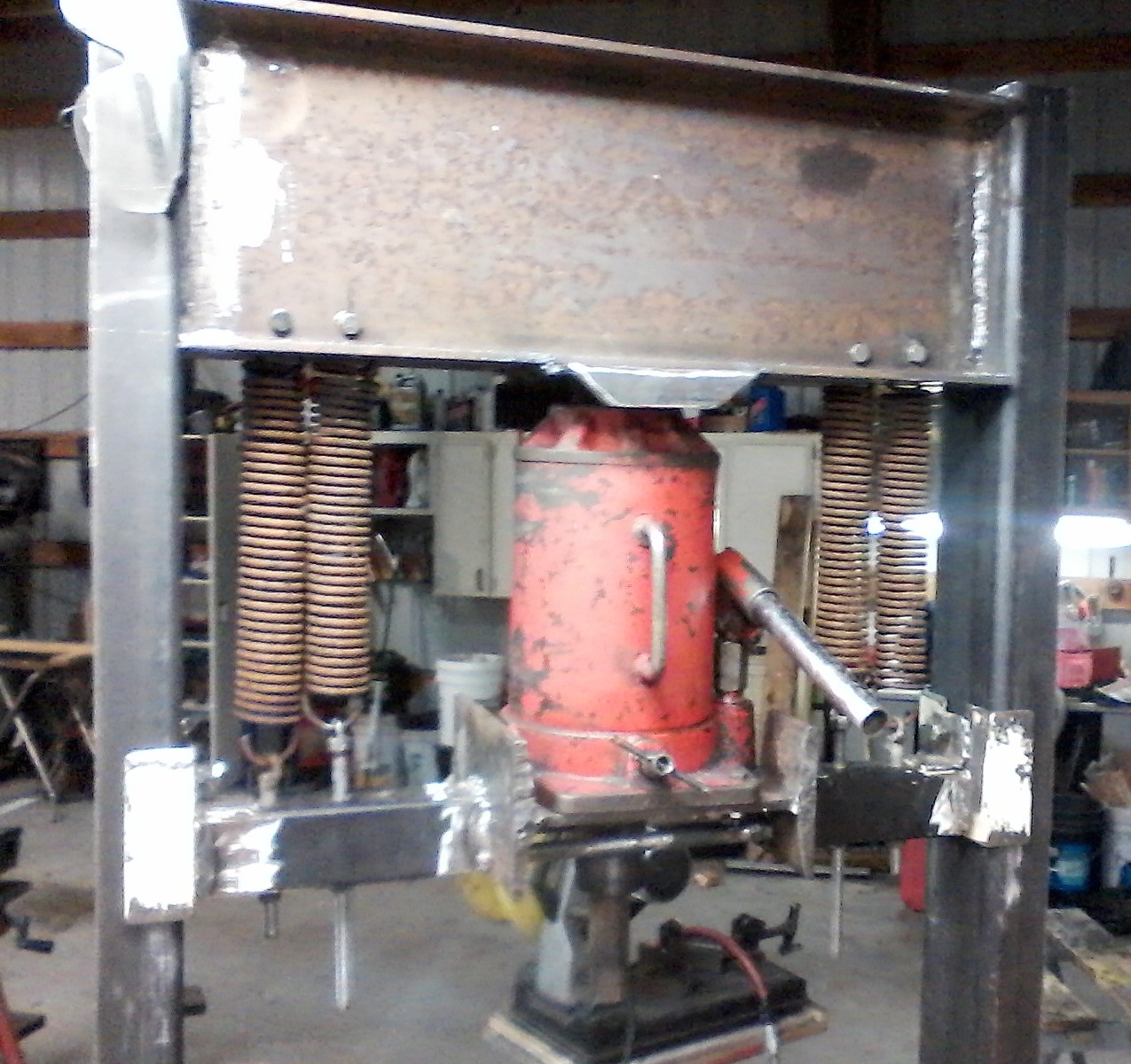

Got the springs cut from the garage door parts and bent the last coil for the top of the press using the torch.

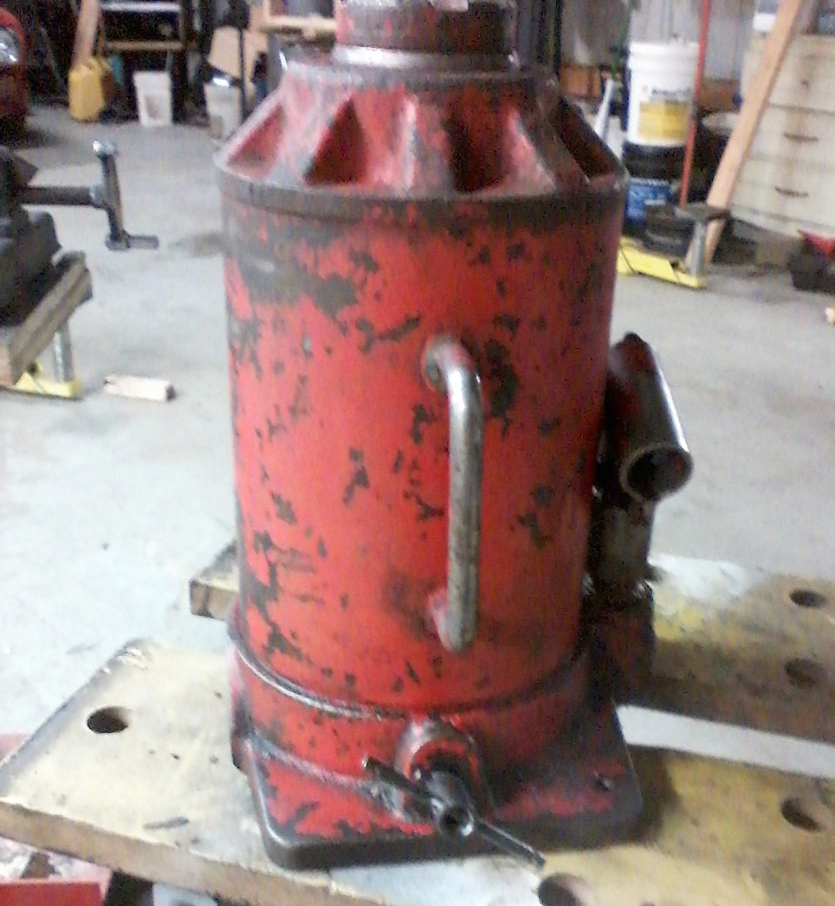

i made 4 thinking the old springs may be a bit weak for this jack, which I went ahead and drilled holes to mount on the carriage and tigged a small socket and bar onto the release valve so I wouldn't have to pull the jack lever out all the time.

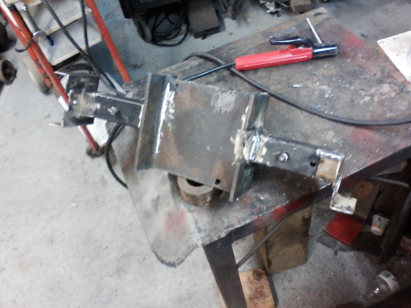

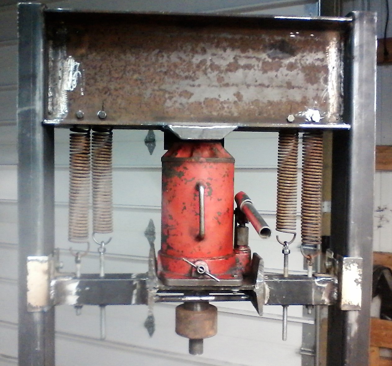

Built the carriage out of the last piece of 4 x 8" I beam that was left and used the plasma to cut out the side so the jack would fit then added the side square tubes cut from the weight set.
The guides for the carriage were more pieces of salvaged bed rail C channel. I added 5/16 bolts with nuts welded to the C channel and added lock nuts so the carriage side clearance could be adjusted.
Next made a C channel bracket that bolts to the carriage so that the assembly can be removed from the side of the upright frames.
For the press shaft used the weight sets center bar 1 3/8" steel welded to the I beam. The weight bar had screw on ends that seemed like they might make a way to add a longer attachment or other piece to the press So I welded it on around the 1 3/8" center.
Not sure if this will be of any use but what the heck why not:laughing:
Finally cross tied the threaded piece to the sides with some small round bar. carraige .jpgcarriage 4.jpg
Totally mis drilled the holes for the spring tension adjusters:confused: built them out of 3/8' thread all and chain links cut in half and welded.
here is the carriage and jack assembled in framecarriage test fit.jpgpress test fit.jpg
It's ugly (especially the I beam jack support ends) but will do some clean up grinding...
getting closer to a usable press , next need to add the apron lift

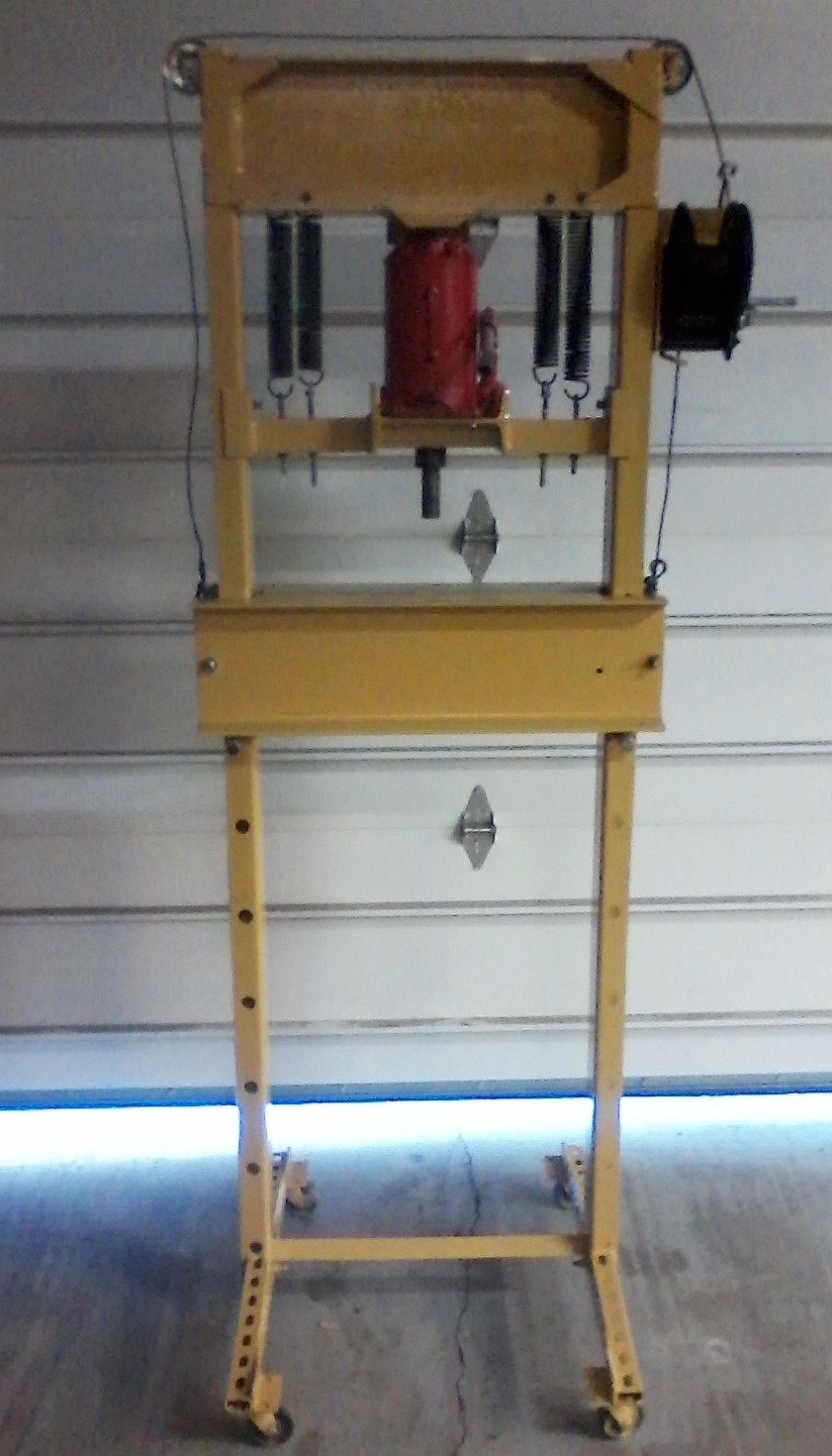

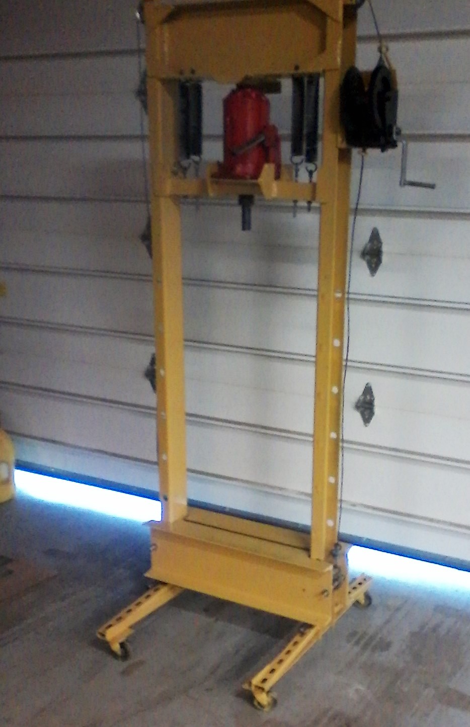

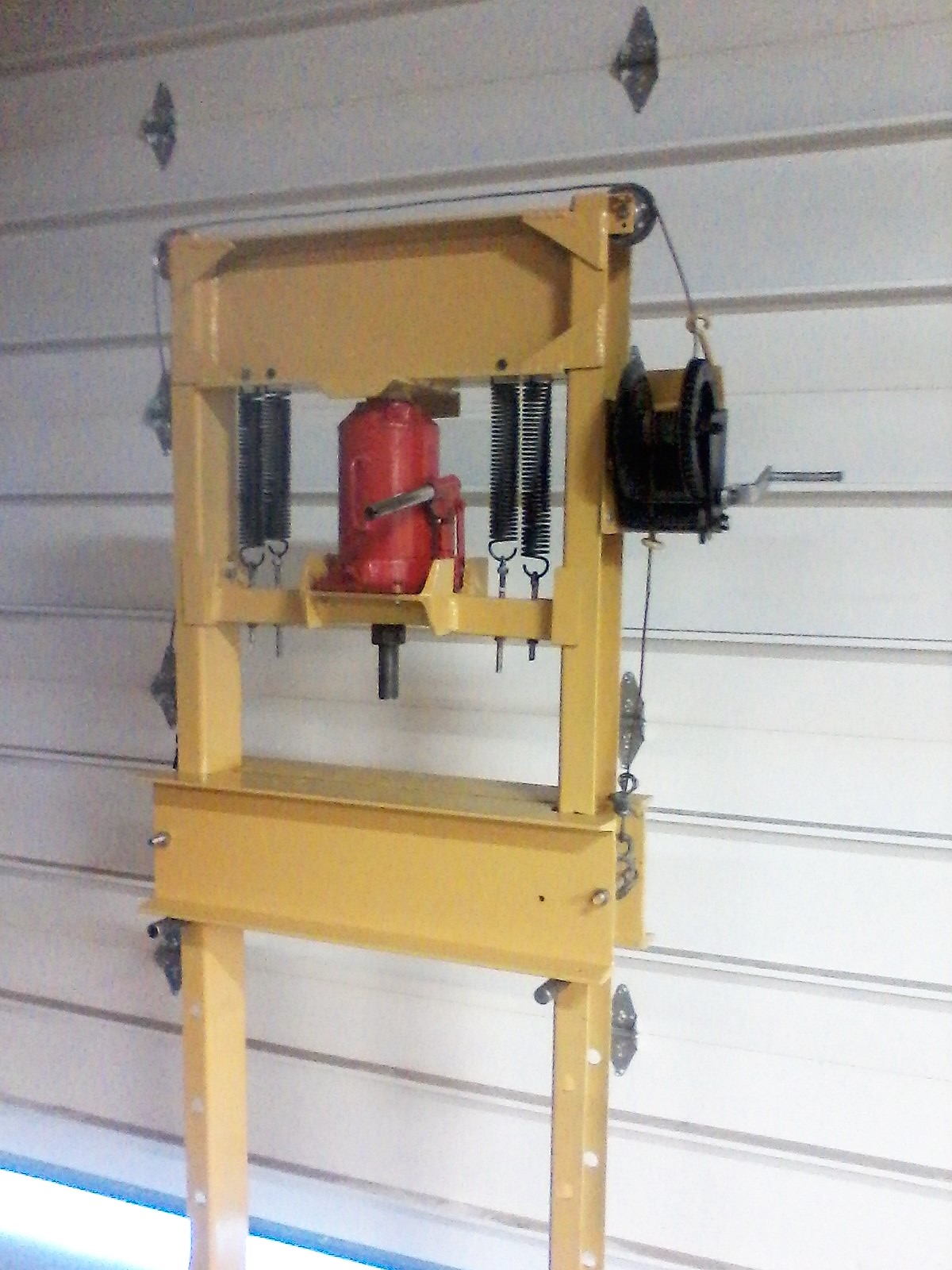

More progress

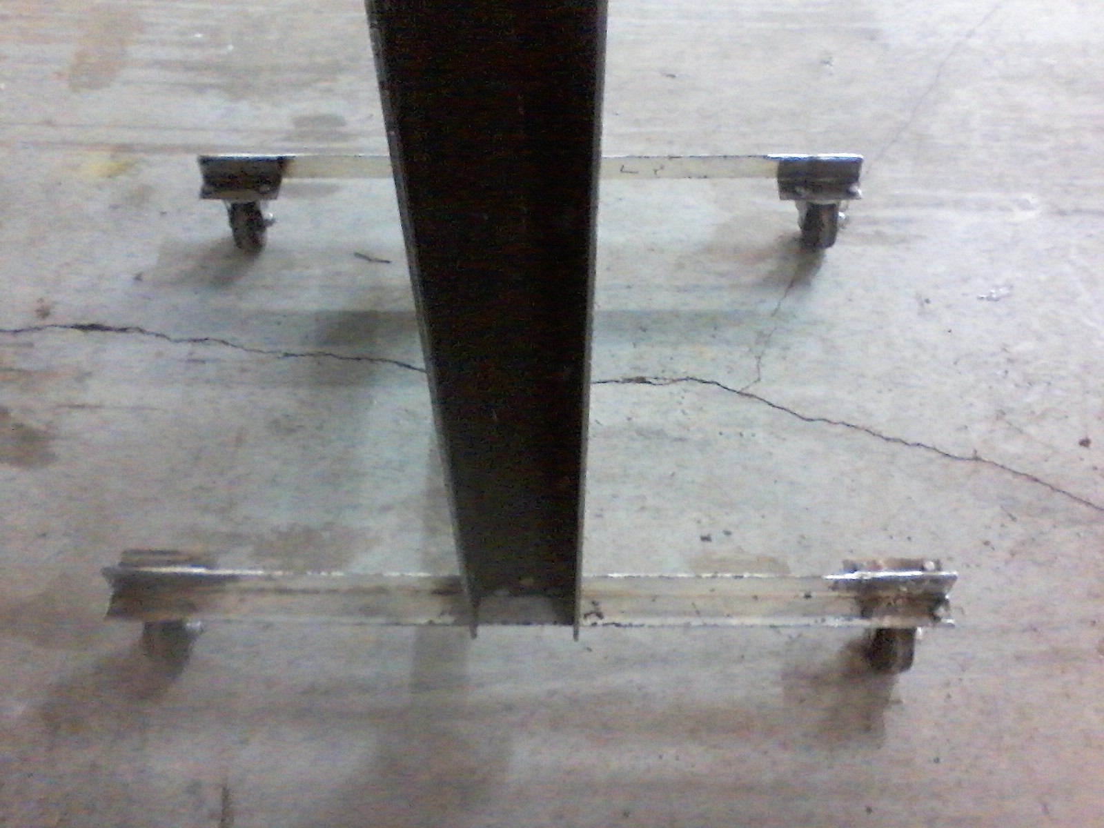

dug out the old boat winchwinch 1.jpg The handle seemed way long so I shortened it a bit made a side bracket to mount it to the frame
I added some corner braces to the top of the press frame and also plug welded them.
Cleaned everything up and used some Caterpillar paint I had saved
May do some more mods in the future-
but for now calling it done
