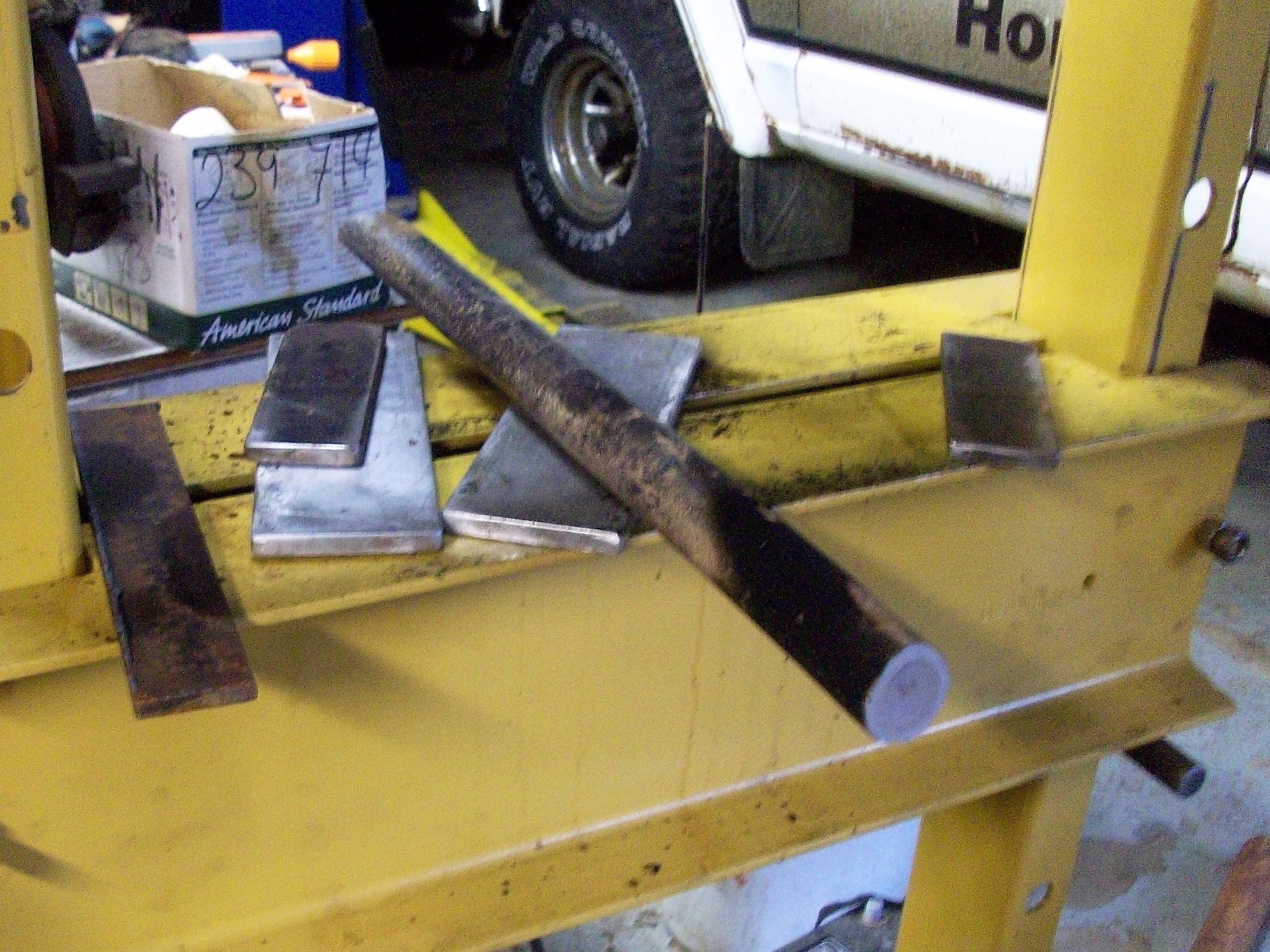

Press update
Bent a 1 3/8 grapple tine trying to pry out a stump .
Thought it would be interesting to see if the Press could bend the round tine back.

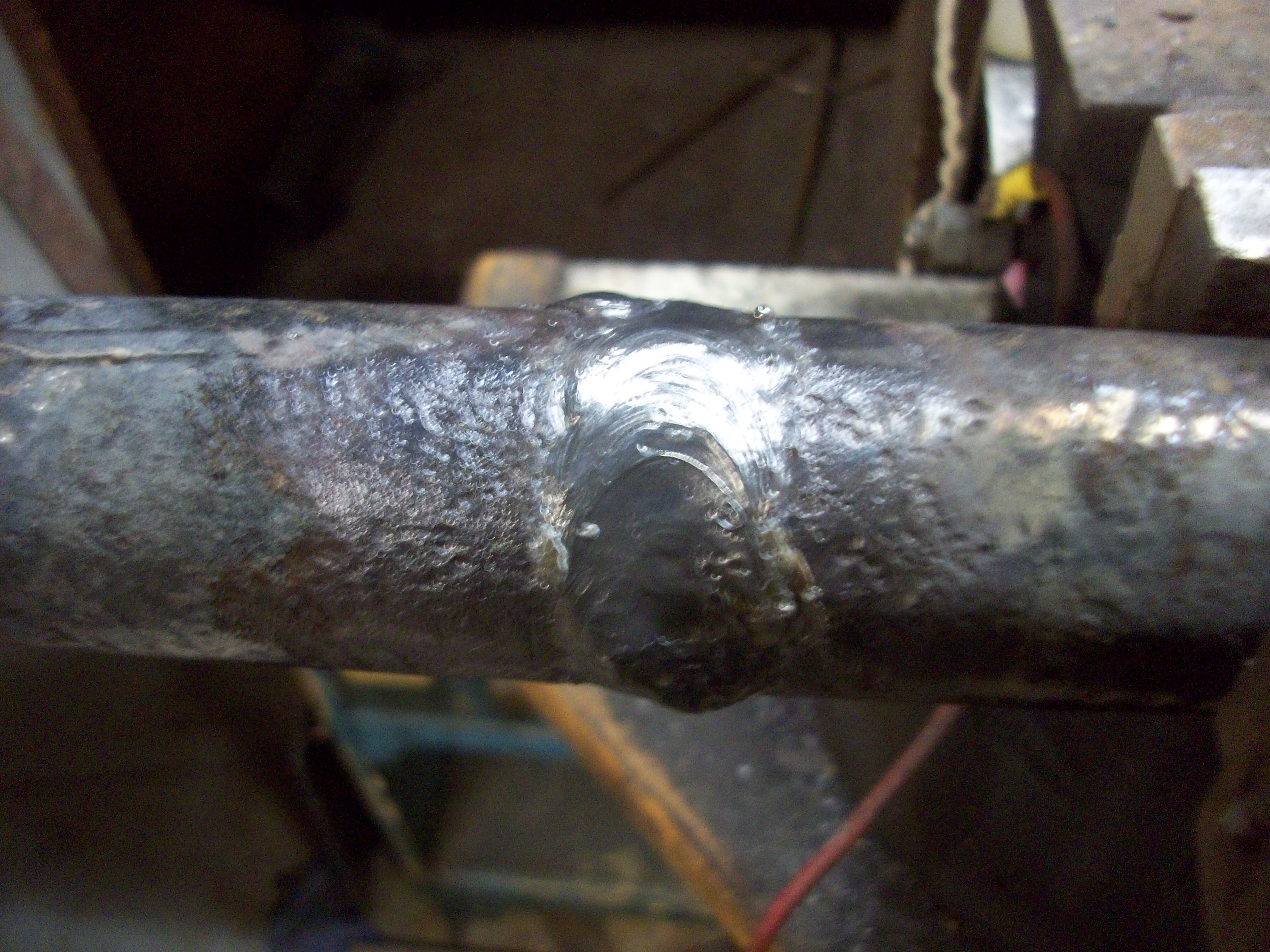

Took the rose bud to it for a while and started applying pressure...
the result
guess I didn't heat it enough :laughing: but the press worked
figured since it was already broke why not practice some stick welding
Beveled the edges and left a small gap 6011 3/32 for a root passes and then
2 passes with 1/8 7018
final pass with 5/32 7018
Won't use that tine with a sling but should work for cleaning up brush and horse stalls
