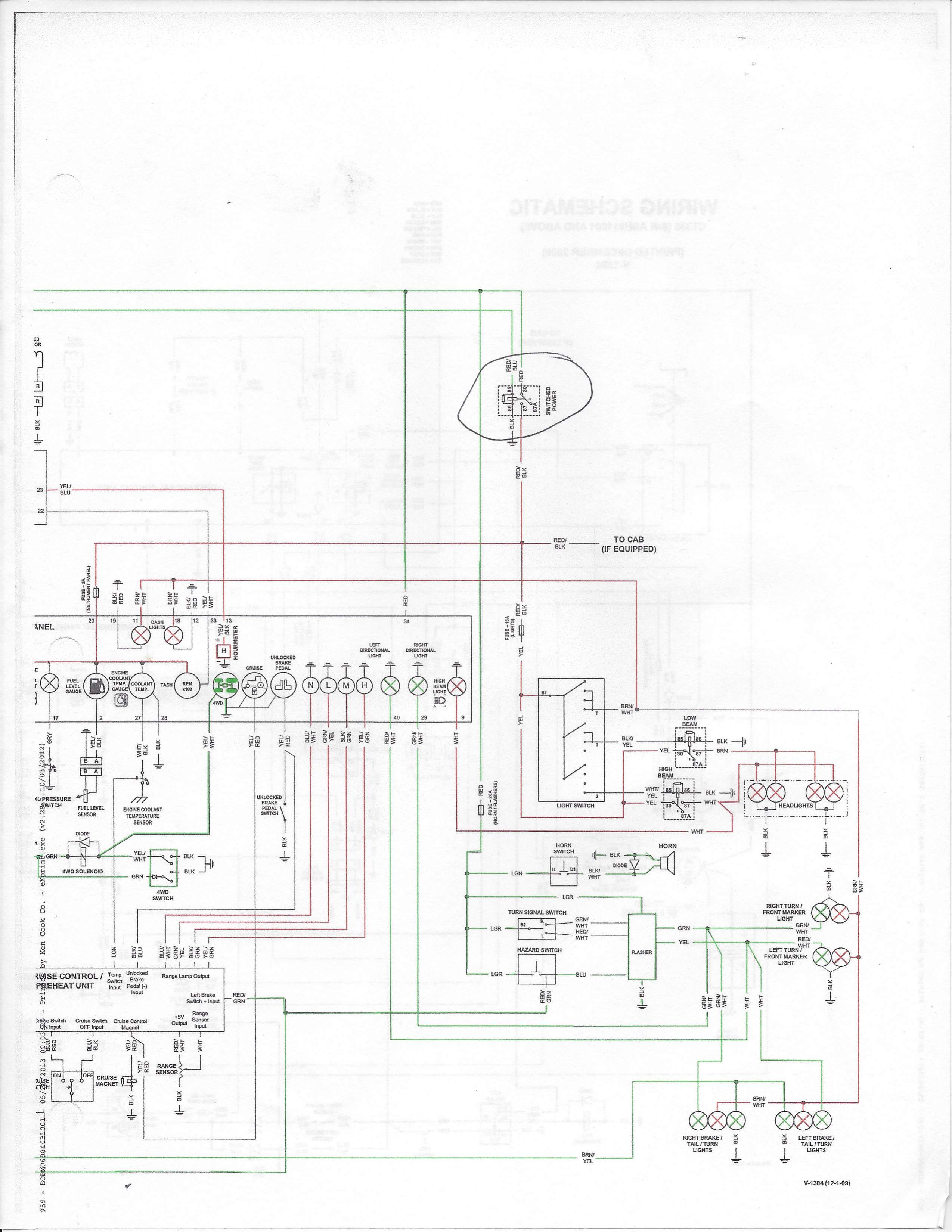

I'm having an similar issue with my 2011 ct235. No headlights and the tach/dash worked intermittently and finally quit. Does anyone have wiring diagram? The dealer gave me a parts breakdown that shows all the relays but none of look like they relate to the dash. Thanks.
I'm having a very similar problem on 2013 CT235 Could someone point me in the right direction and which relay I should be looking and replacing? Anyway to determine it is the relay by troubleshooting? I have checked the battery and ground connections and this hasn't helped. Thanks in advance!

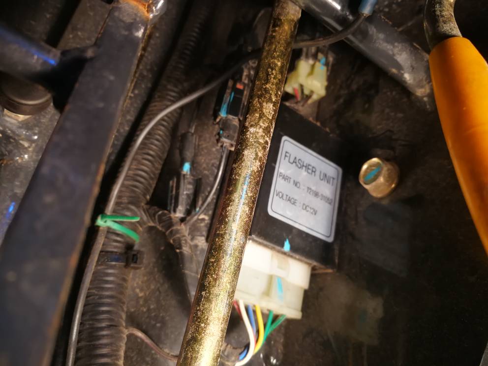

I assume this is it? Directly above the Flasher Unit on the left side beneath the instrument panel shroud. IMG_20190626_102951.jpeg

I assume this is it? Directly above the Flasher Unit on the left side beneath the instrument panel shroud. View attachment 610536
Can not make out wire colors in the photo, 4 wires at the Switched power relay are Black (grd), Red (battery), Red/white strip (switch input), Red/Blk stripe (out to dash & lights).

Ok, just got home but I'm seeing Black, red/black, what looks like red/Grey (unless that's dust on it but I cannot reach it, and another right rear rust just looks black from this angle and I really can't get to it. That's a nylon nut holding the relay up there and I'm sure I can get an angle wrench up there if need be, but at the moment the issue has repaired itself.

My CT235 acted similar to this about a year ago. It was an intermittent problem for a long time with same symptoms. After while of troubleshooting I was able to locate the problematic relay under the dash on the right hand side of the tractor near the fuse box. The relay was not under the hood, but was located under the ignition near the fuse box. On the electrical schematic diagram from the repair book the relay is labeled as the "switched power" relay. In other documentation including the repair book and on bobcat parts it is labeled as the "ignition" relay. Go to bobcat parts online to the Electrical System 2 Group which shows the problem relay as item 13, G: Ignition relay. I was unable to post the link.

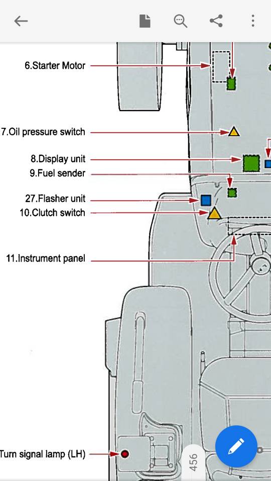

This might help you with some locations.
/ Tach/Electrical Issue #75
That's great, if I could find it. That Ignition Relay, is that hidden up behind the shroud surrounding the gauges and accessible from the engine side or do I have to disassemble the dash to get to it?

Will look there as mine has begun acting up again. I am also unable to determine what exactly that 20A relay is on the left side under the dash above the flasher. The workshop manual for the CK35 I have doesn't even show a relay as being there. View attachment 612116
Kioti electric and Bobcat electric are different. That's why the CK35 manual is no help. As far as I know everything else is the same.
