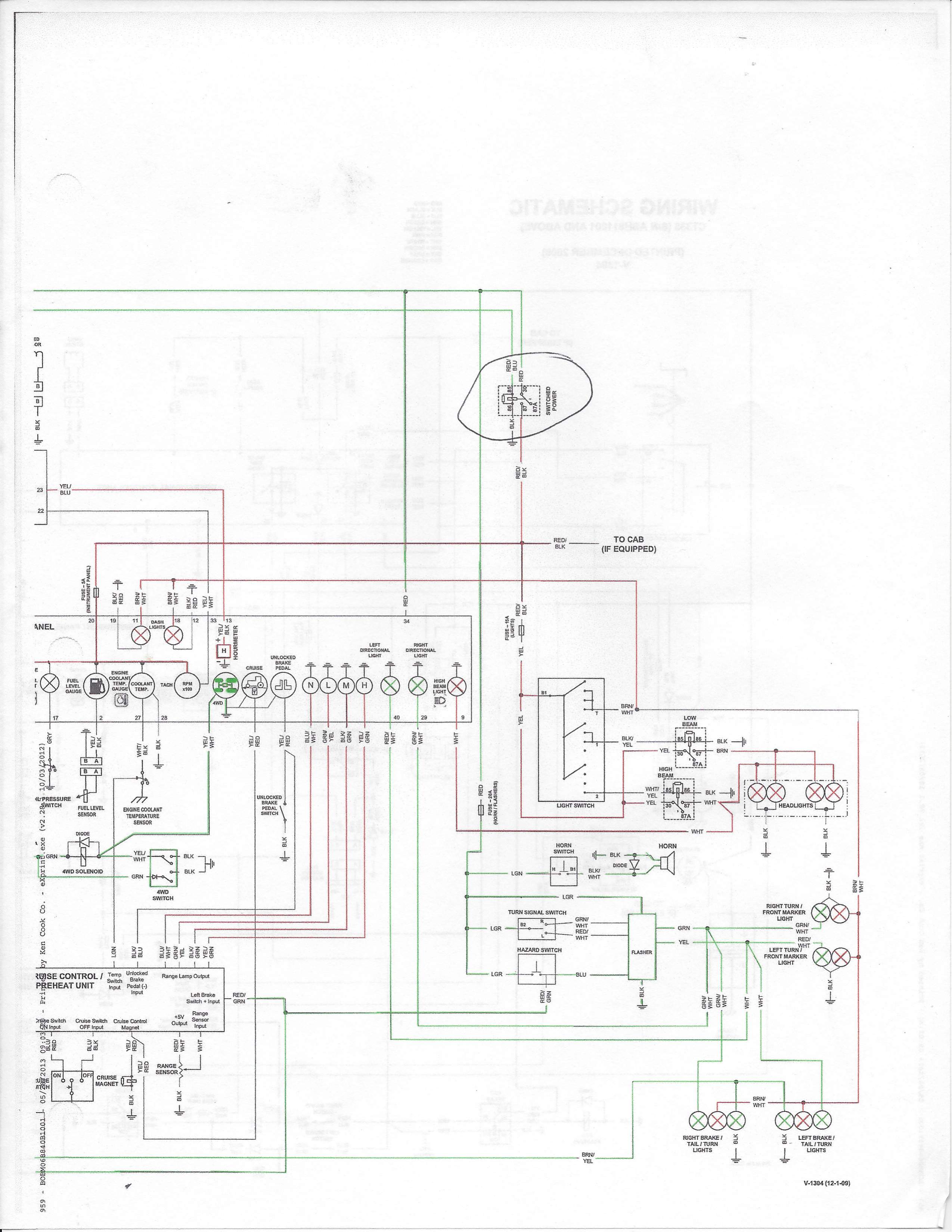

Bobcat dealer showed up this morning and found the problem - a failed switched power relay, which
supplies power to most of the instrument panel, headlights and tail lights.

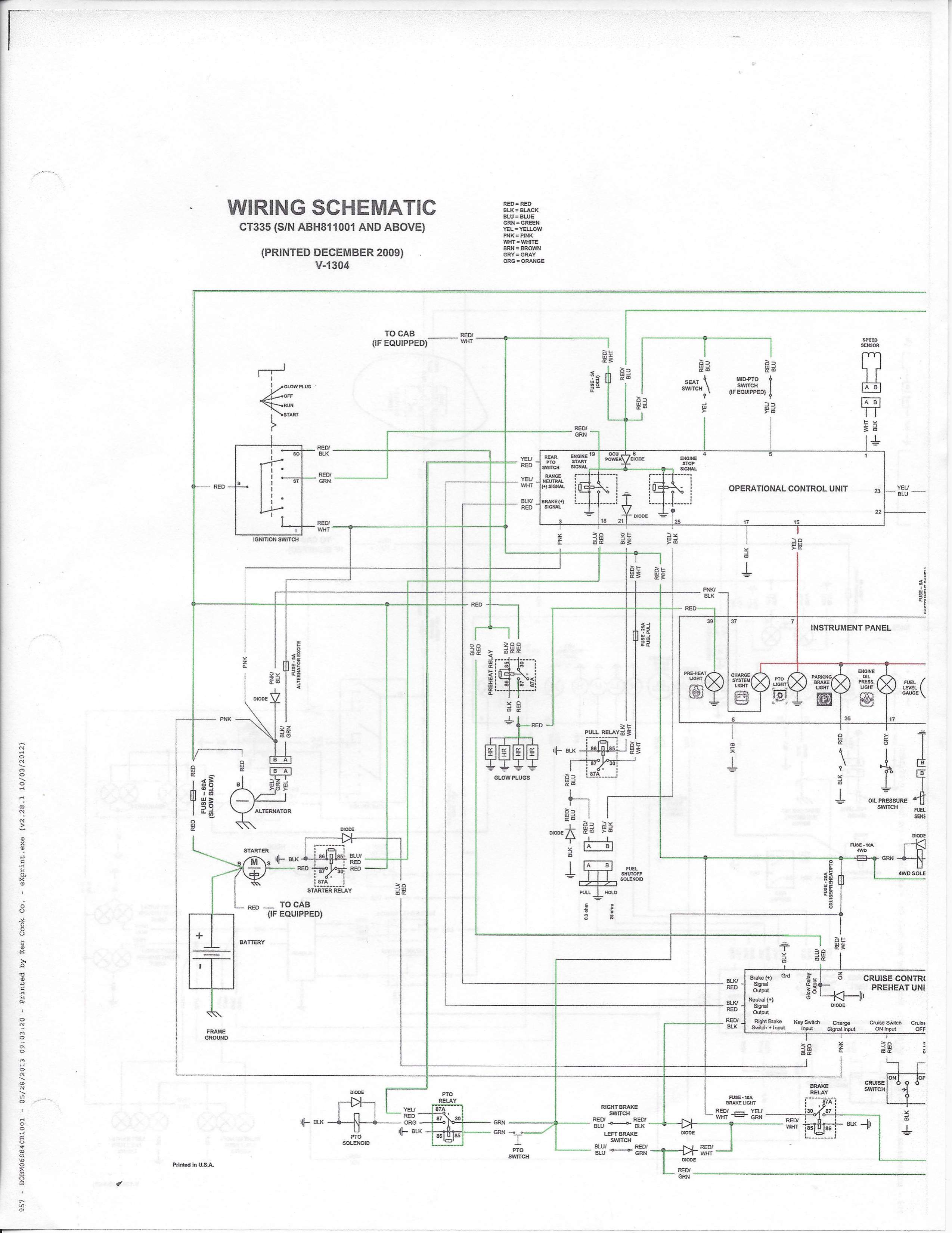

Is that the one located on the engine side of the firewall? Looking at the drawings I got from my dealer. There is one next to the starter relay, and I think one behind the dash.
edit: found the one on drawing, Electrical System Group 2,
Model: CT335
Serial Number: ABH811001 & Above w/Cab
I know there is more behind the dash unit, but I don't have a drawing for that.

It was the one on the engine side of the firewall. If I can get to it, I'll post a photo
of the firewall with the replaced relay pointed out. On the electrical diagram, the
relay is described as the switched power relay which (I think) must be the relay on
the far left of the firewall panel, labeled in the manual as the ignition switch relay.
A little confusing.

I've attached the schematic diagram of the CT335 (two photos) with the
relay in question circled on the 1st photo. The red lines indicate where
there was no voltage when the ignition switch was turned on.
