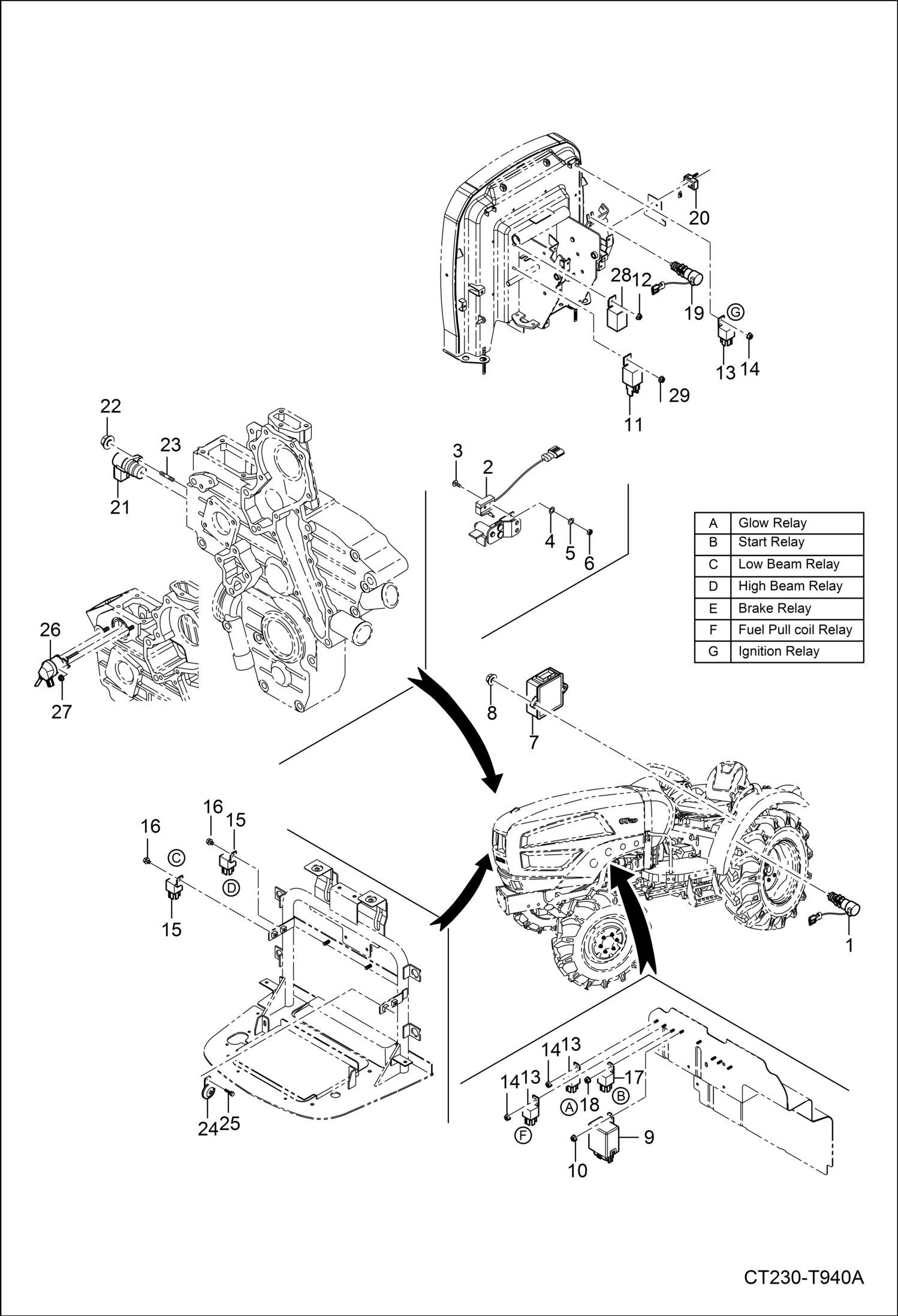

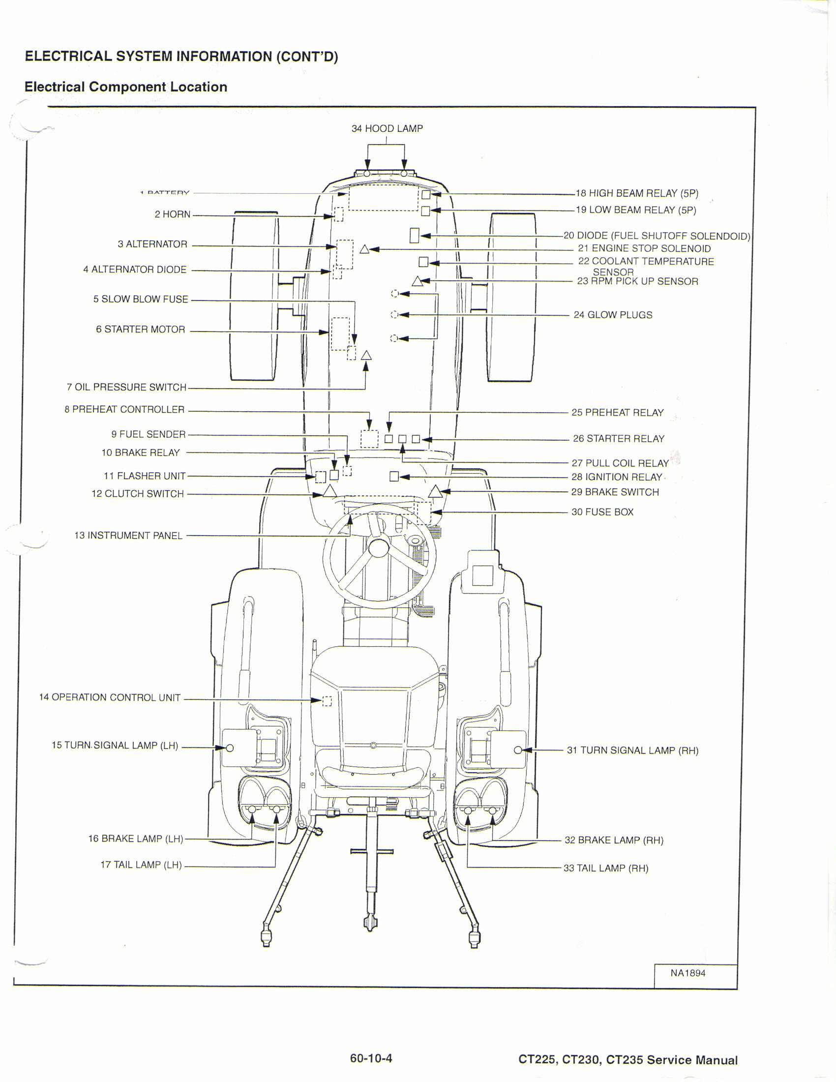

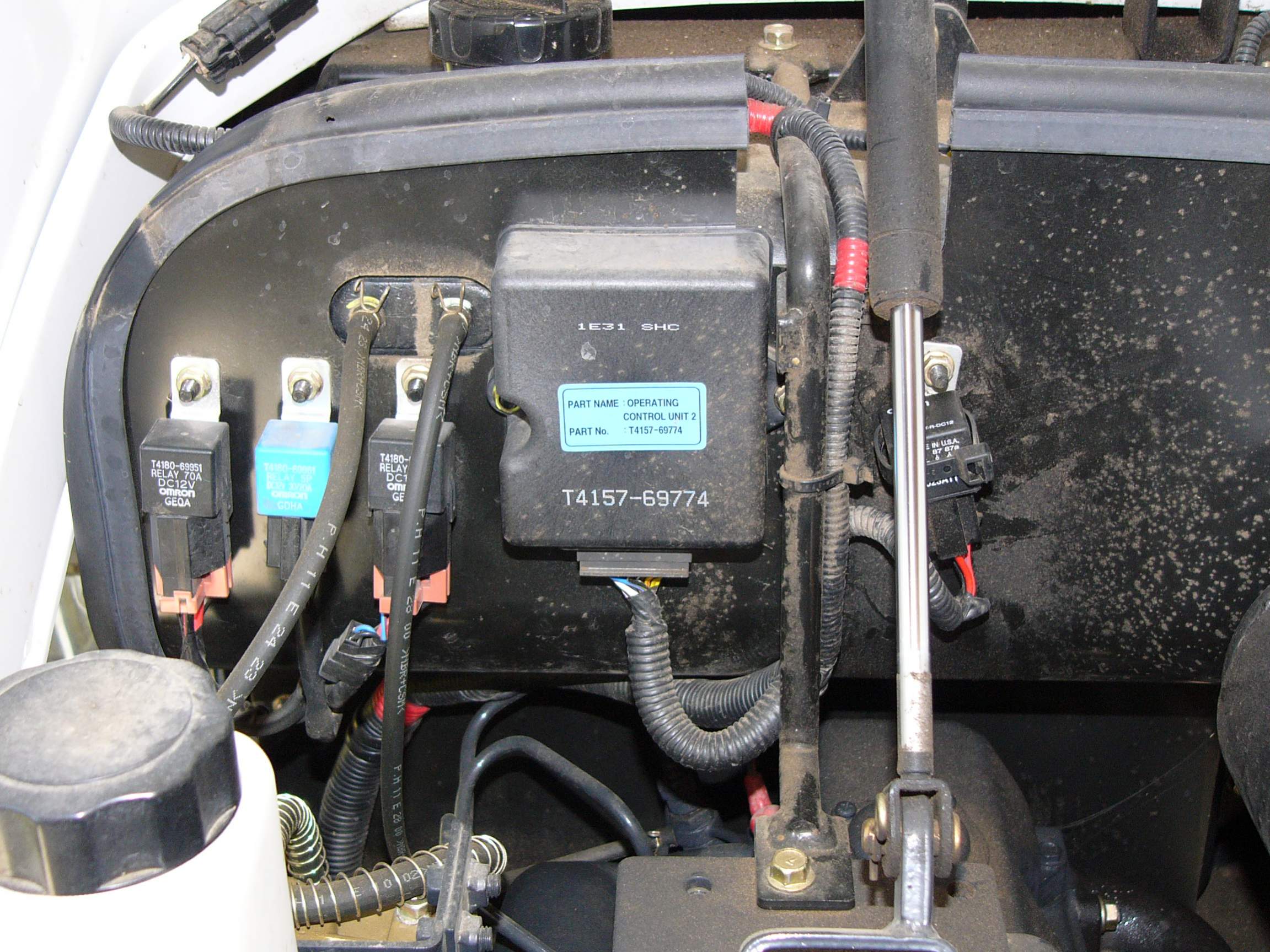

I have a ct230 same issue which relay was it there are a few on the backside of the dash under hood
/ Tach/Electrical Issue #108
I'm not sure if your engine compartment layout is the same as mine. In the attached picture, it's
the first relay on the left. The attached diagram describes it as the ignition switch relay.
View attachment 403101View attachment 403102
mine does look like yours Thank you it is the 1 on the outside left #1 on parts page. I will order it. First I will check power coming off when it happens. My ignition switch has also been frozen given the angle of the switch, don't know if that has anything to do with it either
