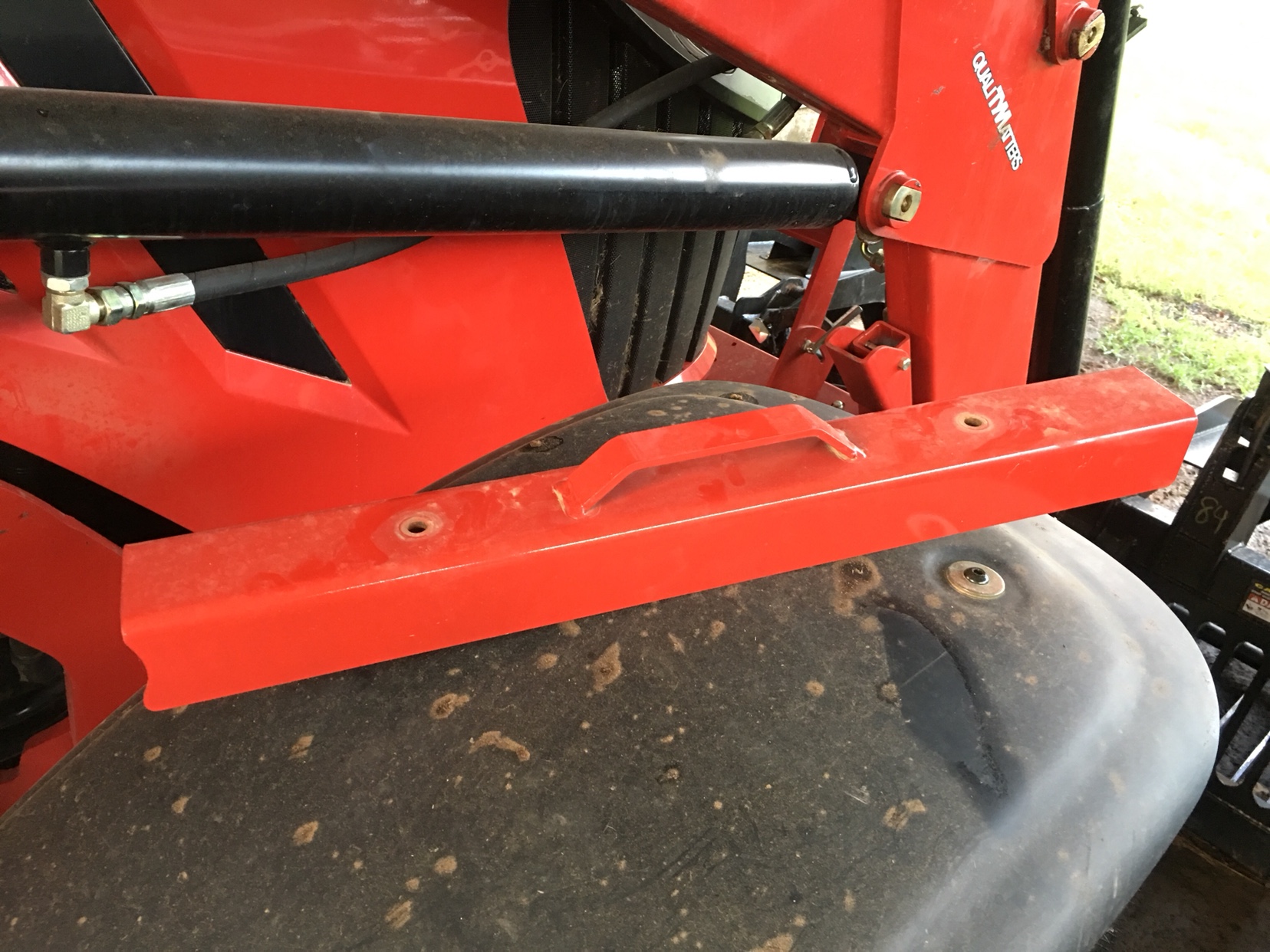

Hey Brown! No, not the self levelers, the small bars on top of those. IMG_1869.JPGIMG_1870.JPG
These are secured on top of the leveler arms to provide a safety stop for the loader when fully raised. Notice the left end, it’s shaped to fit around the cross pin and the cylinder end is flat.

Hey Brown! No, not the self levelers, the small bars on top of those. View attachment 566803View attachment 566804
Splithoof is right. If your loader does not have these, you need to get them ASP.
Anytime you are working under a raised loader, you need to use them. It one of those things that may only happen once in a 1000 times, but if it does happen, you are dead.
I never even saw those. Yes those are really nice to hold the loader up while you do work.
