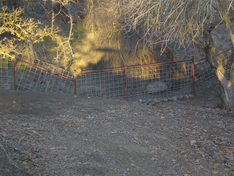

Yeh, it's a handy little dude. 2" (pointed) pipe is working it pretty good in cobblestone and willow roots. This pic is of my little creek crossing. Sure glad I shot that line with my total station cuz the old fence was off 4' and I'd sure hate to do that job again if I wound up with a nasty neighbor.
(Howdy neighbor Rob, no poelice on a private road around here :D

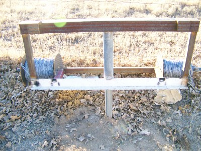

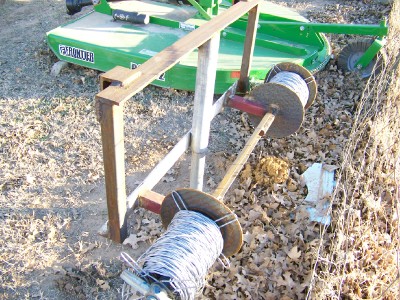

Well seein this come back up. Mine did work well with FEL.
/ T post driver #34
I recall the rig, and comes in handy in more ways than one.
We have always set our corners, then string one run of barb wire (if barbed wired fence) and stetch it. We then set the posts next to it with the FEL. We have some hard soil (heavy black land) and do tend to bend some posts but they can be staightened and moved further down. On those we can't get, we use the driver or sledgehammer.
One thing about setting 10 posts in 6 minutes with the hand driver is my tractor never gets tired. We've run a 1/2 mile to mile of fence a fence in a day settings posts once and if we had to do that by hand we wouldn't have been worth a plugged nickel the next day.
I've seen an attachement on the bucket similar to John D's with a pipe with a large flange on bottom. You slide the t-post in the pipe, set it down with bucket and push it in. The flange keeps it from going deeper than needed. The pipe also keeps the t-post from bending.
