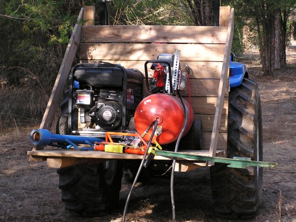

It came from Rohrer Manufacturing Inc. :: Fence Post Drivers and Supplies They had a delay in sending it - I don't remember why - but they contacted me right away via email telling me about the delay and asking if I wanted to wait or get a refund. I waited - there wasn't any hurry - The instructions tell you to get a firm grasp on it when you flip the valve up -- they aren't kidding -- The 2 problems I had with it were 1. holding it well enough that it didn't go nutz (small learning curve there) and 2. stopping it quick enough so the post is at the right height. It wanted to drive 'em clear to the bottom in nothing flat. This pneumatic hammer doesn't so much as pound ........pound.........pound.........as it does poundpoupoupoupoupoupound.... and you better be ready for it.:eek: :D .... The "blue beast" is my manual driver with a weight welded on top. Worked really well 30 years ago -- don't werk so well nowadays...:mad: :( .... The pnuematic one is yellow & orange and has a t-post sticking out of it.

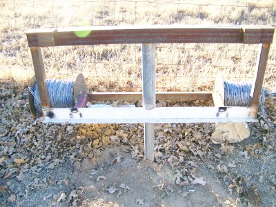

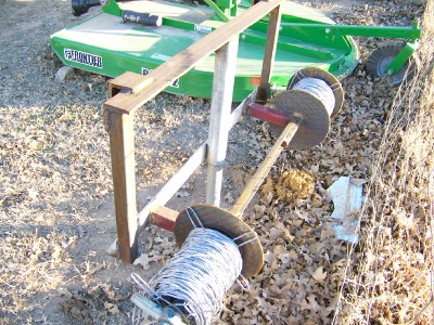

Well seein this come back up. Mine did work well with FEL.

I recall the rig, and comes in handy in more ways than one.

I've seen an attachement on the bucket similar to John D's with a pipe with a large flange on bottom. You slide the t-post in the pipe, set it down with bucket and push it in. The flange keeps it from going deeper than needed. The pipe also keeps the t-post from bending.
