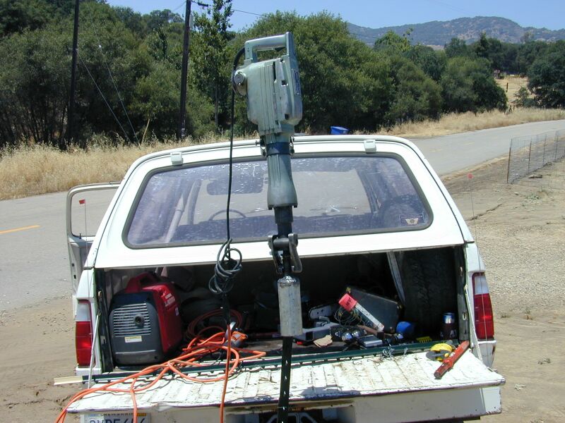

I almost bought the air driver but wanted the model that would drive 2" pipe, which was getting into too much $ for a single use tool. Instead I got a Hitachi 40# electric demo hammer off eBay for $300 and made a driving sleeve like the air model. Works good :)
/ T post driver #30
My hat's off to you. Good thinking. I do like to have multiple use tool rather than single.
