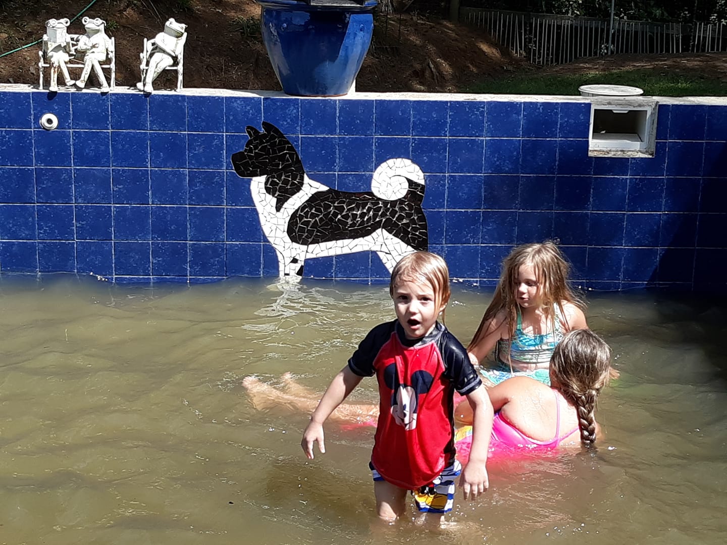

Whats the construction material you used for the pool? Natural or man made? Tiles, glass, porcelain do fine in saltwater pools.
Filtration systems are the key to any pools blissful operations. Make sure you have a quality saltwater pump and you will be fine.

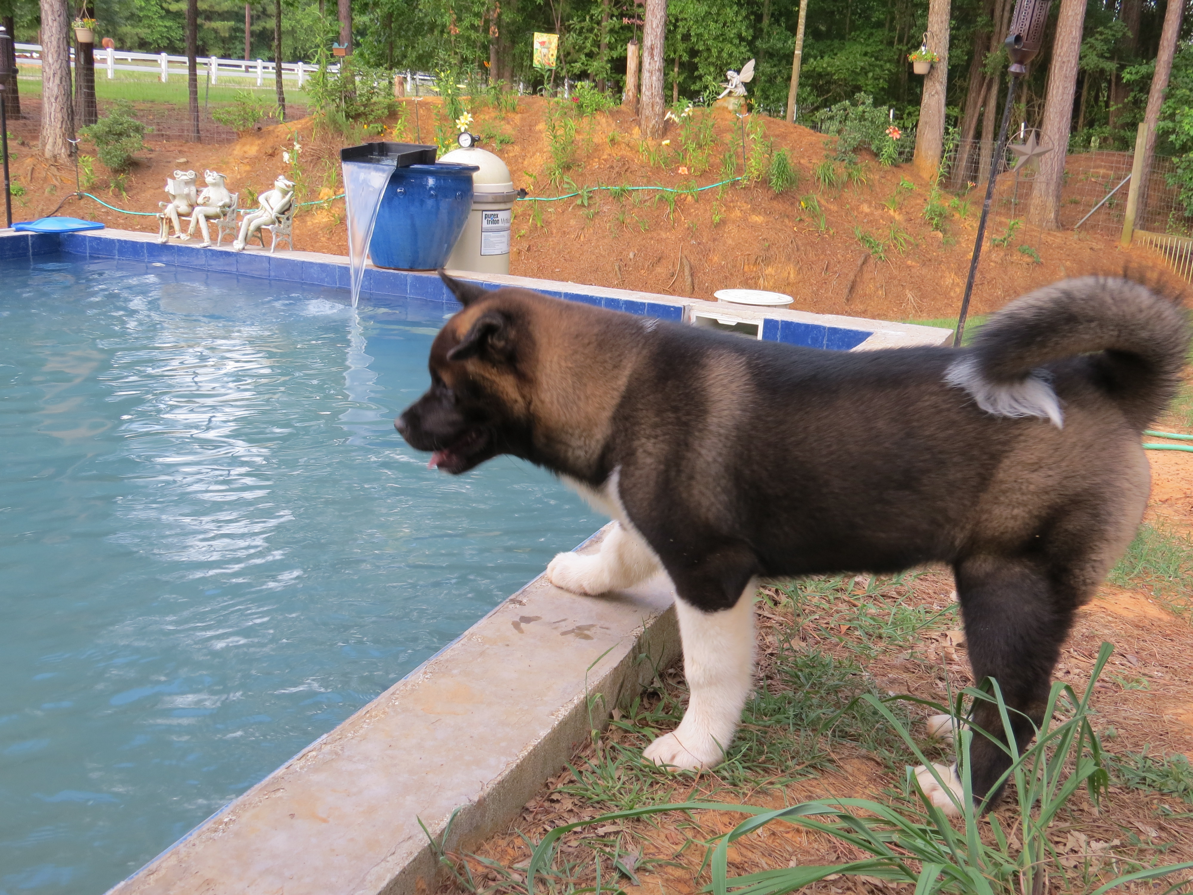

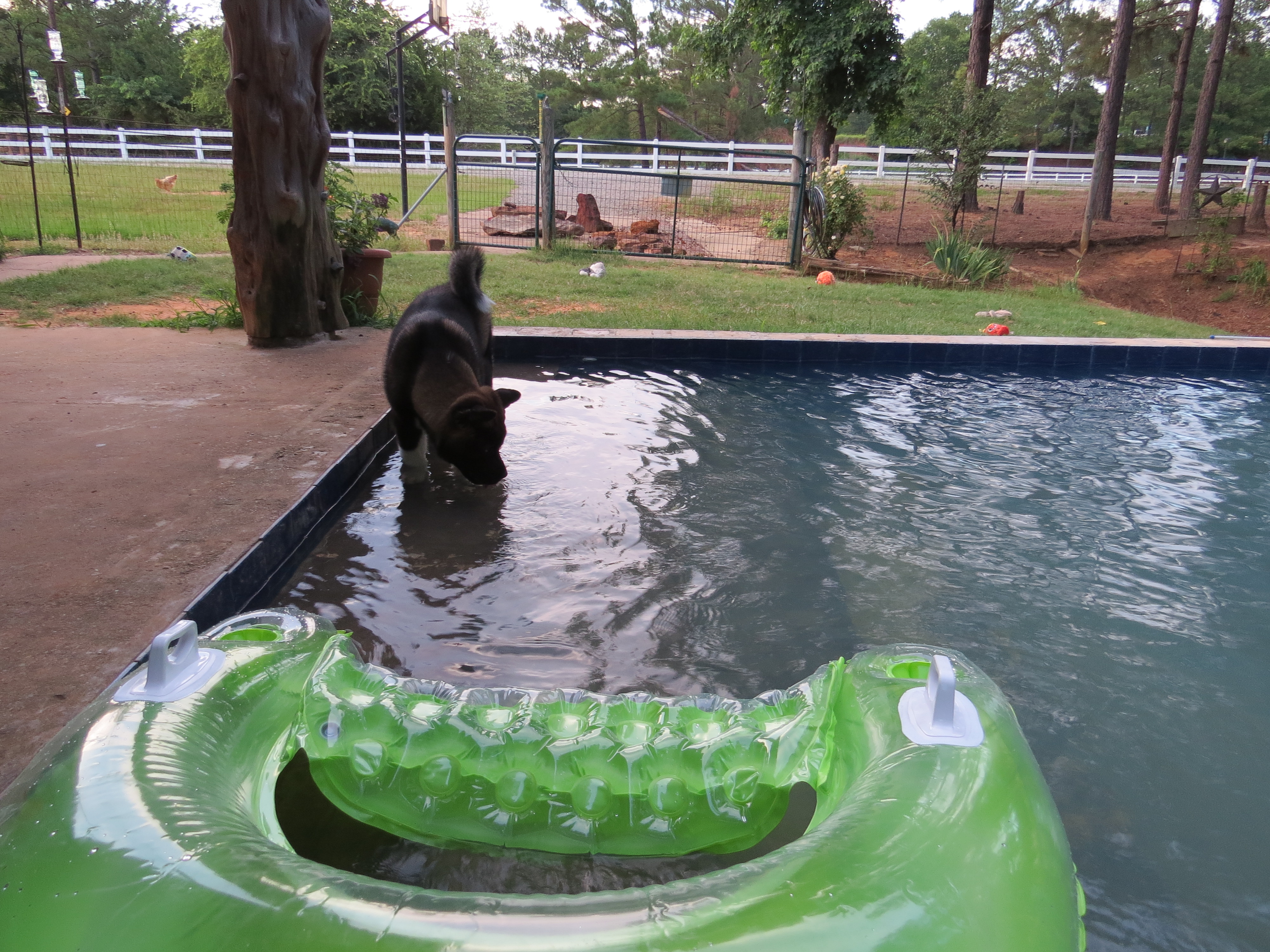

I hate to say it you need to change her way of thinking. Tap water probably has roughly the same amount of chlorine that you would have in the pool. If you control it they won’t be hurt. I can see in the pics it’s a standard pool setup, skimmer and filter. We had a pool for several years and the only time I had problems was when I didn’t pay attention to the chlorine level. I just used the cheap test strips but you can get test kits that are better. I know you are looking for an alternative but I’m not sure if a good one exists or not.
