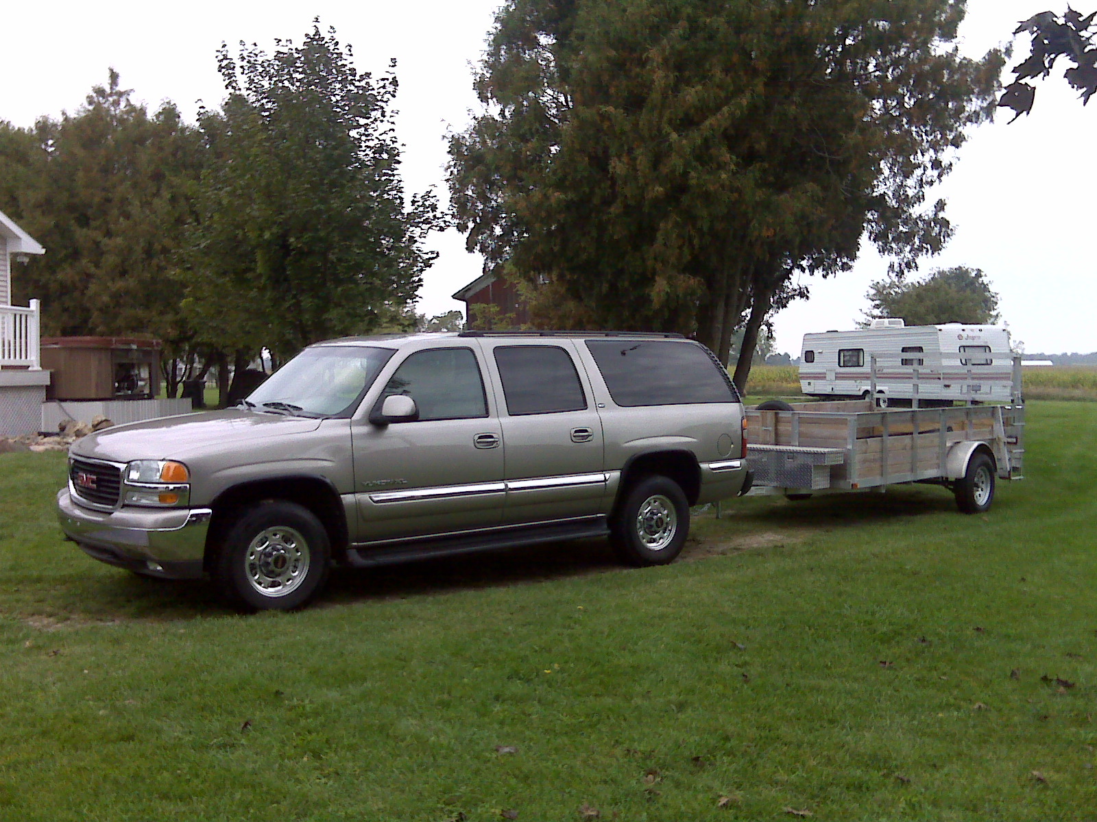

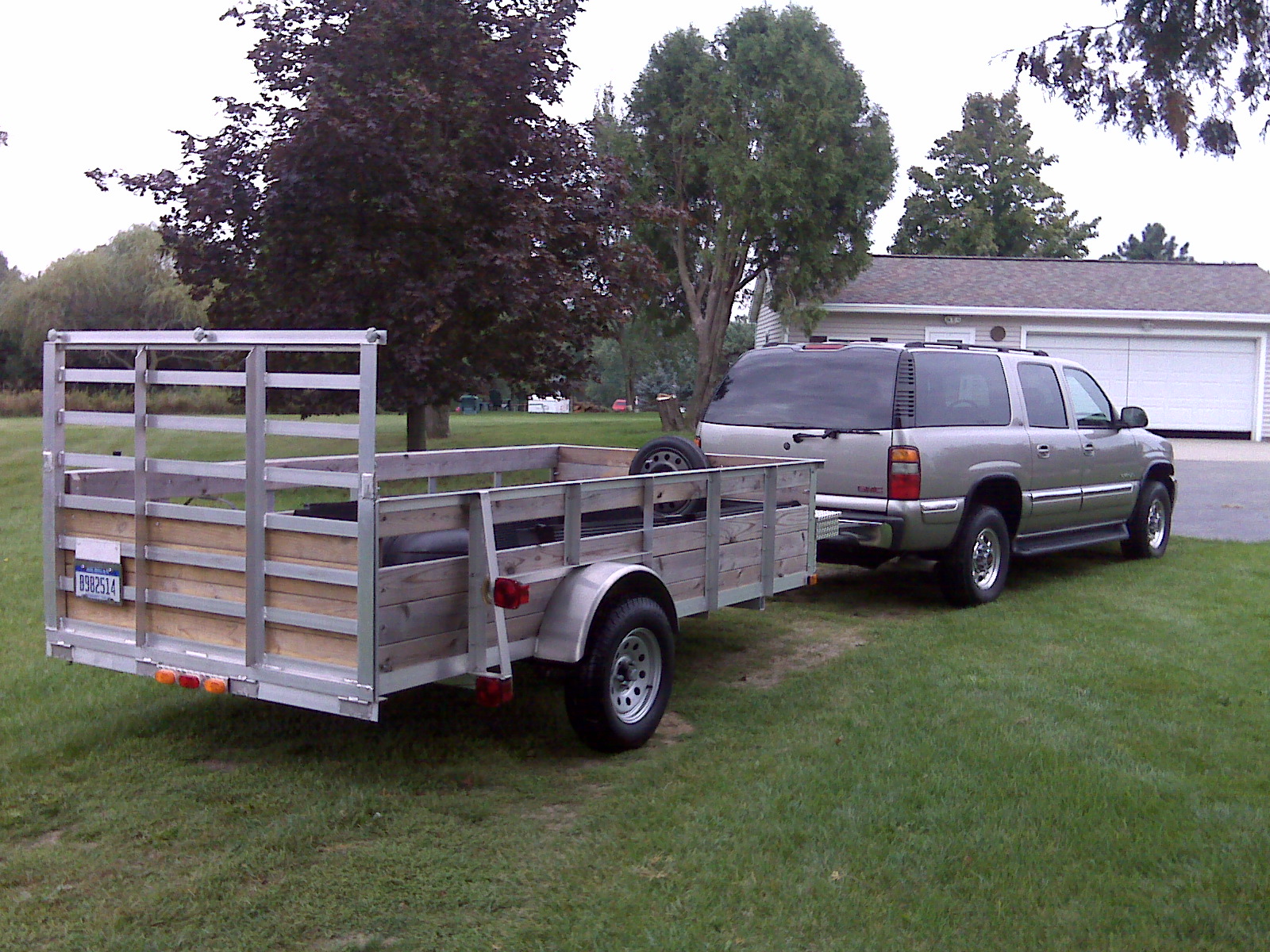

Nice trailer, but what does it weigh? If your Jeep can tow 7200 pounds I hope you are not planning to put 7000 pounds of cargo in the trailer...hmmm...trailer weight alone would be about 2400 pounds? Just guessing. And if you say you need a brake control and hitch, does your Jeep already have a factory receiver?
1900 lbs so I can haul up to 5,000 lbs-probably will never go above 4,000 and my tractor is 2700 lbs.
/ SUV vs. Pick-up #57
We have the Jeep Grand Cherokee. It's fine hauling a couple of 4 wheelers or the Kubota RTV900 (1800#) on a light trailer. No way would I put a 2000# trailer with a #5000 tractor on it behind the GC. But then we didn't buy it as a hauler, that's what we have the dually pickup for. We just need 4wd to get up our driveway.
I would think the classic type Jeeps would be even worse tow vehicles.
Ken
My tractor ways 2700lbs, and any load that comes close to 4000lbs would be local only. I have towed 2 pallets of pellets before with no problem. I dont want a monster truck sitting in my yard-doesnt make sense to have one for the amount of time I need to tow heavy loads.
The trailer will mostly be used for landscaping and home improvement only.
Later I will be buying a 24' to 27' camper for towing as well. The Jeep is capable-it has a longer wheel base than the prior model but I know I will have to be carefull and maybe make a few mods.
The great thing about buying a trailer like this is it's not tied down to any one vehicle. If I get rid of my Jeep tomorrow-I still have the trailer for the new vehicle.
