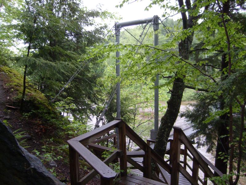

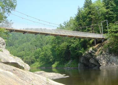

The actual walkway is made up of composite boards 1 1/2" thick. They have two PT 8' 6"x6" posts used to support the load between the i-beams. They are about 36" apart. The composite decking is sandwiched by a PT 8' 2"x4" and 8' 4"x4" on each end.
footbridge4_zps6f459403.jpg footbridge11_zpsdb04b123.jpg footbridge10_zps552a1903.jpg footbridge8_zps3792637f.jpg
/ Suspension bridge design #22

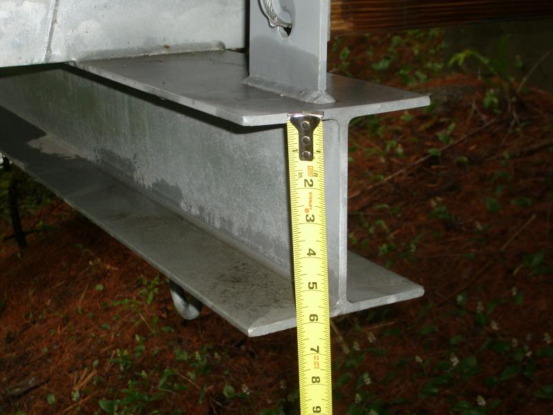

The i-beams are "S" beams, I would have expected "W". I think they are posts for guard rails and are 5' long.

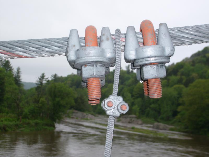

The ends of the two 1 1/4" cables are anchored to ledge on each end. I thought I took a picture but I guess not. It looks like it's anchored to the ledged and then they poured a cement slab on top of it.
#25
That is awesome! Way overkill for my purposes, but really cool none-the-less. Wow, 1 1/4" cables is huge -- extremely difficult to work with. And I thought 1/2" cable over 70' distance was heavy. My wife (and I) wouldn't like the chain-link on the sides. It also looks like they double anchored the end deadmen. Thank you very much for the pictures! More ideas....

Rock knocker said:
That sure looks like a W
looks W to me too. But I forgot to look it up before i left work. I'll have to see if i have a copy of the machinists handbook at home.
I've never seen a W6x6 before I thought maybe an S. I was trying to get as many pictures as I could before the rain came so I never took a close look. After looking at the picture it's a W.

Only on one end did they double up the anchor cables. I suspect they were worried about the ledge they were anchoring to. I think they took advantage of not having to do the engineering, if they did come from a ski area, since the ski area would know how much weight the cable could hold for a given span. I wouldn't want to handle the stuff but once it's up it would last a lifetime.
