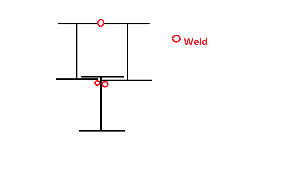

S12x35....30' long but he has 7 of them. I dont normally like S-type beams for long spans as they are too narrow and easier to twist or deflect in the horizontal direction with a single beam span and no flooring or nothing tying in multiple beams. But I have a crazy idea about attaching 3 of them together. Look at the picture for a cross-section:
Being two wide would solve the problem of S-type beams being weak in that direction. The bottom beam to gain depth would "probably" get the strength I need, but cannot find any formulas for stacking beams. The bottom beam would actually be about 1' shorter on each end, as the top two beams would extend and set on the "truck" that is riding on the rail.
My gut says this would be a sufficient setup, as overall depth would be 24" and plenty heavy. But the best part is this would cost me under $500 , and I could set them in place a beam at a time
Thoughts, Opinions, Am I crazy?

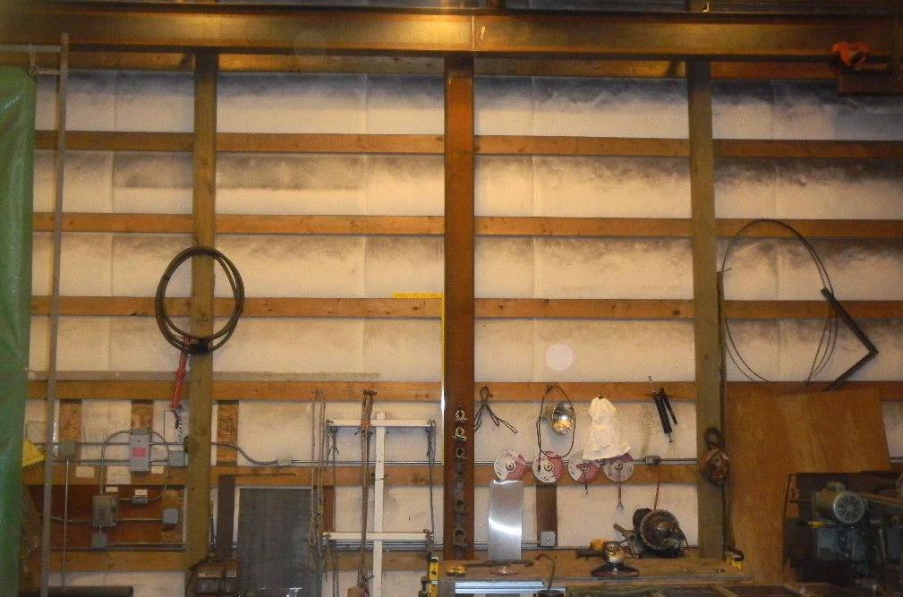

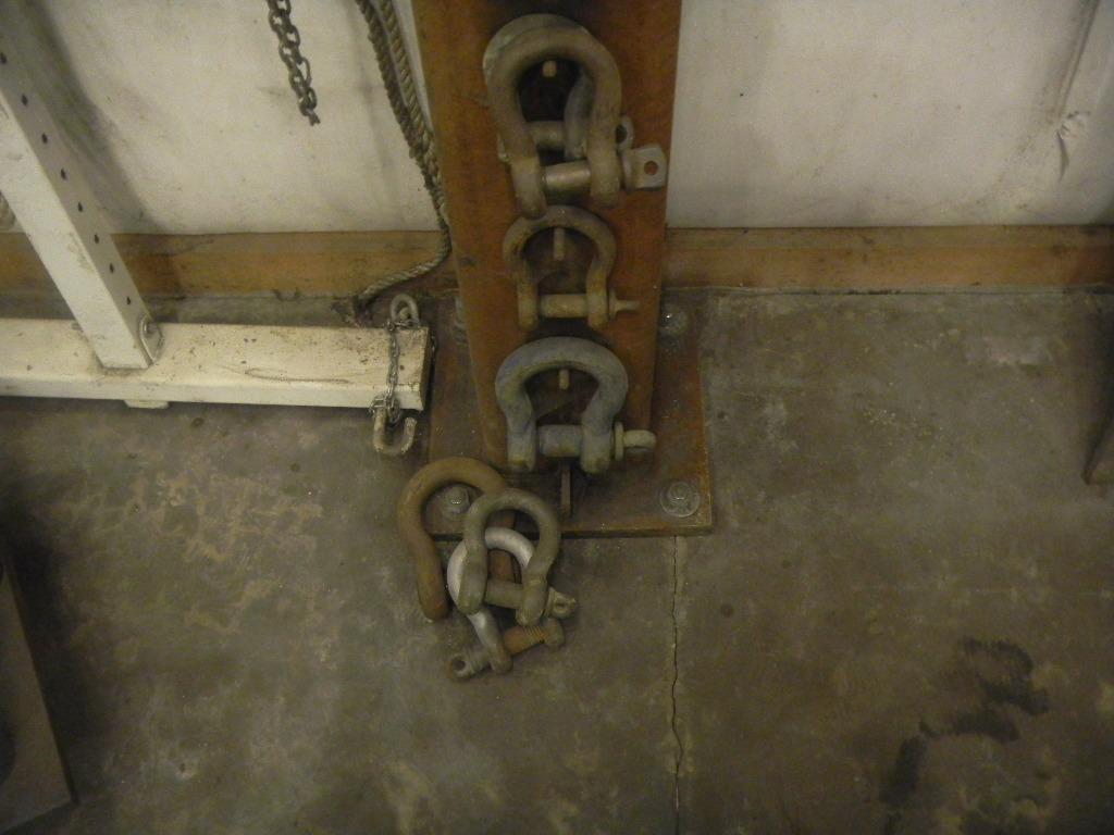

Shield Arc. What is supporting the ends of your side beams? From the picture they're just hanging in the air. I'm sure it's the picture angle.
farmer2009 I gave you bad information!:eek: The center posts are 8" x 8" x 1/2" wall square tubing. You know how many times a day I walk right by those posts? And forgot what size they are.:eek:
