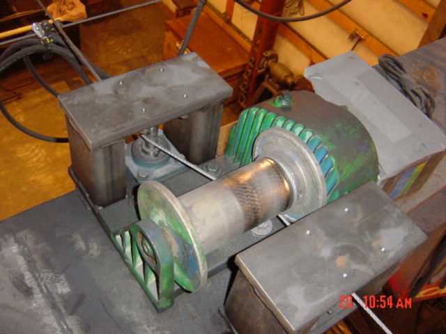

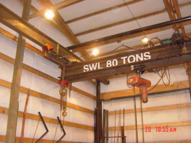

One of the best things I did to my crane was to install a winch on top of the span beam for power travel. :cool2:

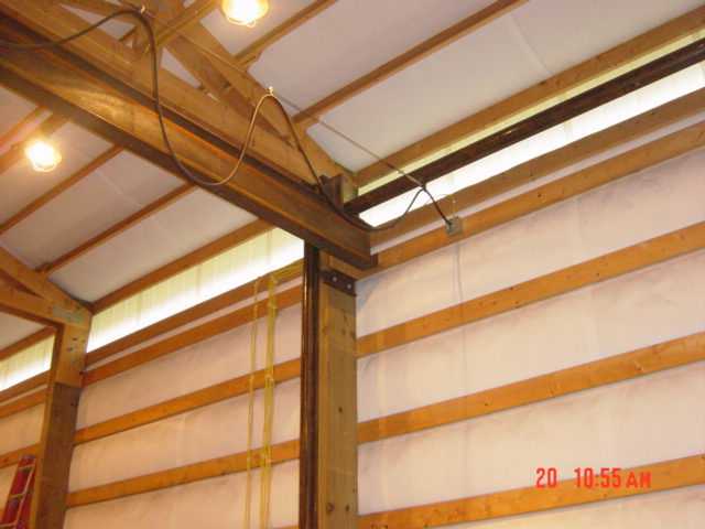

Shield Arc. What is supporting the ends of your side beams? From the picture they're just hanging in the air. I'm sure it's the picture angle.
   / Bridge Crane designs and ideas...38' span #50
At the ends of the rails, (40-feet long) I have 4-inch schedule 80 pipe. In the center of the rails I have 6" x 6" x 1/2" wall square tubbing. I got the majority of the iron to build the crane for free.:cool:
