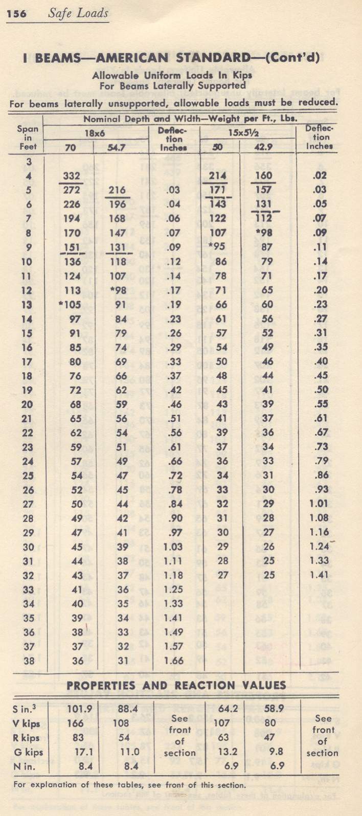

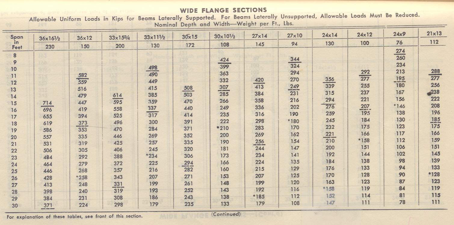

As far as the calculations, Deflection is a NON-issue with any of the beams I listed in the first post. With the 5:1 safety allowing no more than 7200psi stress, deflection on any of them is under 1/2". It takes dropping all the way down to a 14" beam with only a 3:1 safety factor before I even get to 1" deflection.
So I guess by design, the 5:1 safety factor does limit the deflection right there. Example: a light W12x26 beam under static conditions, failure point of 36ksi is 10,500#. But 3.4" deflection. So yes, deflection is a factor, but not using a 5:1SF.

A w27X114 is a massive beam. I don't think LD needs something that massive. His beam calc already come out with less than 1" of deflection with a 5:1 safety factor.

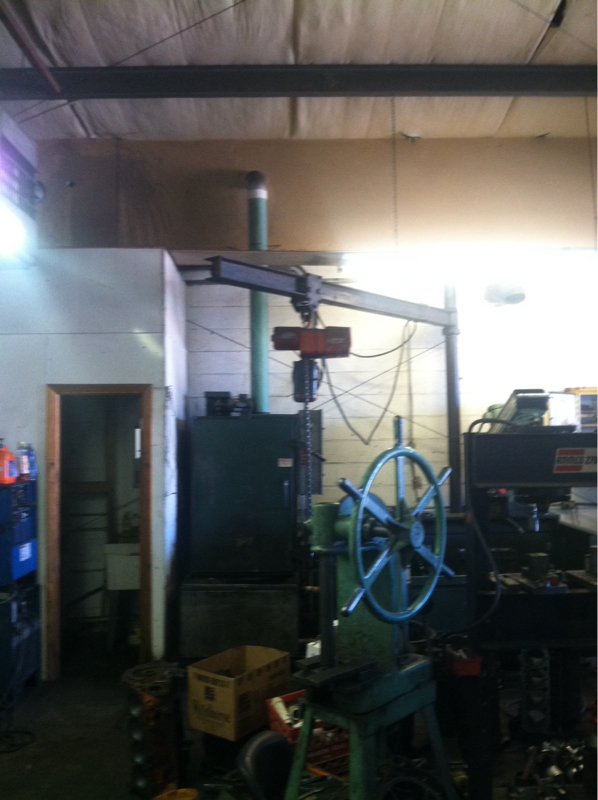

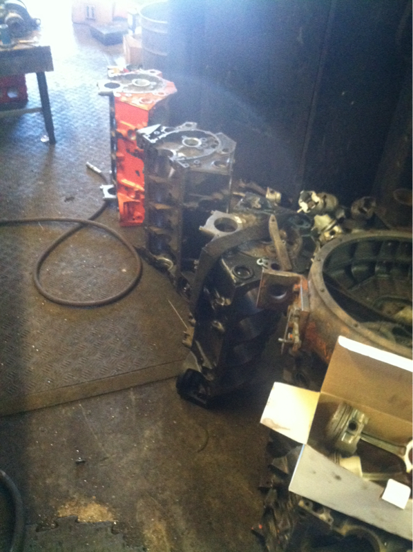

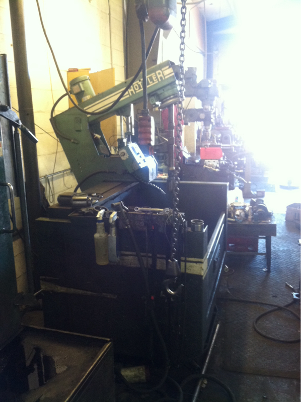

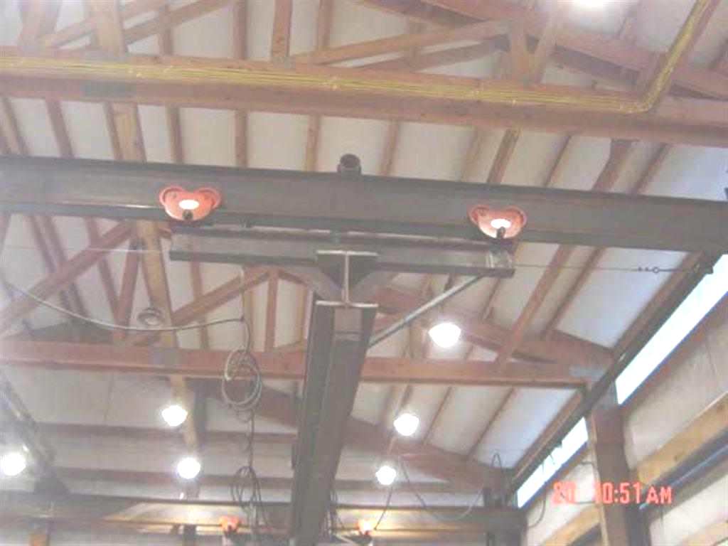

Here is my shop crane. It is actually a 1 ton and not a 1/2 ton like I said earlier. Its primary purpose is lifting engine blocks into the parts washer and honing machine. The parts washer is more like an industrial duty "dish washer" and not the type most of you probably have. The hoist can also reach the milling machine if such a need arises. We used it once to lift a large dozer head up to the mill to drill out broken exhaust manifold bolts. image-366113425.jpg image-2616825932.jpg image-1518281134.jpg

I ran into the same situation when I built my bridge crane. I designed it, but a PE friend of mine picked the sizes of the shapes.
With only a 24-feet span, an S-Shape was going to be too tall. The PE had me use a Wide Flange, rip an S-shape, and skip weld it to the bottom flange of the Wide Flange. I used a 12" x 87# Wide Flange. For 1-ton capacity.

W27x114 for a 30' clear span and 10k hanging from it..................
That amounts to 3ksi stress and 0.079" deflection. So ~12:1 safety factor.
They even use that same beam on the 25' spans, which is over 14:1 safety, and 0.04" deflection.
Would have no issues at all pushing 15t on "their" 5 ton rated beam. Would only just slightly exceed a 5:1 safety. (like 4.8:1), and deflection just slightly more than 1/8" over 25'.

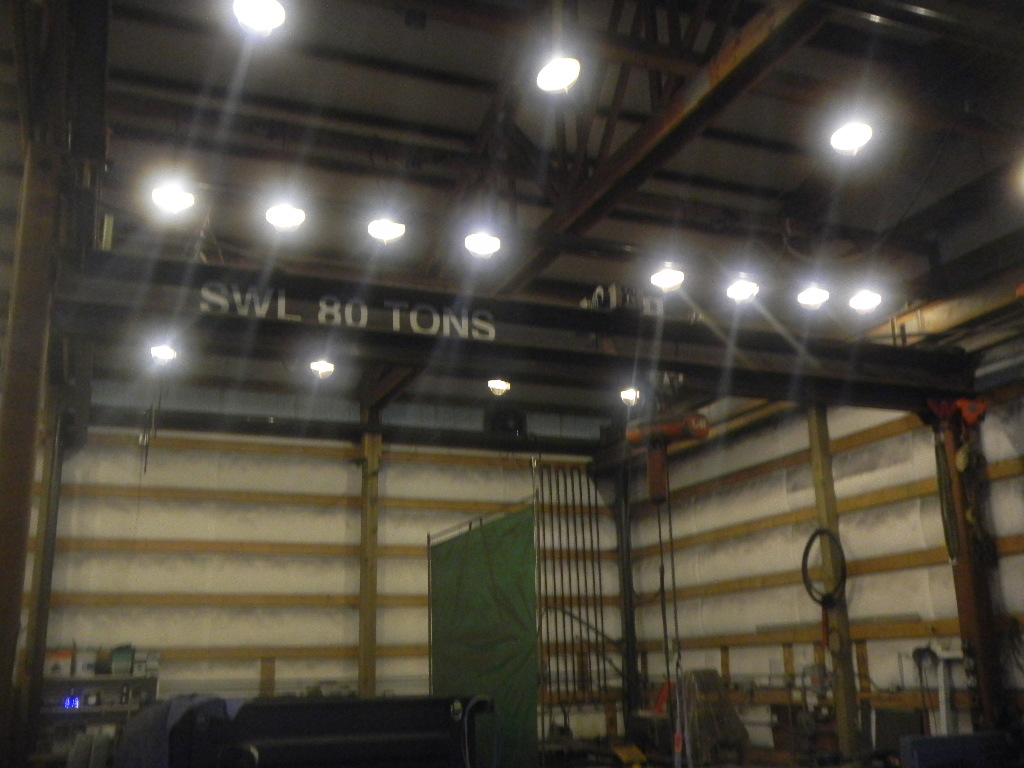

Have any of you guys seen the duel 300 ton cranes inside of Hoover dam? They probably span 200 feet and run the length of the 600 foot long room.
