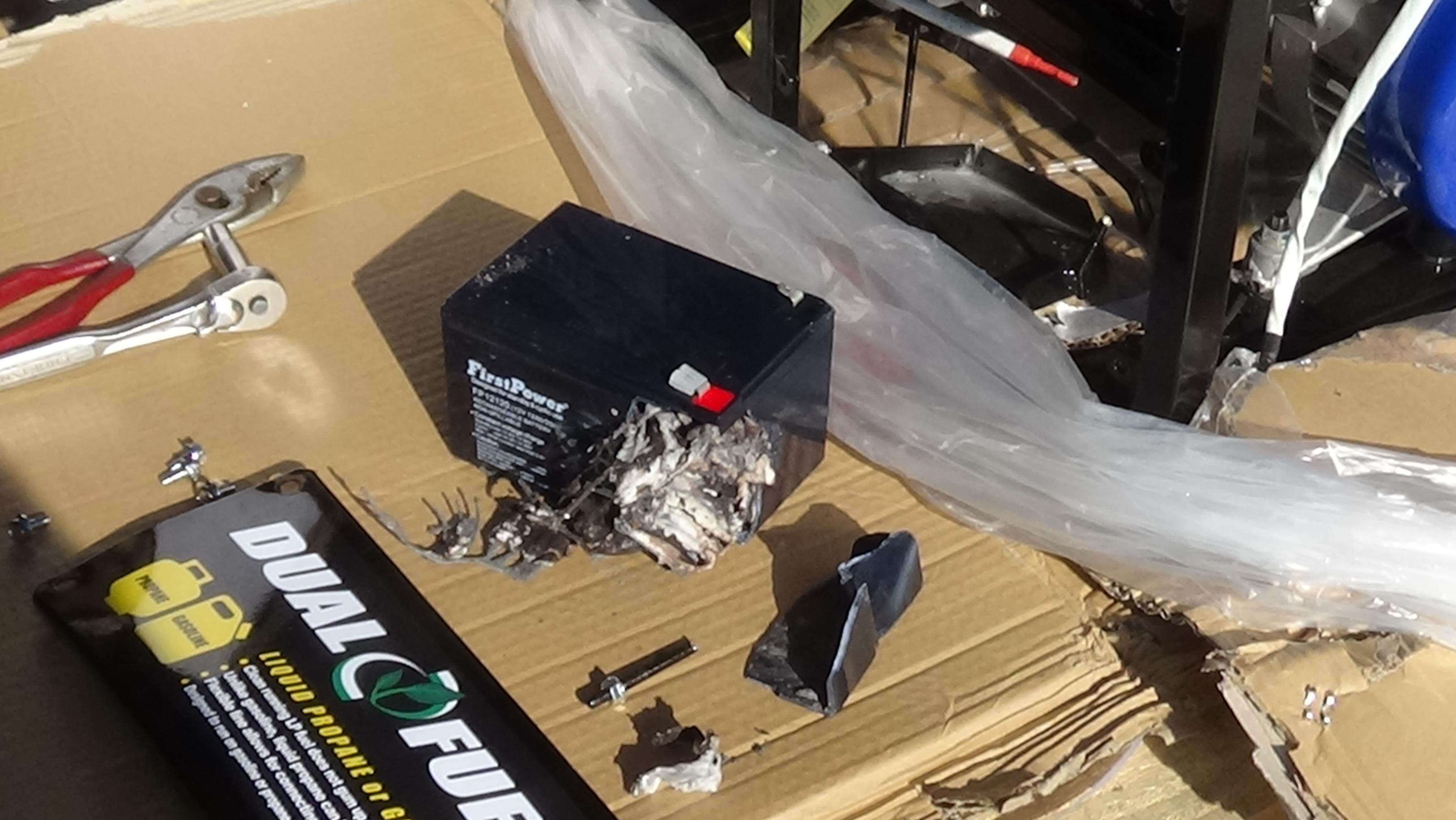

Mine was shipped pretty fast and when I got it a forklift fork had gone through the box and stabbed the battery.
I figured me replacing the battery was easier than shipping back so I called them and they sent me a battery very fast!
S--- Happens but they were quick to respond. I'm happy with it.
