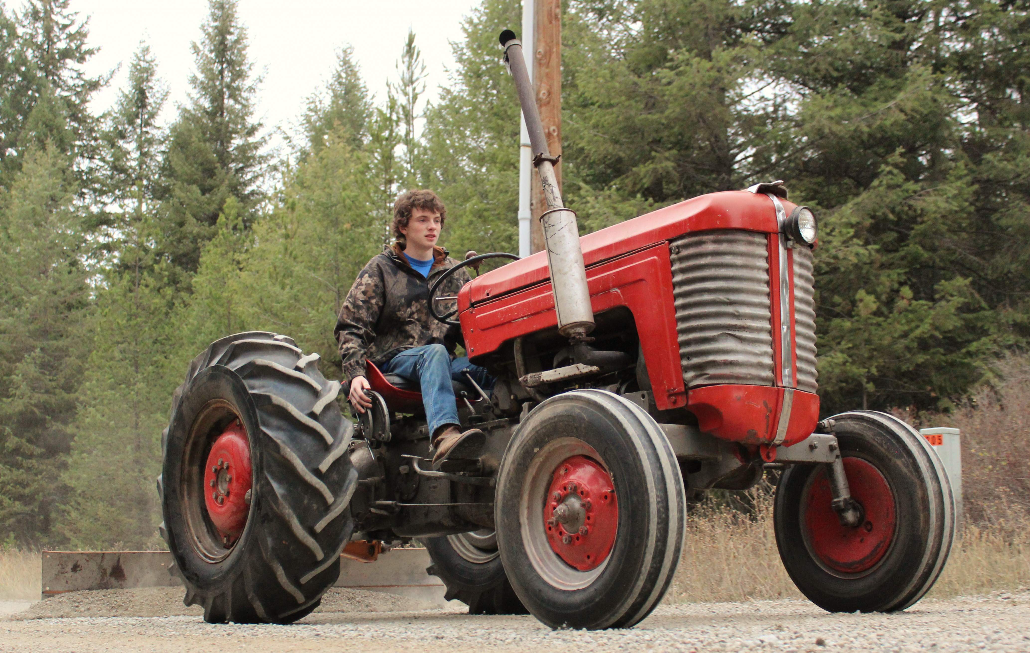

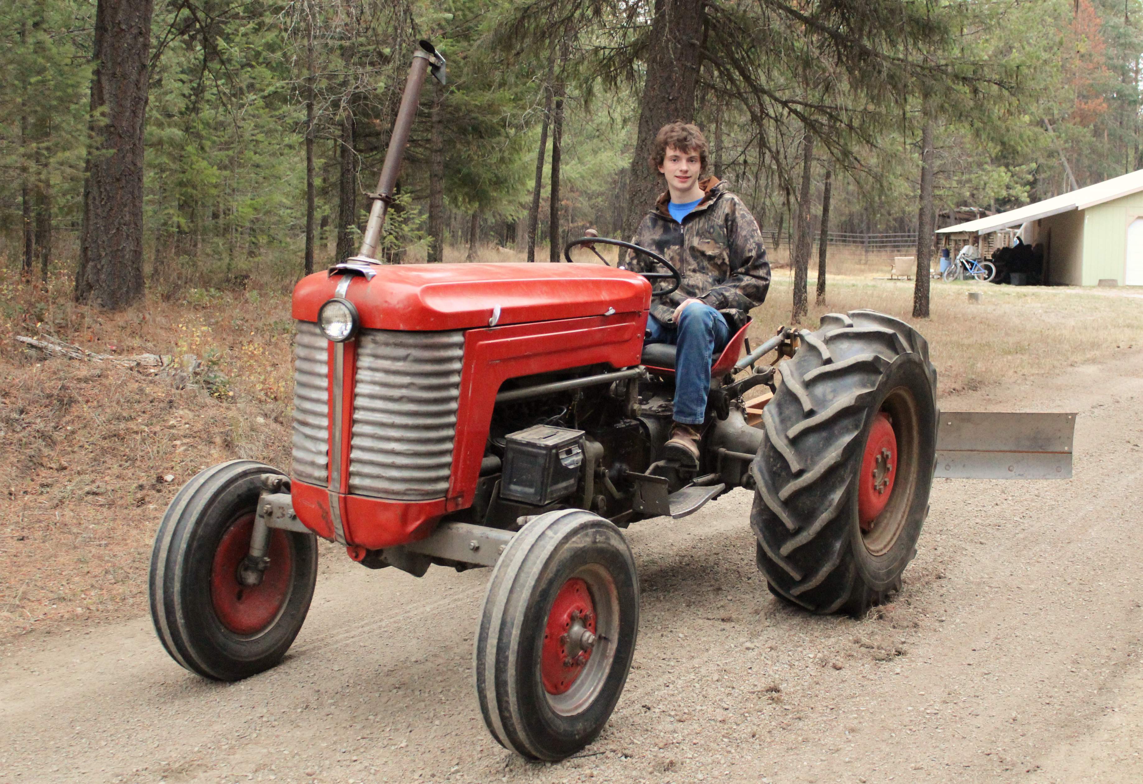

Hello all,
I am new to this forum and joined to hopefully get a few great tips on being a tractor owner. I was given a '56 Massey Harris 50 by my father. He purchased this tractor in the mid 80s and feels it is time to pass it on. He used it primarily for plowing his steep mile long road to the house. I have been using it over the past week to practice for plowing soon IMG_9922.jpgIMG_9944.jpgIMG_9953.jpg and had a few questions about it and found this forum.
First is....
Where can I find a mount for the front of the tractor for pulling and attachments?
Is there any special maintenance things I need to know.
How to get it started in cold temps? I had trouble today when it was 35' F but it started right up at 50'F.
Attaching a few photos. My 13 year old motor head son is addicted, just like I am! Thanks for reading and hope to hear form some! IMG_0024.jpgIMG_0039.jpg

Since its gas you should have a choke on the carb with a cable to close it for cold starts. If you have a choke cable check to make sure it closes all the way when you pull the cable.
Can't help with front mounts for attachments. You may find some searching on line or may have to make your own. What kind of attachments are you planning to front mount.
/ Suddenly addicted to our MH50! #12
I suspect your starting problem is one of (or a combination of) two things:
1. Make sure you have a good gas supply to the carb, lines are clear, filter (if any) is clean and a good flow.
2. Make sure the choke is working properly. Don't know about your application specifically, but typically on tractors that old, the choke is just a butterfly plate on the air cleaner side of the carb with a rod or cable opening and closing it.

Couple of things to check, make sure your choke is working, use the oil like was suggested, and change your plugs and check the timing. If worst comes to worst hand a light under a cover on it at night or install a block heater. That is a nice looking tractor

I will locate the choke. The fuel sediment bowl assembly and fuel on/off valve have been newly replaced. Once it starts it has power, sounds smooth and throttle response is good. When we are done we do have to shut off fuel and close the fuel sediment bowl assembly or it will drip gas.

Choke knob is under dash on left side and pulls a rod, not a cable. I had an MH 50 40 years ago. Continental 4 cyl gas. Normally started down to zero in a turn or two. Before winter make sure your ignition system is in too shape, too.
Sounds like a fuel-to-carb problem, or float in carb is set too low and running past. A block heater will help too.
You will like the power. You won't be moving round bales up front unless you get a loader. I'd recommend a 3-point hitch bale spear. That tractor was designed before loaders were so popular. With tire chains that rig will push a lot of snow. Nice to see the old girl.

Thank you! We did locate the choke, she started right up yesterday morning when it was 34'F with a slight adjustment of the choke. Good idea on the three point hitch bale spear. My father never removed the chains and they are wearing thin. We removed them and will replace when snow flies. She is a gem. I feel honored to have this Massey!
