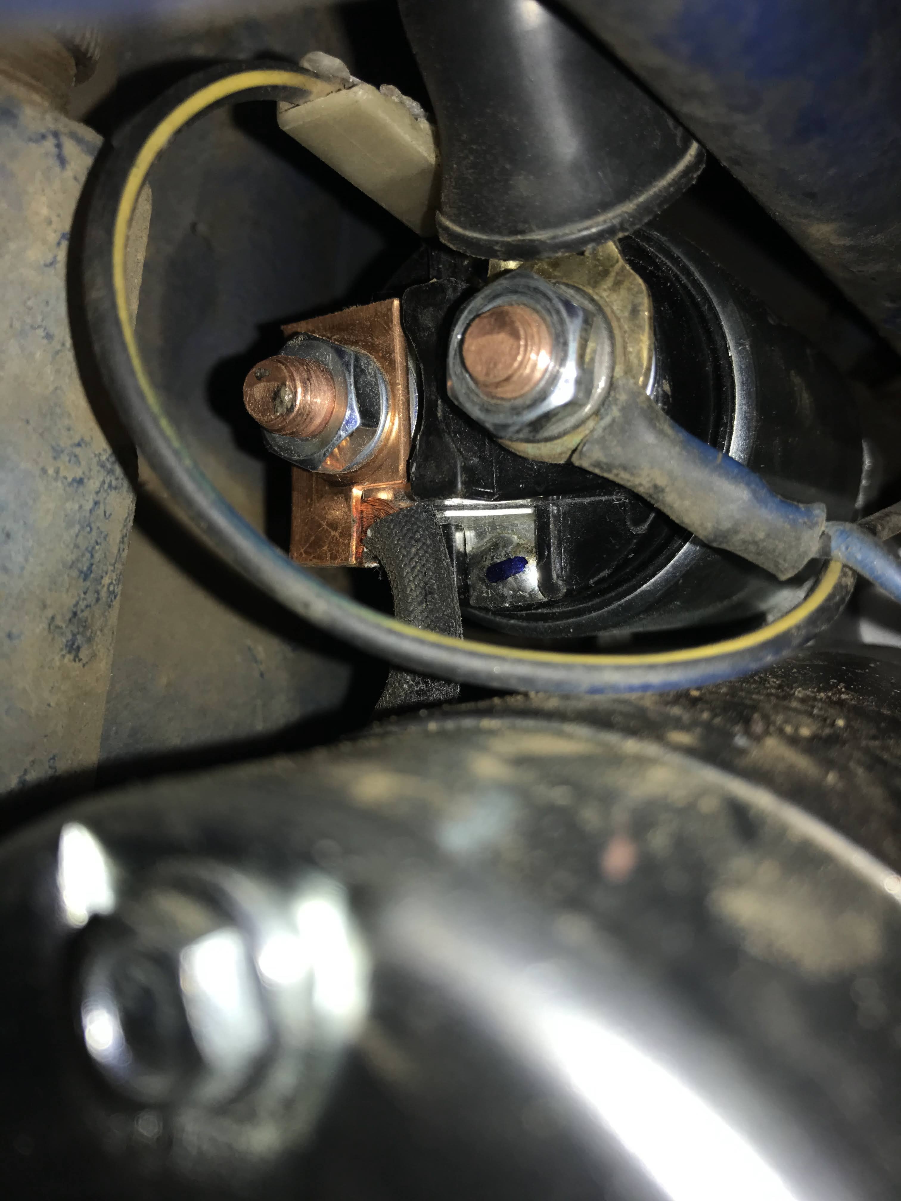

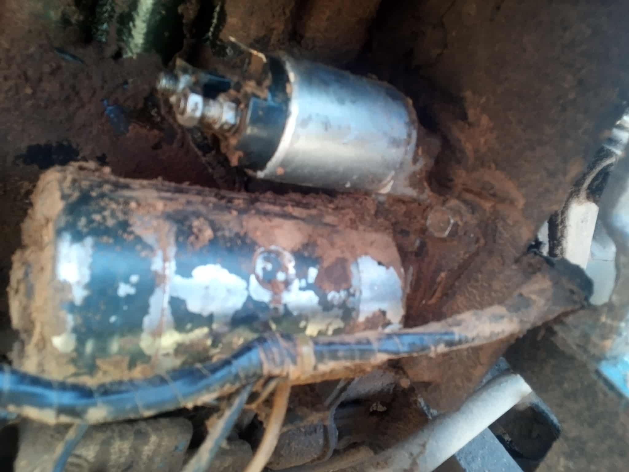

My little blue tractor has had a quirk with her starter for a few years.
This time, I think it is toast. Light, click ... dead. Then no light, no click ... Paperweight.
I tried to take the solenoid off, to start with the most obvious (already did battery clamps) but it seems attached to the starter ... maybe????

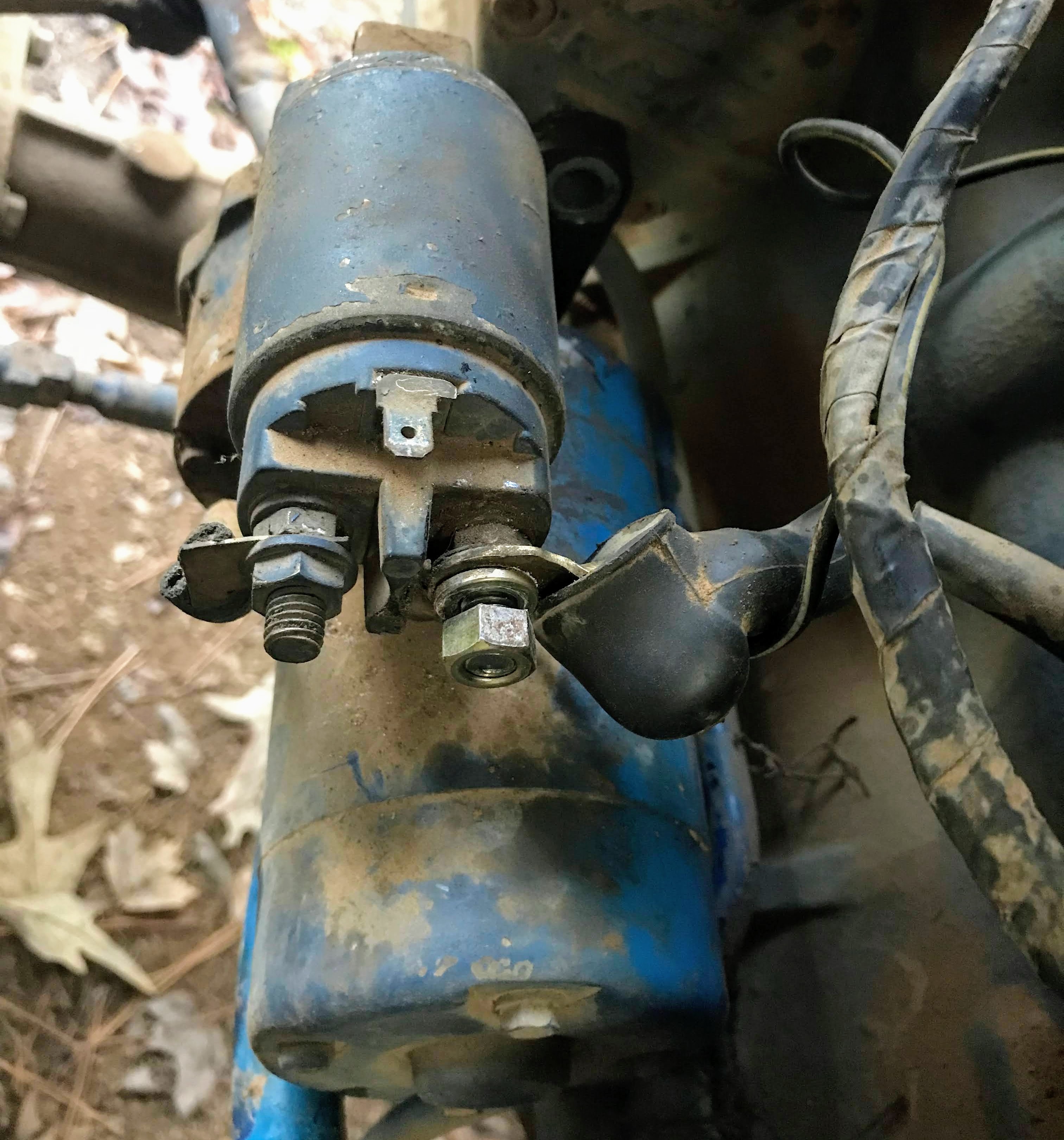

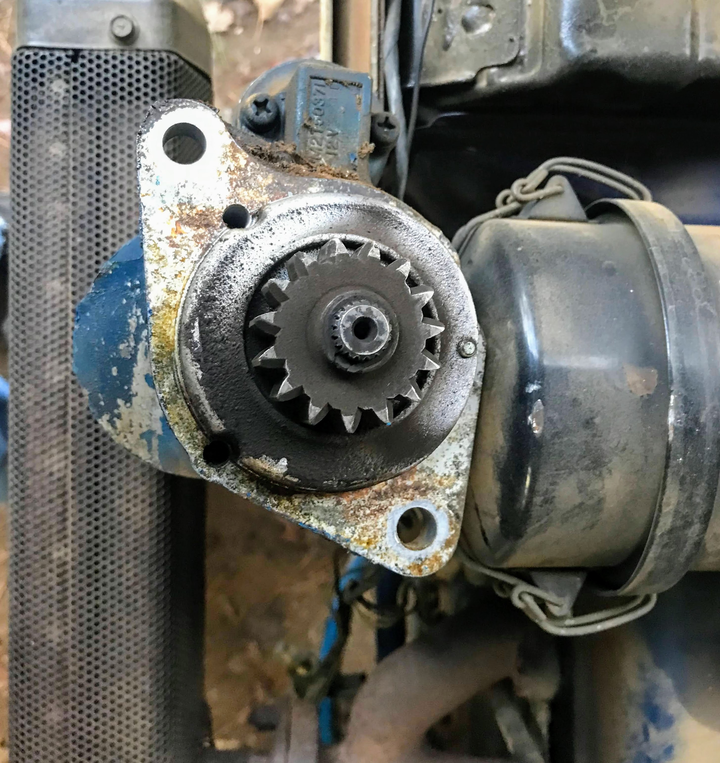

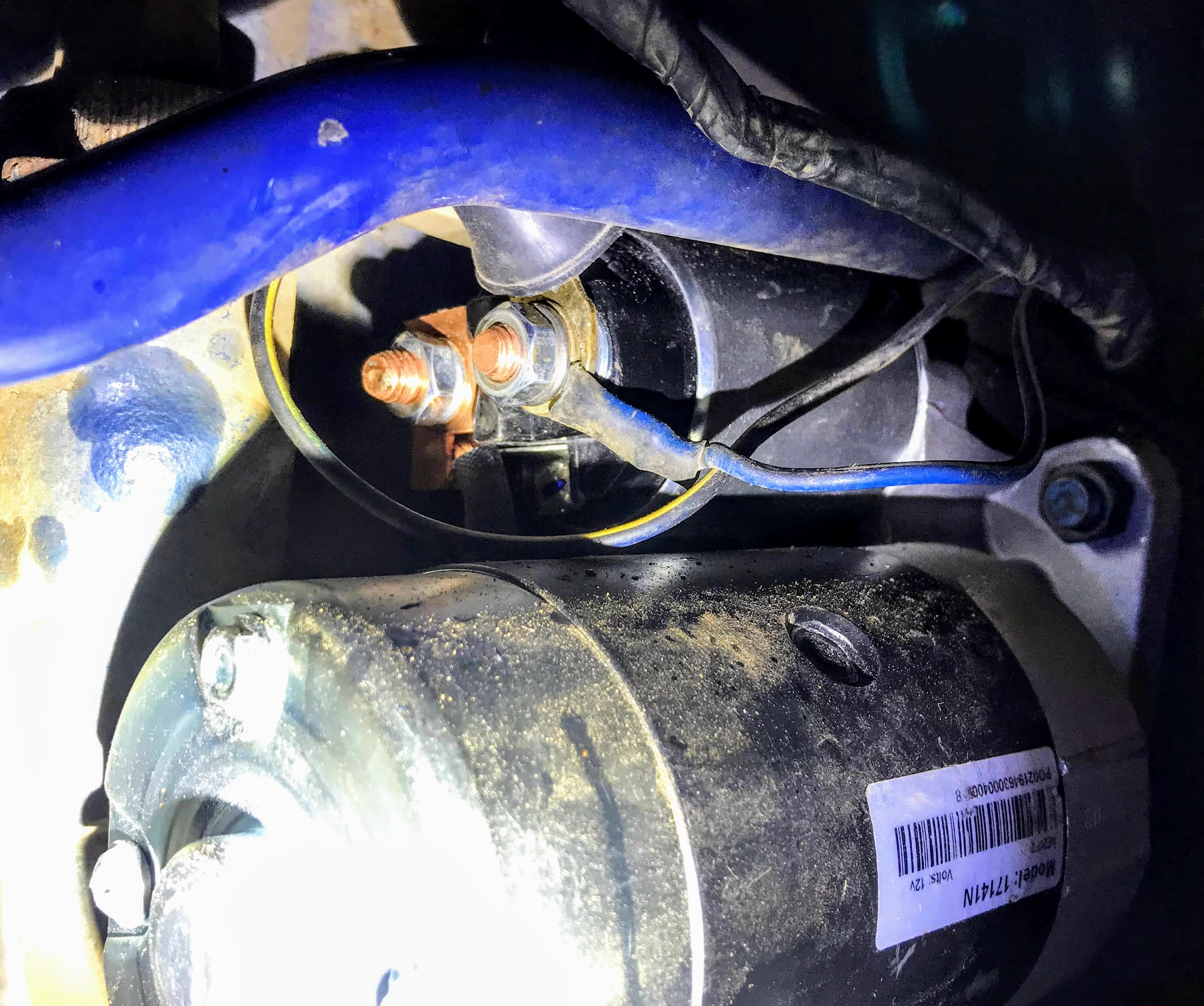

My S373 had similar issues so I replaced it.

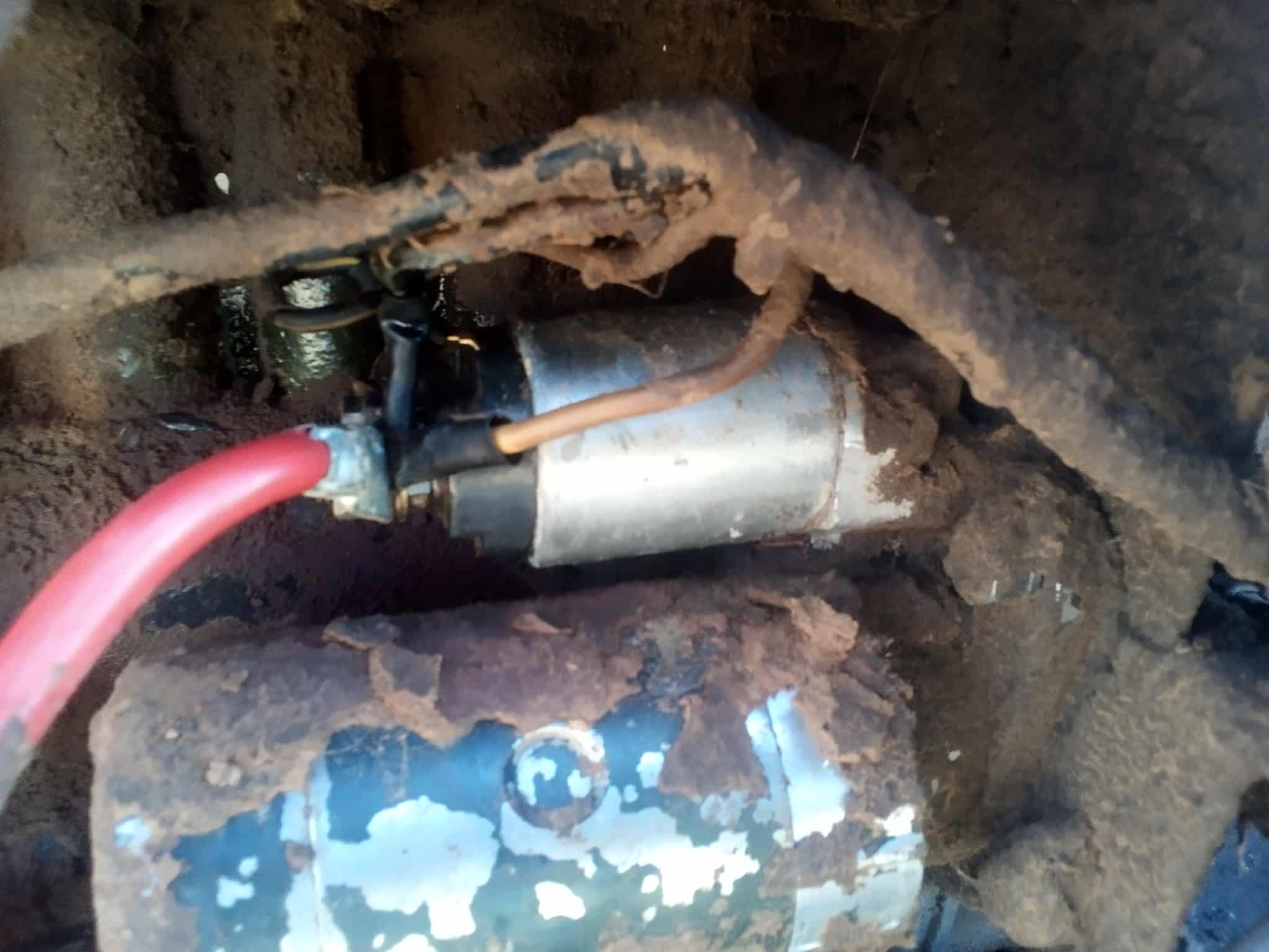

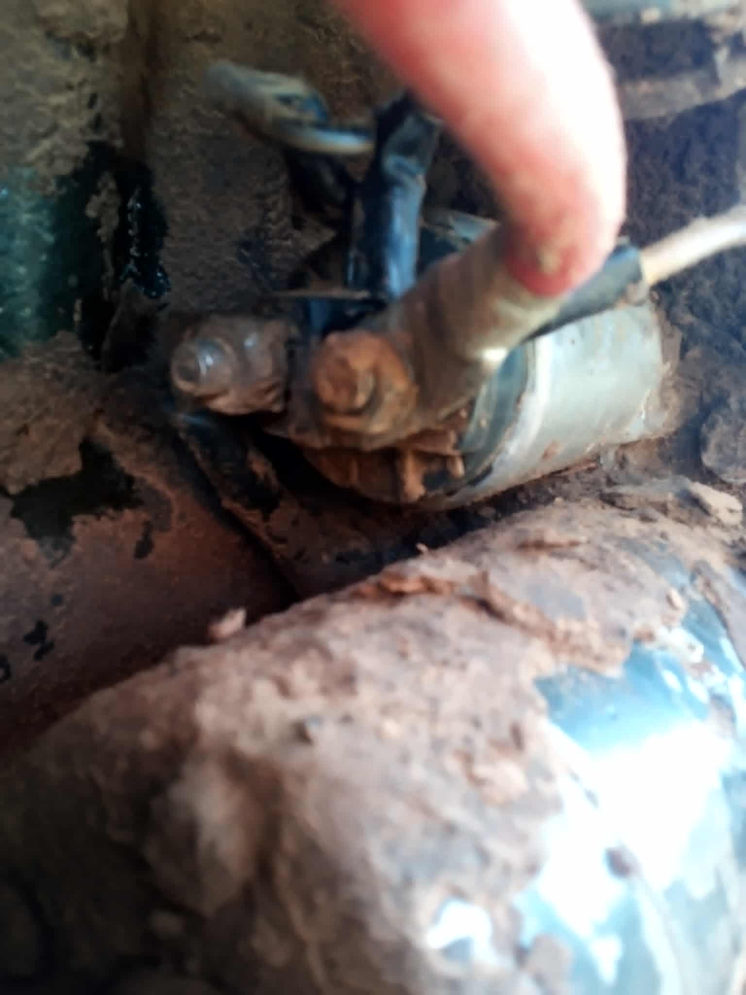

This is the plan ... I just do not know if I am over my head
Of course, the F/E Loader arms are down so the access is more limited.
Is it all one piece????

It's pretty dirty but it appears a couple bolts hold the solenoid to the starter. I could be mistaken but if you can remove the retaining bolts and pull it off it obviously was not one piece. It may be a standard part you could obtain through NAPA. If not you could probably easily adapt a Ford solenoid or something similar to do the job, after deciding where to mount it.
/ MT2001FD Solenoid ... andstarter??? #5
A good test for this would be, (after making sure it's in neutral and wheels chocked) is to take a jumper wire from the battery cable post on the solenoid to the tab that the ignition switch connects to. If it just clicks or does nothing, that indicates the solenoid is crudded up. Quickly short the two big lugs with a screwdriver or other tool, see if the starter spins the engine as normal. If it doesn't, the starter itself is probably bad; if it does, that means the solenoid. It looks like that solenoid comes apart; they can be cleaned up with a wire wheel and if the square head copper bolts are eroded where the plunger disc contacts them, they can be carefully tapped out and rotated so the new part faces in.

... and he did come out and had Mitzie running in less than an hour!!
It actually was one piece!! You could disassemble, but it is sold as one unit.
AllAg had it ($178) and it went on in less than 30 mins. The far bolt was the dickens to get at!!!
Started right up!! :)
