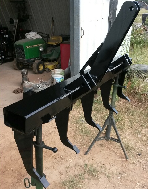

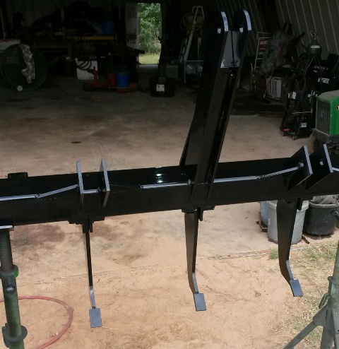

The shanks are removable, so I'm sure when he needs to, he can have any number he needs for the application. I think his JD 5520 is about 90hp, which should pull pretty good in his soil.
It will make her grunt when I hit those spots of red clay. The removable shanks are a plus
/ Subsoiler build #22
I'm betting the tool is a bit under built. More of a heavy duty cultivator than a subsoiler. Think of the power needed to pull even one tine through heavy ground.
Deep subsoilers are usually limited to a single tine for many reasons.
But the nice thing about being a pessimist, is that one is left open to be pleasantly surprised! ;-)
Nice looking fabrication!
I agree. The OP has built a nice field cultivator.
A proper subsoiler looks like these:

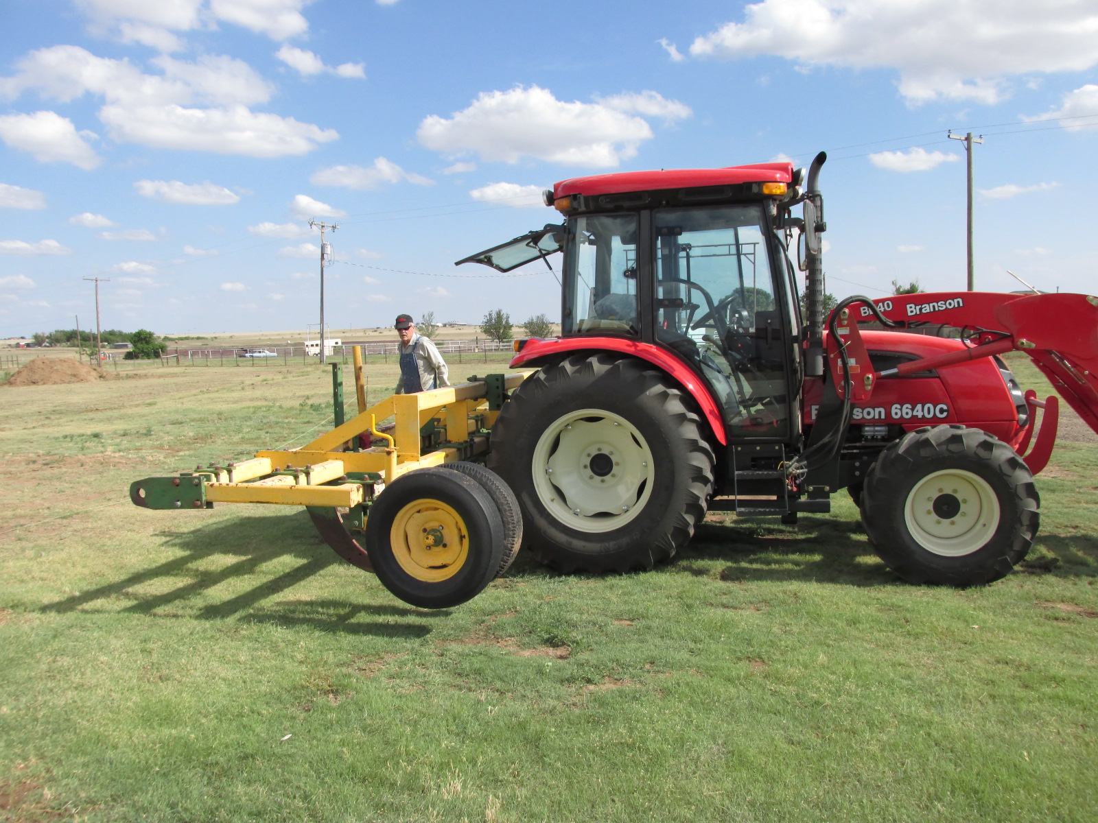

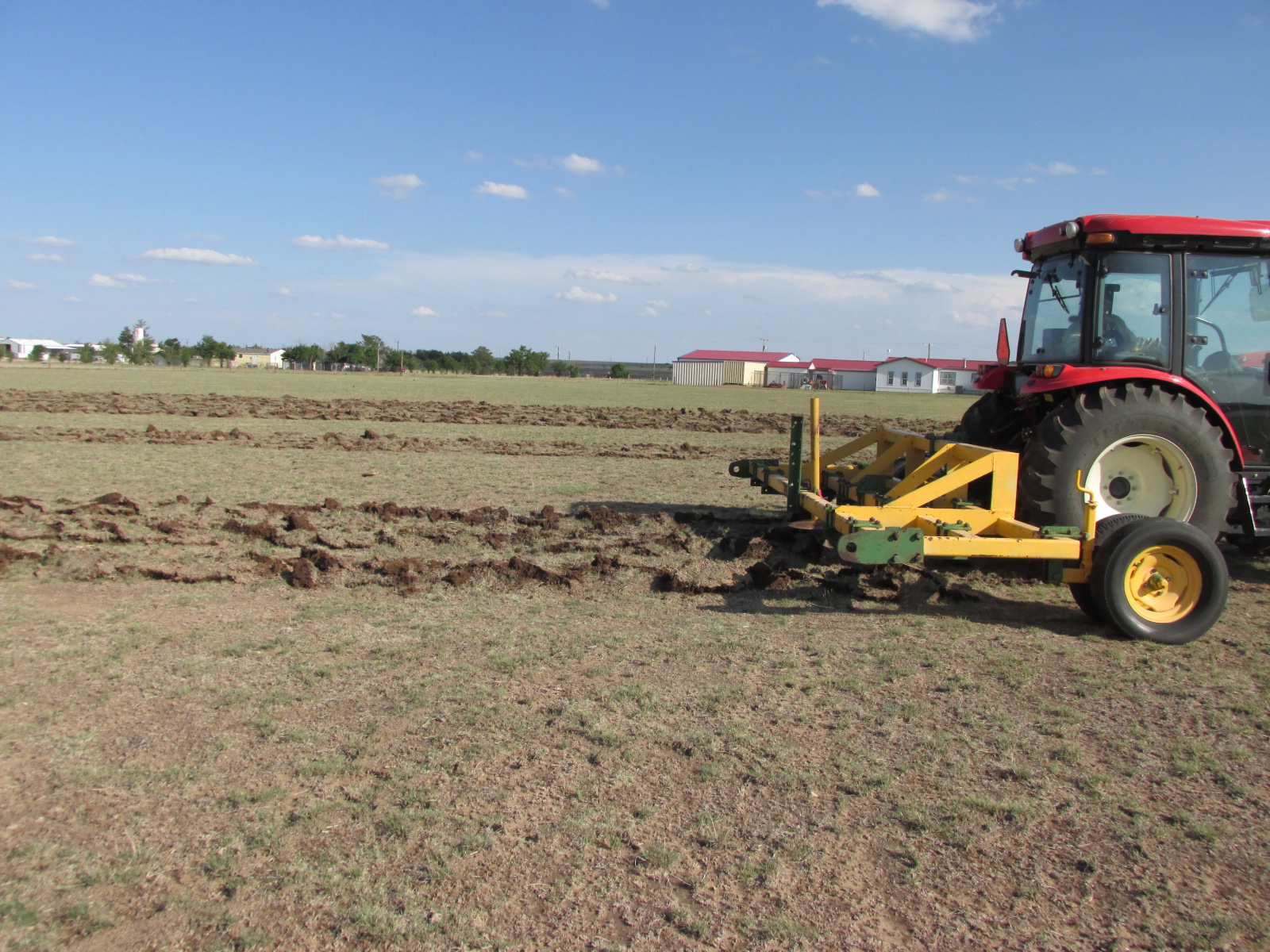

Hooking up my subsoiler..
Sub soiling my pasture
018.JPGATTACH=CONFIG]440498[/ATTACH]
/ Subsoiler build #33
It is interesting what different areas of the country have for soil. I can find 6 inches of sandy loam across the street in the unclaimed property I mow. I have a small area of that sandy loam in my property. The rest washed away before I got it. I made a 3 shank subsoiler and my tractor will stop when I am in clay. Most of my little 9.3 acres is red clay with a hint of topsoil. Even a single shank will bog out the tractor. OK, my tractor might weigh 3,500 pounds and has short 11.2x24 tires which means it has limited pulling abilities. My uncles, who are farmers say that the taller tires give you more pulling ability.
Anyhow, whenever the farmer across the street or the neighbor down the road pull a plow or disk, they pull up rocks. The neighbor probably learned his lesson as that is a lot of work to clean up a pasture after turning up rocks. One of my hay farmers 30 miles away sold his Pasture King airator because it pulled up to many rocks. I do not see any rocks in the family farm fields up in eastern Indiana.

Looks great! I built myself one a few years ago. Made the shanks too long and had to cut them down some. 36" down would stop our 190XT.
