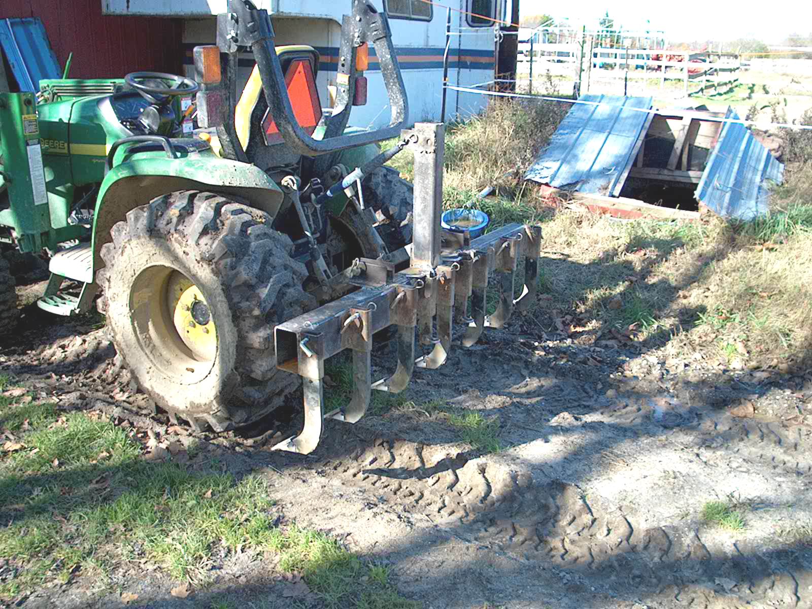

something I made

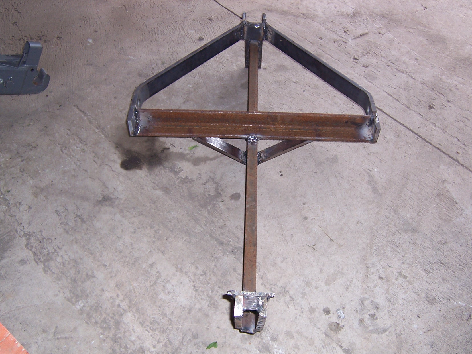

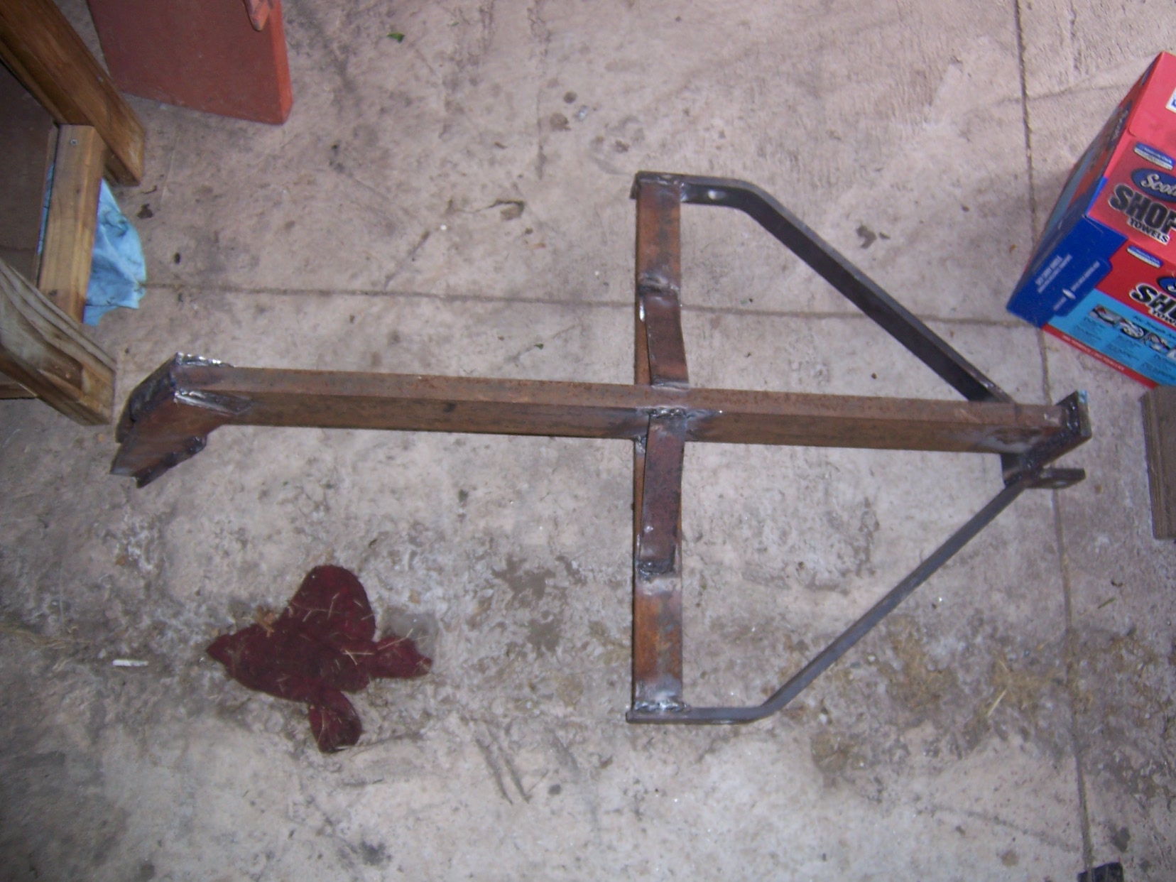

Here is a picture of the sub-soiler I built. I used `1" x 4" steel for the main shaft. No shear bolt, but I don't have big stones. Not pretty, but works great.

something I made
Your tine arrangement :) looks extremely effective but I need something deeper. My rototiller will get to about 8 inches. Beneath that it's hardpan. I'd like to get another 10 inches if not a little more.
Hi:
What are the thicknesses of the material you used?
Jon

you could start with the arrangement I have and have a couple shanks with extensions welded to them, they are standard scarifier shanks like you'd find in a box blade
as is I can get about 12" or so deep

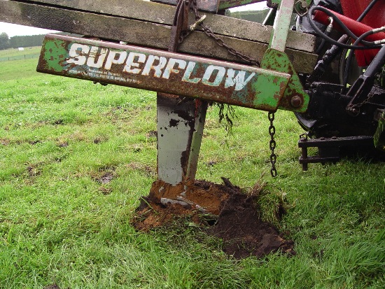

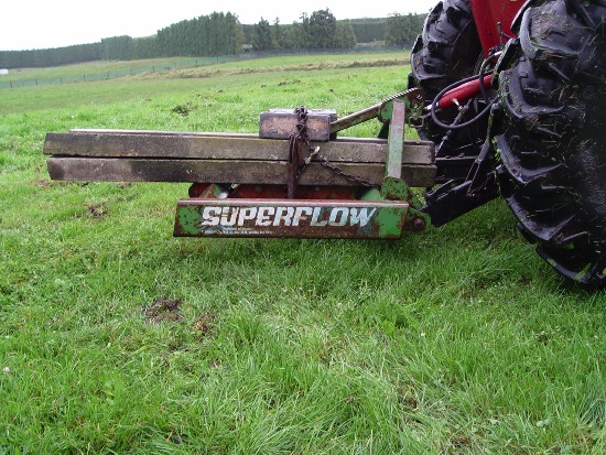

I've got a single leg ripper that goes to about 18" and I pull that with a 65 HP Case-IH 3230 4WD and it has it's work cut out. It's got a reasonably large foot and leaves a hole that I can put half a forearm into. Maybe 3.5" diameter. I have to add ballast to the ripper frame to get it down to full depth. After 2-3 hours, the hydraulics get too hot to be able to lift it out again, so there's a good amount of work being done, ripping at that depth.

Years ago dad decided that we needed to sub soil our fields. It was unbelievable to me how much power it took to drag 3 shanks about 24" deep. It did seem to help some with crop yield. It also helped with drainage. I think that things did best where we could go deep. We were always fixing,welding, and adding more weight. I would only go with 1 shank and make it strong.
