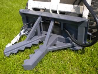

I have a 100+ small pine trees (2-4" diameter) I want to remove, some around my pond are not conducive to pulling out with a longer chain.
With that many trees I would rent a skid steer with a tree puller.
Pictures from Google Image Search
I have a long arm tree puller on my V417, so much faster than using a chain!
The view from the seat.
Link to pulling the big cedar: http://www.tractorbynet.com/forums/attachments/277824-tree-puller.html#post3444397
