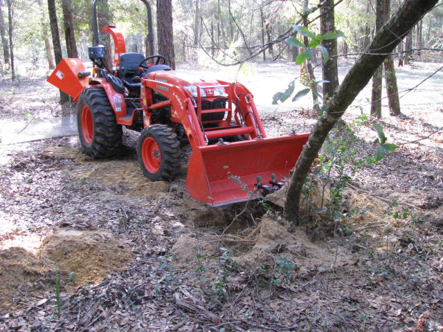

If it were me, I wouldn't use the method that you described. Does your tractor have a Drawbar? You will be surprised at the root systems of even small trees. If you have a FEL, dig around the trees and pull with a chain or strap. How tall are the pines, what is the slope around your pond and exactly why are the trees not conductive by utilizing a short chain and not a longer chain? Pulling with the Drawbar is much safer, at least IMHO. Best wishes.
/ Stump Pulling with 3-Point - Any concerns? #6
I can do 3 inch trees reliably with my 30 hp machine and a chain. 4 inches I often have to wiggle a bit. 5 and up require digging.
Thanks for the replies, I have removed several trees using the both the drawbar and FEL. I stopped trying the FEL as it seems to cause to much wear and tear on the tractor due to "racking" caused by anything but a square lift attempt. The hook and pull method using the draw-bar works great as long as you have good access to the tree stump. This also prevents the tree branches from whacking you in the head :). None of these trees are over 12' tall and not a safety concern, think large xmas trees. The stumps currently giving me issue are on the side of the pond bank and I would prefer a controlled extraction by lifting up as I do not have clear access for the typical draw-bar approach. I guess my basic question is can I damage my 3-pt if I exceed the 2200lbs lift rating or by repetitive lifting?

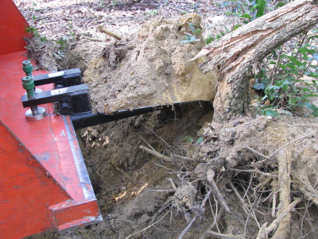

if you have a set of pallet forks, they make great little diggers.
you could go around to the trees and stick the forks down under the
stump a bit to start loosening them, and see if you can get anything
to move with them first. once you get them a little loose i bet they'd pull
right out with the chain.
