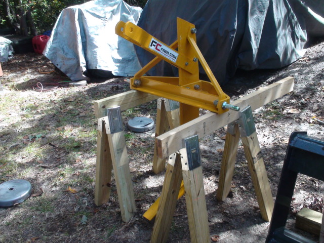

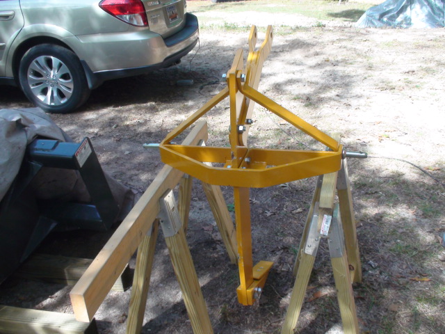

I am going to try and run around the stump/tree with my subsoiler first to cut any roots I can before digging with the stump bucket and see how this works. I will not be able to get as close initially, but it is a relatively easy thing to do first. Then go to work with the CID stump bucket as required.

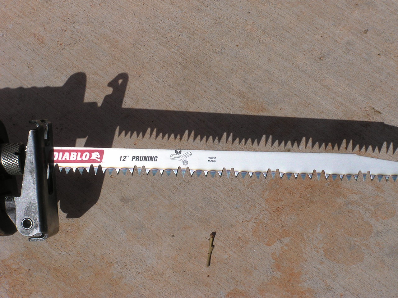

I hope you folks have better luck on roots with the sub-soiler than I did. Yes you can twist-off a rock shaft and have to replace it. (Don't ask me how I know, ok? :ashamed: .. may have been cracked already?)
btw: A 'SawZall' run off a small generator will cut a handful of roots quicker than you can say 'time for a new bar & chain.
IIRC the blades are much cheaper than chains and change out more quickly, too. (YMMV but try before you hammer your Stihl. 6 or 10 tpi works for me to 4" or so. :2cents:)

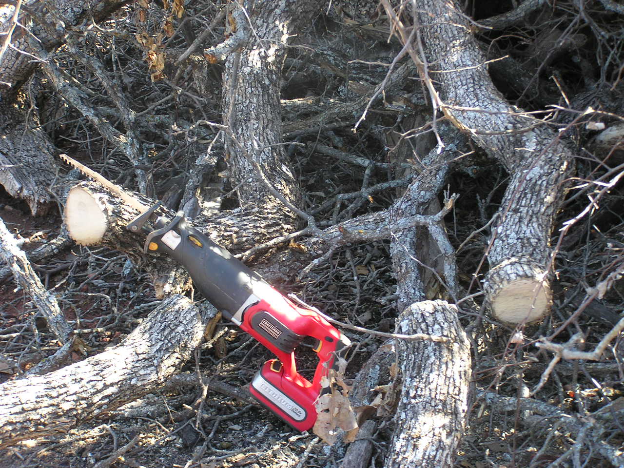

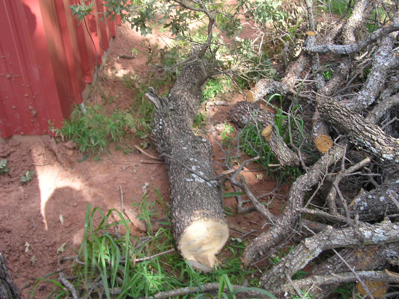

Yep, I use a cordless 'SawZall' with a 9" or 12" pruning blade.
Don't have any pictures of roots, so here is the largest limb, cut with the 12" blade.
It measured 9"
