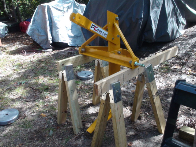

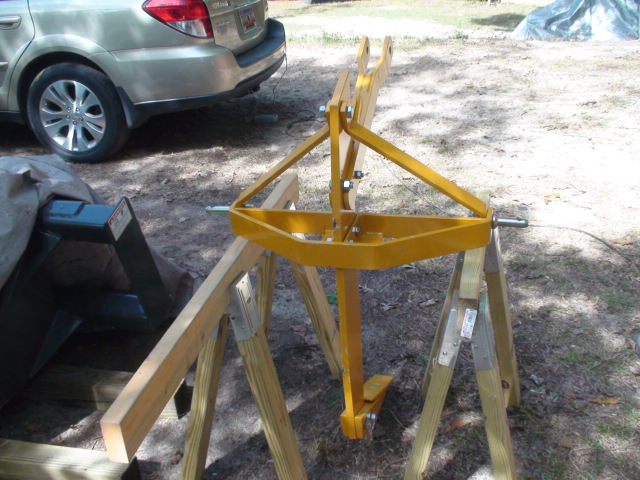

Yep, I use a cordless 'SawZall' with a 9" or 12" pruning blade.
Don't have any pictures of roots, so here is the largest limb, cut with the 12" blade.
It measured 9"
