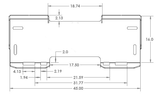

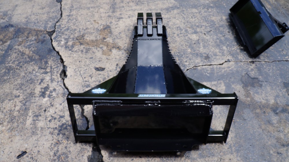

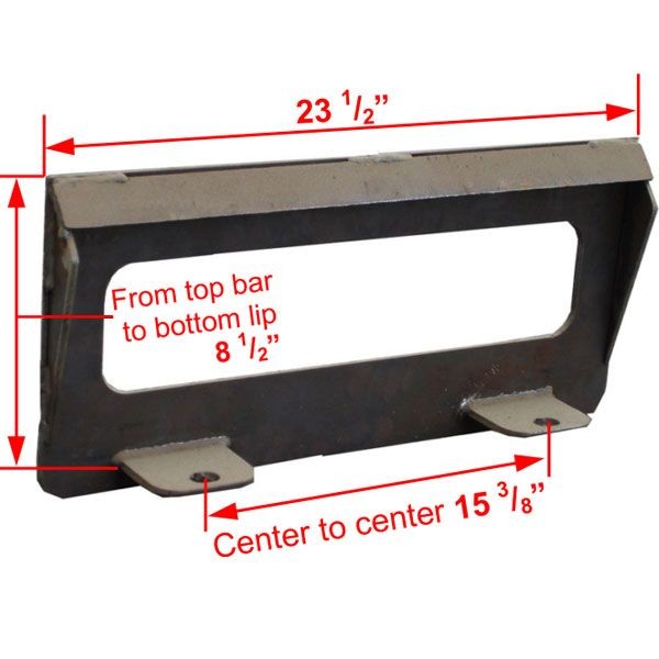

I have a L3400 with a LA463 FEL that i'm in the process of converting over to a SSQA which opens my options. One of the first things I'm thinking of getting is a stump bucket to help with the war on cedars as well as dig a couple trenches we need for drainage.
Given the limited size and capacity of the FEL, I'm thinking I should be looking at 'mini' buckets to help keep the weight in check. I think i have it limited down to either a Spartan or a Blue Diamond mini bucket. -----------------------------------------------
If you buy a mini stump bucket you will have to convert it to fit your SSQA.
Mini QA dimensions:
SSQA dimensions:

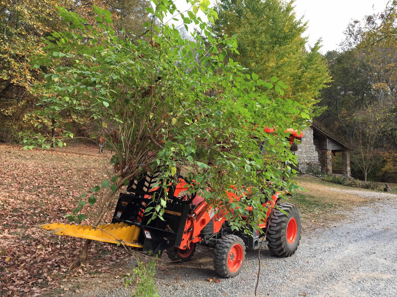

Danuser Intimdator. Dig, rip, grab and go.
Piranha bar works pretty good too. Either one engage about 6” from ground and drive forward pulls the tree out much better than just the loader will lift.
A Danuser intimidator is an amazing puller. I had one on a 95 Kubota CTL and it would pull 6” trees and quickly dig out a lot bigger ones. But that puller weighs like 650 pounds. It’s going to be pretty useless on the OPs small tractor.
   / Stump Bucket Selection - L3400 #17
A Danuser intimidator is an amazingly puller. I had one on a 95 Kubota CTL and would pull 6” trees and quickly dig out a lot bigger ones. But that puller weighs like 650 pounds. It’s going to be pretty useless on the OPs small tractor.
It’s shown on a B26 probably less lift than the OP’s tractor but still vary handy getting to and pulling the small stuff. Cedar saplings/trees are tougher type of vegetation to remove. Being able to dig, break roots and then clamp and drive forward can rip out impressive stuff. Hook to the M59 really impressive.

Thank you all for the suggestions. Sounds like a Piranha is a good place to start. Luckily I had ordered one already last week. I had been stalking the forum for awhile and it seemed that was the go to for a tooth bar.
I'll give that a shot and see how it goes. I think the Danuser might be a tad out of the ol' budget at this moment.
