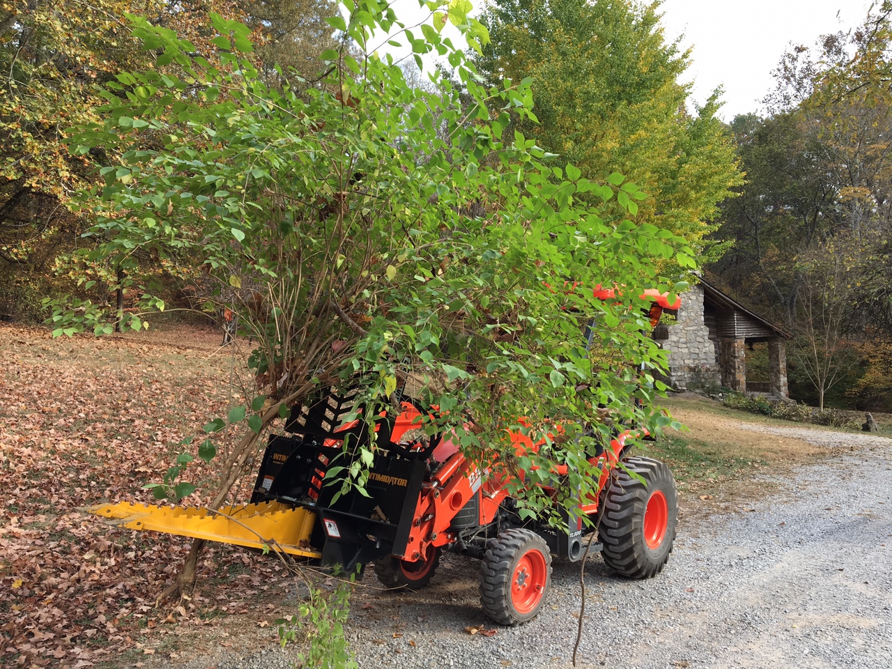

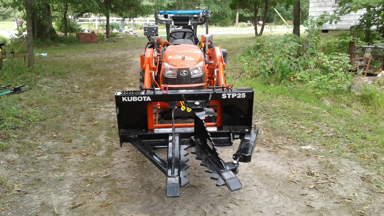

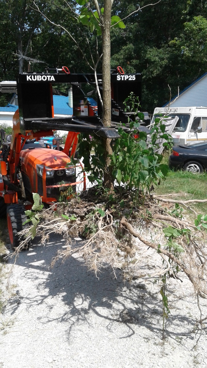

Danuser Intimdator. Dig, rip, grab and go.
Piranha bar works pretty good too. Either one engage about 6” from ground and drive forward pulls the tree out much better than just the loader will lift.

The length of the stump bucket is the key parameter.
L3400 hydraulics are too limited to overcome negative leverage of buckets 36" or 42" long.
Piranha bar works pretty good too. Either one engage about 6 from ground and drive forward pulls the tree out much better than just the loader will lift.
A more practical attachment for removing saplings with a light tractor.
VIDEOS: Piranha Tooth Bar - YouTube

Thank you all for the suggestions. Sounds like a Piranha is a good place to start. Luckily I had ordered one already last week. I had been stalking the forum for awhile and it seemed that was the go to for a tooth bar.
I'll give that a shot and see how it goes. I think the Danuser might be a tad out of the ol' budget at this moment.

What size Are the cedar saplings ? Most could probably be cut with a rotary cutter if they are small. i have hundreds of them on our property as well , the pirahna bar will take out small ones . I can push over and pop out of the ground ones 6 to 8 inch in diameter. but it does leave a hole.

A Danuser intimidator is an amazing puller. I had one on a 95 Kubota CTL and it would pull 6” trees and quickly dig out a lot bigger ones. But that puller weighs like 650 pounds. It’s going to be pretty useless on the OPs small tractor.
/ Stump Bucket Selection - L3400 #17
A Danuser intimidator is an amazingly puller. I had one on a 95 Kubota CTL and would pull 6” trees and quickly dig out a lot bigger ones. But that puller weighs like 650 pounds. It’s going to be pretty useless on the OPs small tractor.
It’s shown on a B26 probably less lift than the OP’s tractor but still vary handy getting to and pulling the small stuff. Cedar saplings/trees are tougher type of vegetation to remove. Being able to dig, break roots and then clamp and drive forward can rip out impressive stuff. Hook to the M59 really impressive.
